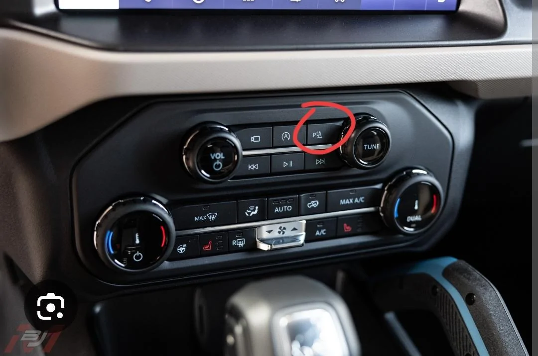

You mentioned shutting them off in the menu, but what about the button? I have to turn mine off on trails or it drives me nuts. It would be annoying needing to hit it every time you get in the car, but it's better than having to actually listen to them while you wait for your service appt.
My dealer here is only one week out for appointments. Just scheduled a service yesterday for oil change/tire rotation, etc, for next week. 5 weeks is too much.
I didn’t even know there was a button to do that. Always went into the menu. Where is it??

By the center controls/HVAC panel where the camera and auto start/stop buttons are. The next one over is the parking sensors. Should be a P and a cone shape.
Edit to add Google photo, circled button.
Got it . Thanks. That works but you have to do it every time you start the vehicle, but at least I don’t have to listen to it now until I take it in.
