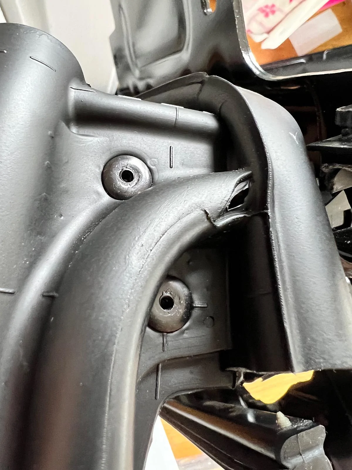

I have a 2022 Bronco Badlands soft top. On the driverside rear window there is a channel that the window slides into/out of when you remove/replace the window.
the plastic part is broken and I can't find the part number to order a new one.
Can someone help me figure this out?

I have the same broken part and ordered the aluminum replacement. anyone know how to remove the old one? Its held in by 2 screws (easy) and two studs. The studs are the painpoint. The new one comes w/ screws instead of the studs.
I had been planning on just drilling them out. Carefully of course with somethihng to protect the truck from damage

I’ll try drilling tomorrow. I have dual tops so it isn’t on the truck yet. The replacement screws go in from underneath, so you may have to remove the top from the truck to get the screws in.

7/64 bit did the trick. Drilled it from the bottom, and a bit of wiggling got it off. Good idea @jtimon.

Do you know how to get the screws/studs off of the broken piece? they have a small round hole that isn’t compatible with any screwdriver. Thanks.
I think you are talking about the points that @SkiSquatch used a 7/64 drill bit to drill out.

Yes, I drilled it out. Very easy. 7/64 or 1/8 will do it.

Ok great thanks - could you explain how you drilled it out? Did you drill the 1/8 drill bit in the “hole” of the rivet? Then what? Did you use a larger drill bit to pull it out or did drilling the hole with the drill bit just break the rivet apart so you could pull it out? Appreciate the help!

Yes, just put the bit on the hole in the center, hold it with some pliers and drill. Then grab a pair of needle nose to work the remaining pieces out. Didn't take much to brake the lip off and remove the other side.
