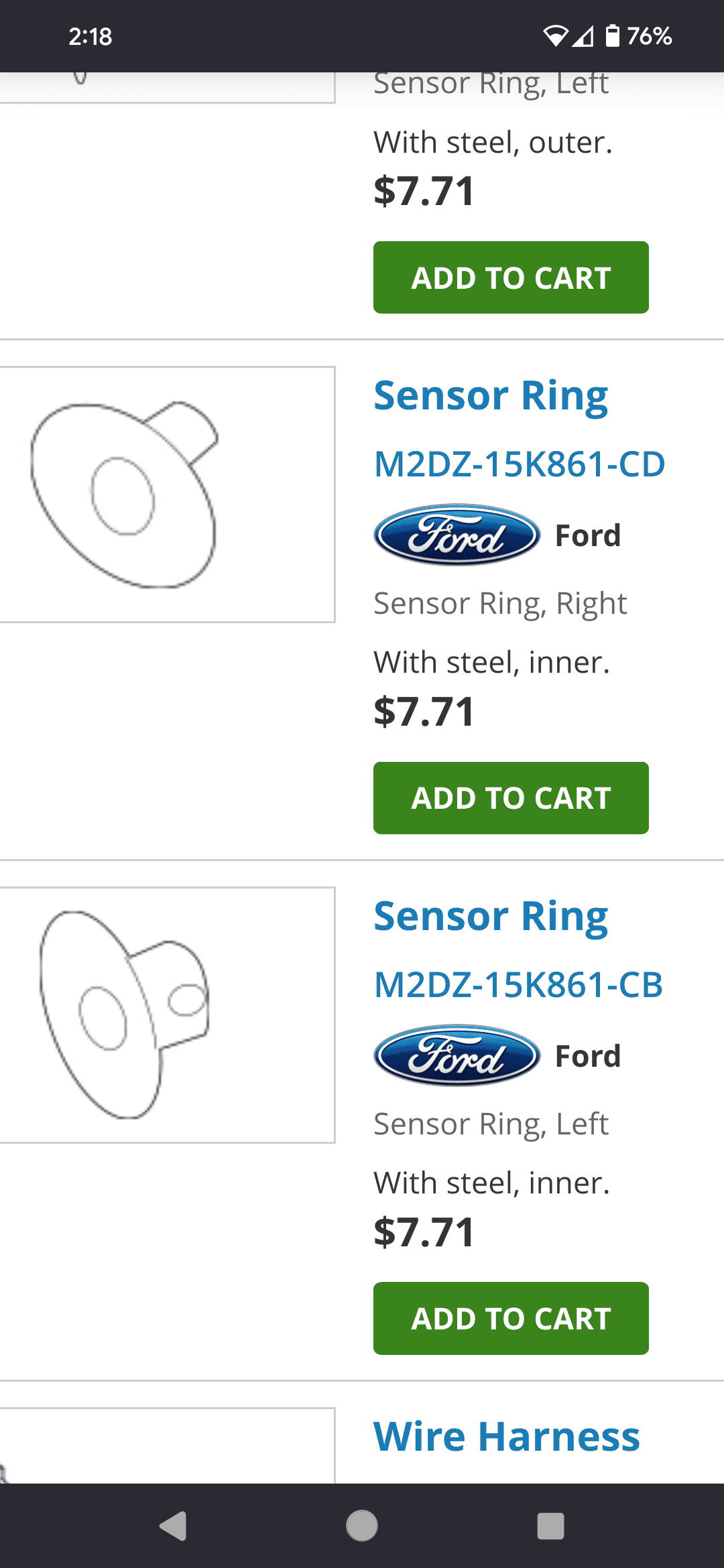

Anyone know about the plastic ring/trim around the front proximity sensors in the bumper (@Ducati1098 🙏🙏)? I think these are the parts:
I have a trail damaged one.
-I guess they are easily replaceable?
-It doesn't seem there should be a R&L version for this but simply one for all sensors on the front and rear bumpers. There are 4 total per bumper.
-Should I get a "left" version for the left/middle (drivers side) one on the front bumpe? Perhaps more precisely, counting from the drivers side on the front bumper, 1->4, this is #2.
Thanks in advance.

The ones in that picture are for the rear bumper.
The front ones are different for each sensor due to the way it sits in the bumper and how the sensor mounts into it.
LF outer: M2DZ-15A862-MA
LF inner: M2DZ-15A862-MB
RF outer: M2DZ-15A862-MD
RF inner: M2DZ-15A862-MC
