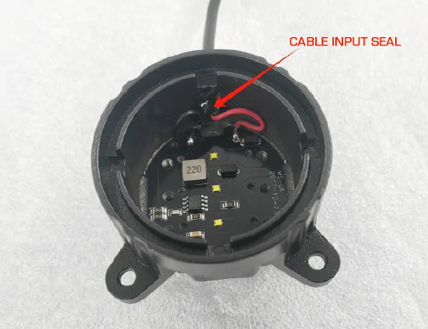

Root Cause: In this simulation it was determined that on some units the sealant around the cable input was penetrated by the high pressure jets. The vapor that entered would then condensate and appear as fog on the lens of the light module.
Ford Bronco Oracle Fog Lights Fogging Problem Resolved? 5890_seal

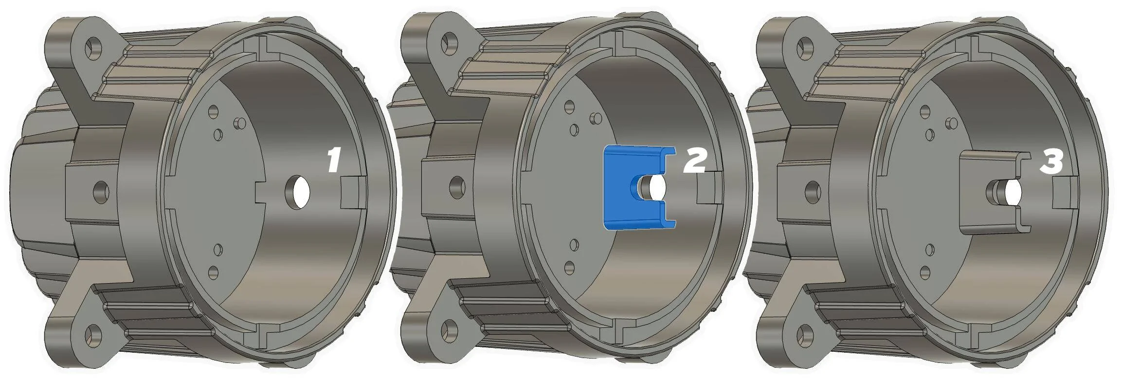

Corrective Action: In order to assure that this area is fully sealed a re-design of the mold was completed in February of 2024. This revision created a chamber around the cable so that the sealant can be injected after cable assembly which would allow the sealant to completely encapsulate the opening and cable itself.
These changes ensure complete encapsulation of the opening, preventing any potential moisture entry and enhancing the long-term durability of the fog lights. With this redesign customers can expect even greater reliability and performance from our LED fog lights, even in the harshest conditions. We appreciate your trust in our products and remain dedicated to providing the best possible experience.
Visualization: Original cable Entry (1), Seal Chamber Designed to Encapsulate Cable (2), New design (3).
