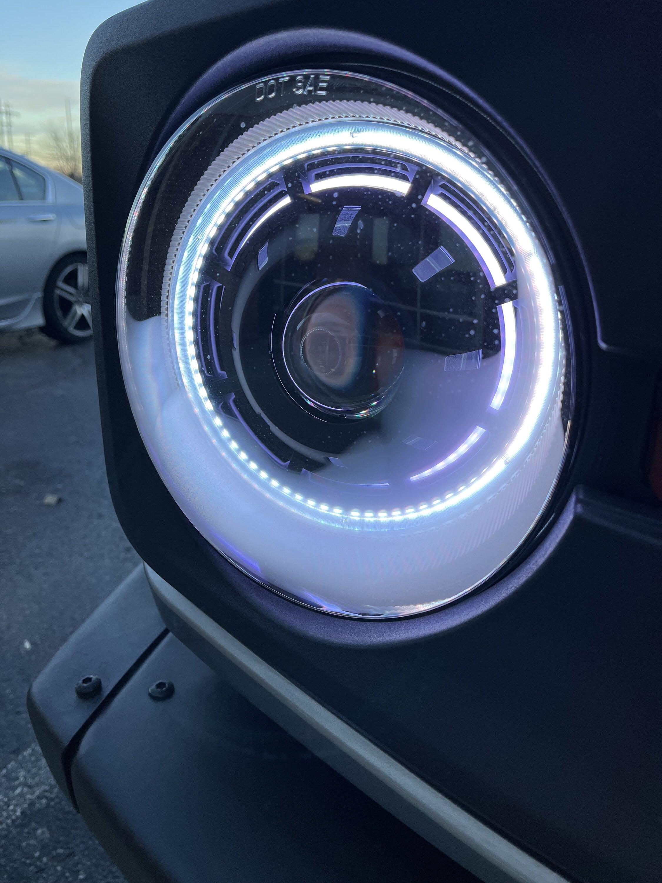

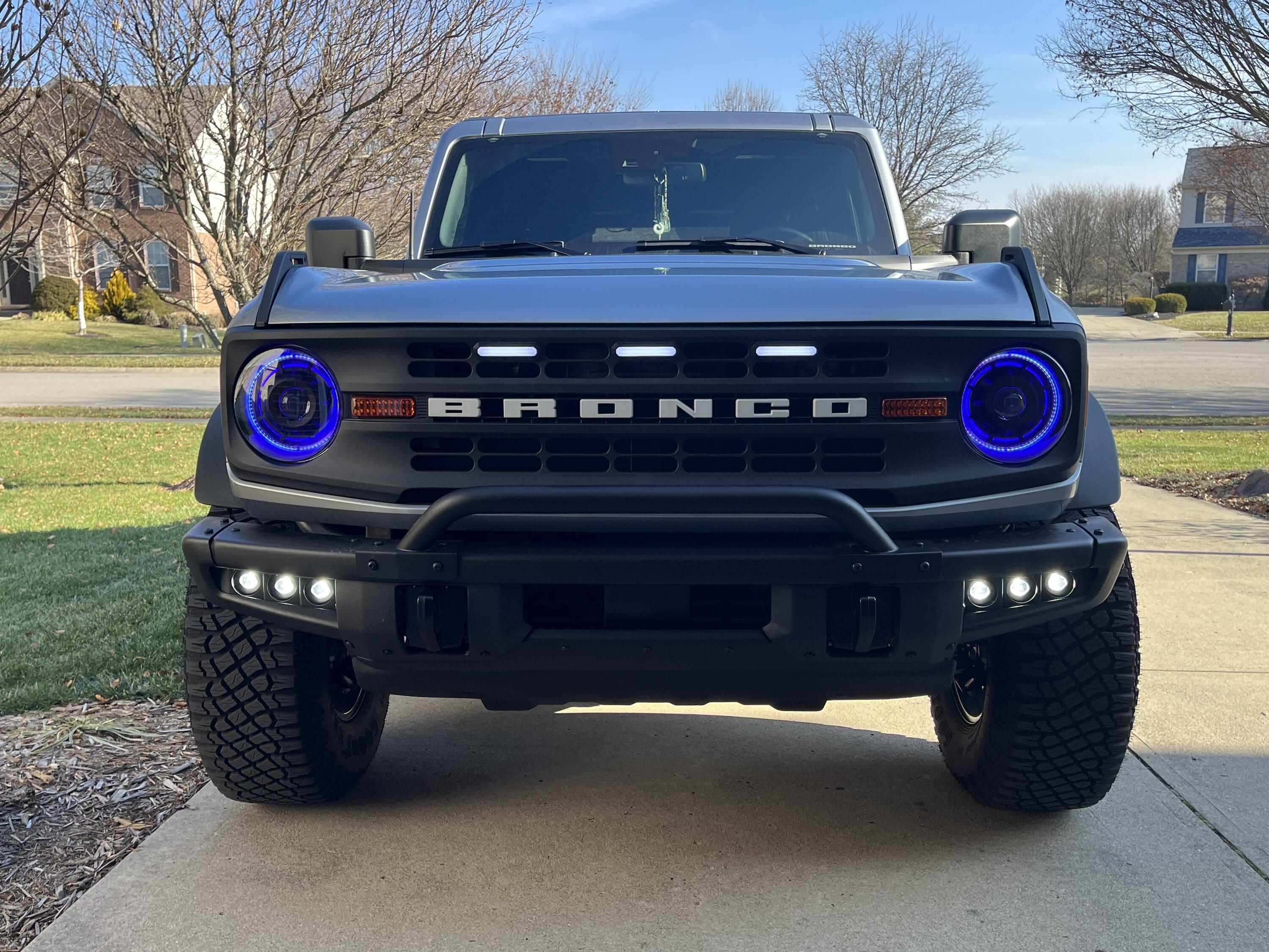

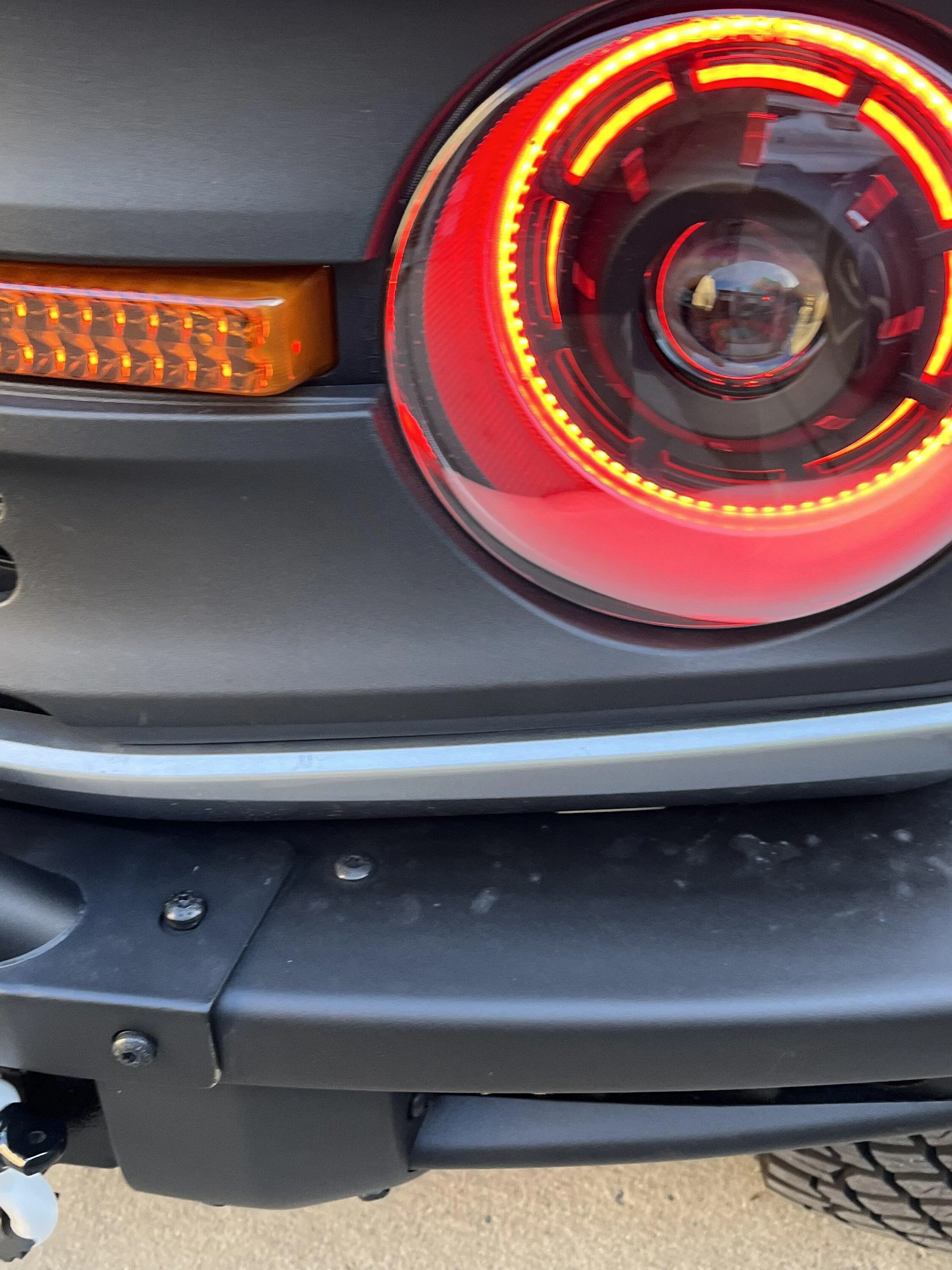

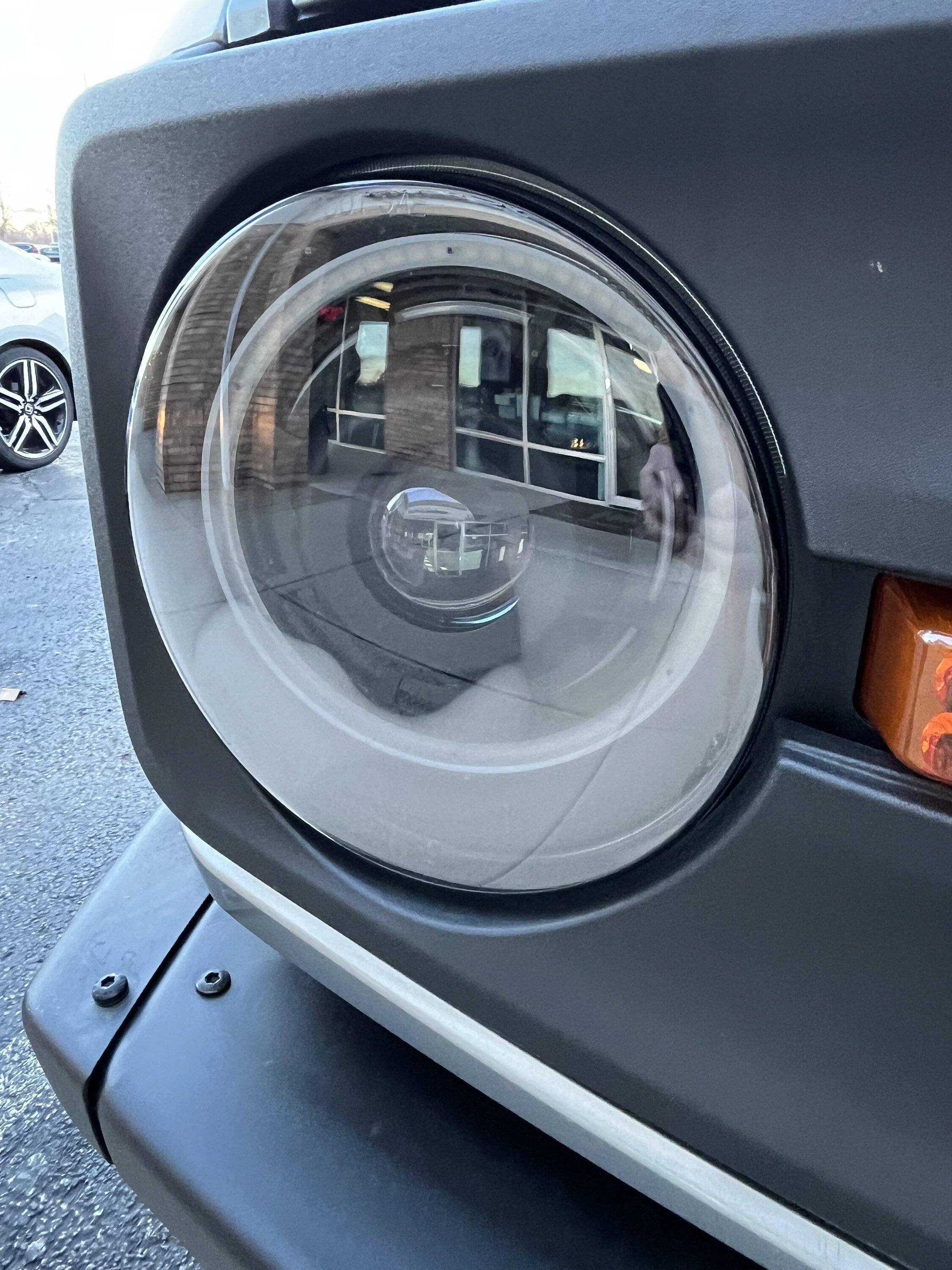

I recently purchased the Oracle ColorSHIFT Bi-LED headlights. I love the lights and the way they function…BUT….
Every time I drive in colder weather (under 45*) they fog up, then takes parking overnight to unfog…. Then the cycle starts again the next day.
I have had them 3 weeks and fog every day. Oracle tells me it is a normal process for condensation to form, but every time I drive? I don’t recall ever seeing fog in my OEM lights.
Does anyone else have this issue with Oracle lights, OEM or other brands? Am I being too critical?

I don’t have those lights but I do not think you are being too critical at all. I also wouldn’t be happy about it. I’ve never intentionally looked at my OEM lights after driving but I don’t recall ever seeing condensation on them either.
if you’re unhappy perhaps you can still return them? I would if I were in your position.

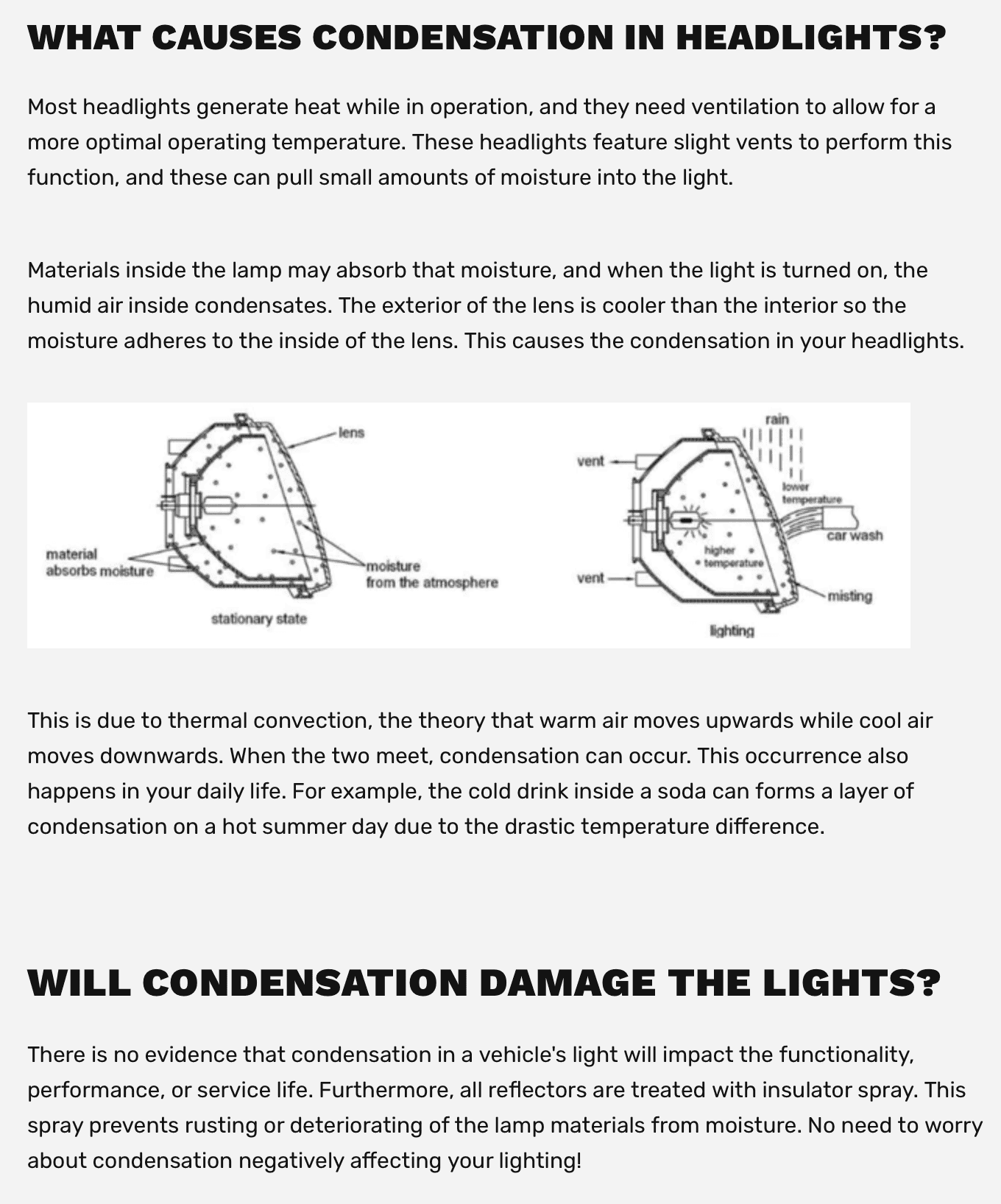

Hello, if there is cool weather or a temperature drop and the internal temperature of the headlight has not normalized to match that temperature level, you may see slight fogging on the inside of the light due to this atmospheric condition. This is not an indication that there is an issue with the light "seal" all lights are ventilated to allow air to move in and out of the light to provide a way for these atmospheric changes to normalize.
Here is some more info that explains it in a clearer manner:
Ford Bronco Oracle Headlights Constantly Fogging up Screenshot 2024-01-08 at 9.36.32 AM
After the headlights are turned on for 15-20 minutes the heat from the light will dissipate this fogging and it should go back to normal.

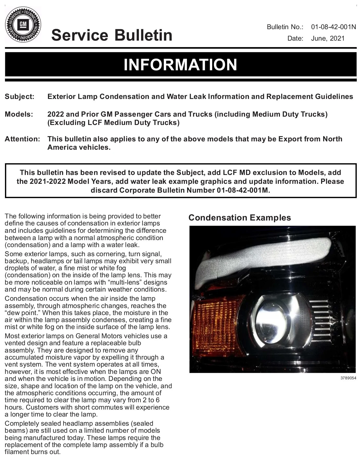

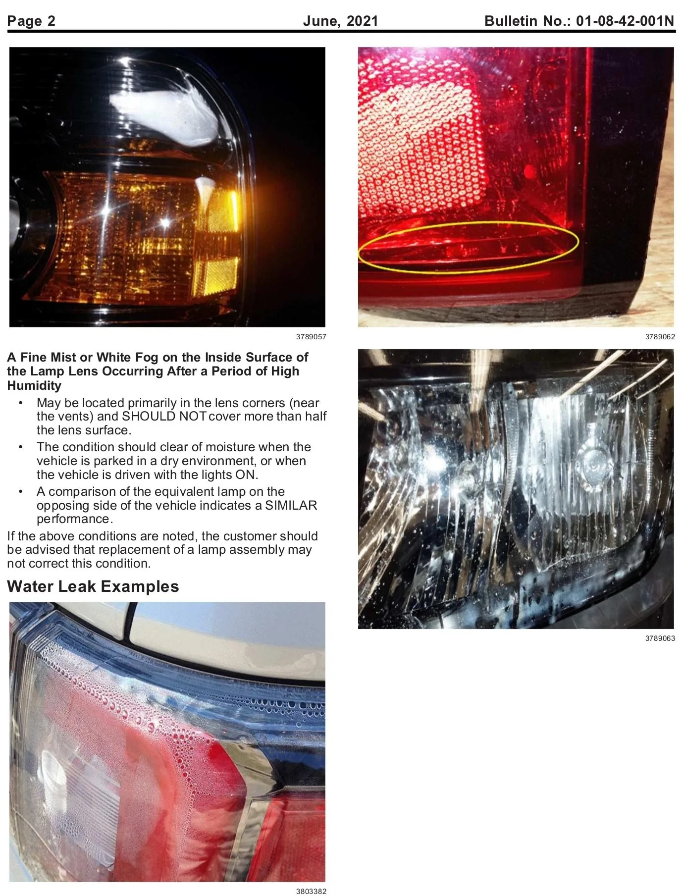

I have a 2023 Wildtrak with 2,200 miles (aka basically brand new). I have noticed this exact fogging (condensation) on my oem headlights the last month or so. As a matter of fact, i have had this same condensation on my 2 Ram trucks (2014 and a 2016) in the past and also on our current 2018 2500HD Denali. I've also seen this happening on my in-laws 2018 Buick. Whenever it's cool damp weather (approximately < 55°F), is when the greatest chance of this happening. Both Ram and GM told me that this is normal due to atmospheric conditions with vented headlights, especially when led lights are involved due to them not getting hot enough. Both Ram and GM have said that it's only cover under warranty when there are water droplets forming (not just condensation/fogging) and the condensation doesn't disappear after a certain number of hours, which it always did. Honestly, most people would probably never catch it happening unless they look at their headlights immediately after getting out of the vehicle on a cool damp day....and even then, it doesn't happen everytime.👍🤷‍♂️
CrazyPete
Aug 24, 2023
142
183
Buffalo, NY
2018 GMC Denali 2500HD Duramax

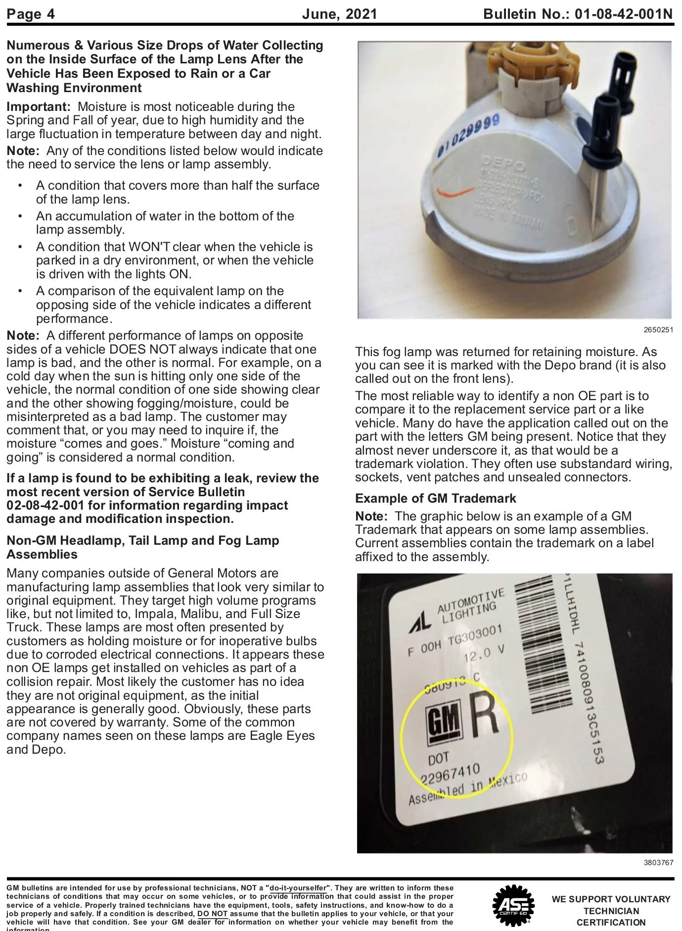

Here's the service bulletin from GM....Ram's was very similar. I would bet Ford has something very similar.
Ford Bronco Oracle Headlights Constantly Fogging up Screenshot_20240108_190113_Write on PDF
Page 2
Ford Bronco Oracle Headlights Constantly Fogging up Screenshot_20240108_190248_Write on PDF
Page 4 (page 3 was just two pictures)
Ford Bronco Oracle Headlights Constantly Fogging up Screenshot_20240108_190311_Write on PDF

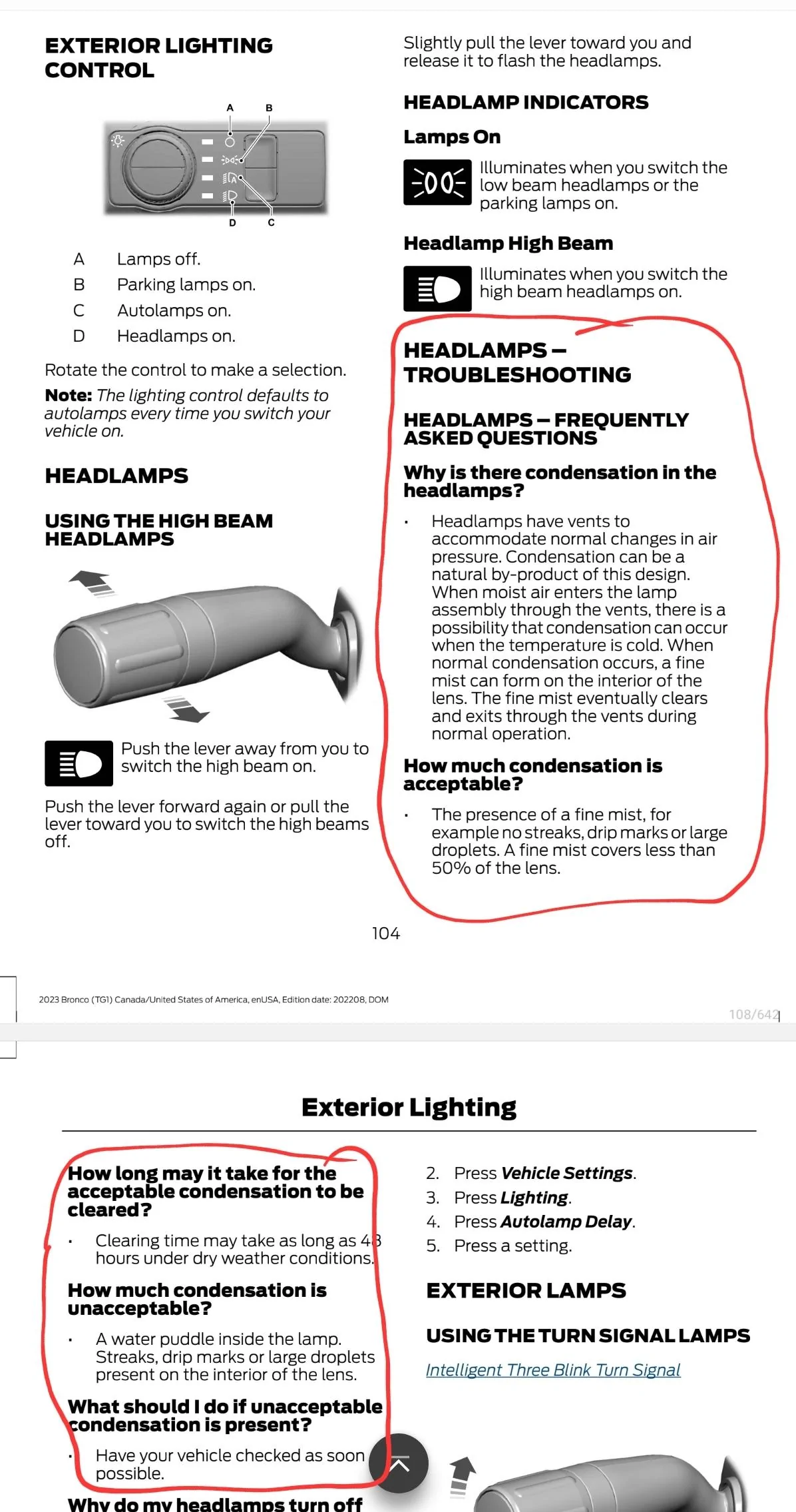

Yup....just like i thought. Pages 104-105 in the Bronco's owner's manual....👍
Ford Bronco Oracle Headlights Constantly Fogging up Screenshot_20240108_191419_Samsung Notes
