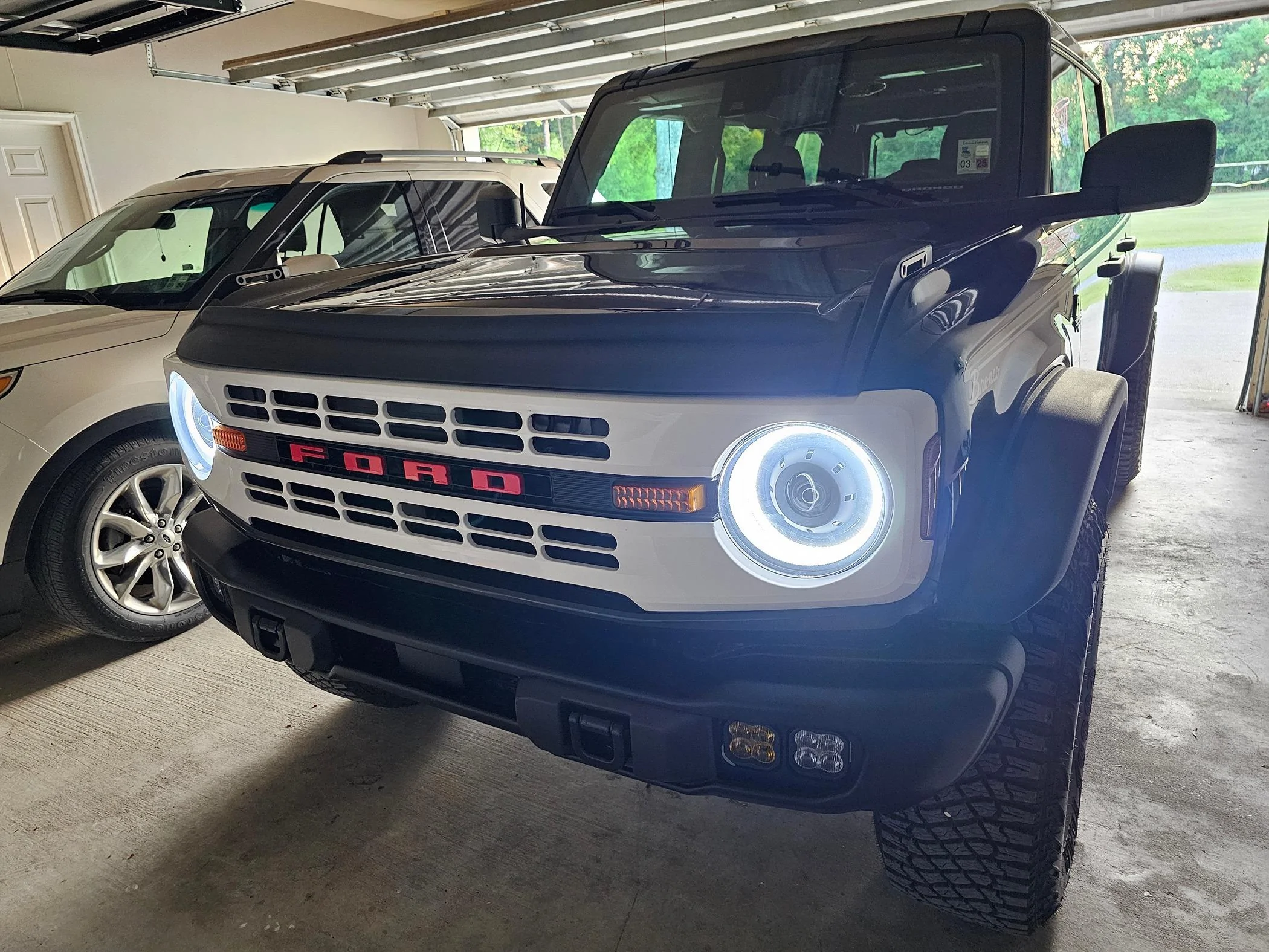

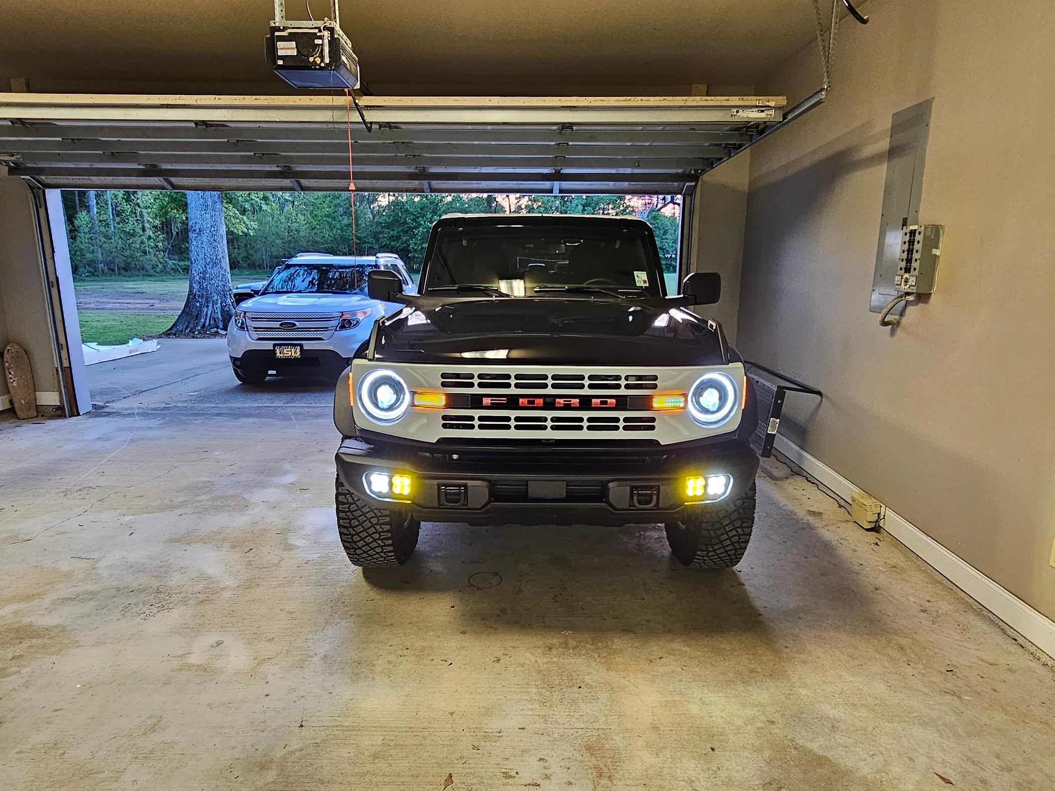

I've had my Oracle Headlights installed since the first week I got my Bronco. Today I noticed the LED won't turn off after I exit the vehicle. They usually shut off after a minute or two but today they won't. They've been on for hours. Any ideas?

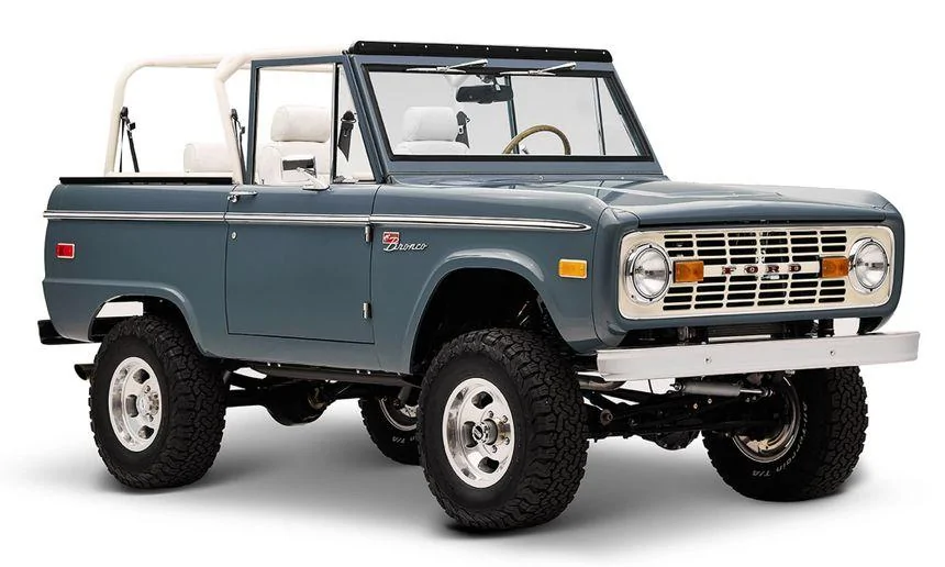

They look much closer to the 1966 lights the Heritage is modeled after than anything else I've seen.
Hello, the power channel for the Halos takes 5-10 minutes to shut down. they will turn off, just give them some time.

I've been noticing this too but just the side and turn signal lights that stay on, sometimes they turn off after a minute sometimes it's just the side markers that stay on and sometimes it's the side and turn light that stay on. Toggling lock and unlock a couple times usually turns them off but sucks that I have to check each time.

I've also noticed a white flash when using the color switcher (fade) when the bronco is on (doesn't happen when it's off)

What model year is yours? After several months off owning my 22' Big Bend I began experiencing a similar problem with my standard factory lights when the panel switch was set to Auto. Turned out to be a common problem with 21's and early 22 models as corrupted logic withn the panel switch caused the lights to either stay on after completely shutting down or would come back on a few minutes after shutting down. The dealer was aware of the issue and replaced the switch under warranty with corrected version and the problem has never returned. Refer to TSB SSM 50842.

Mine is a 2024, only started happening with the Oracle lights
