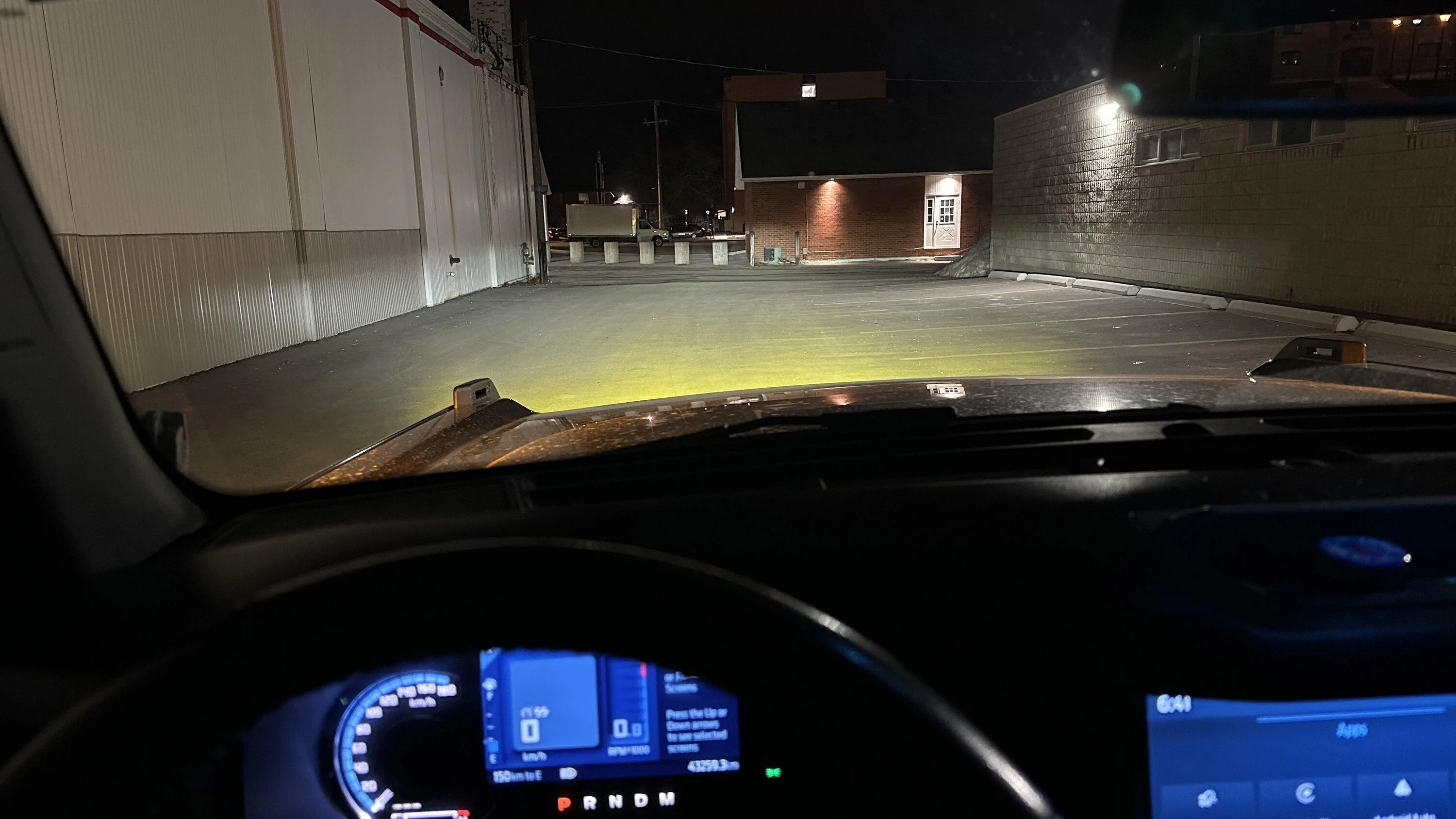

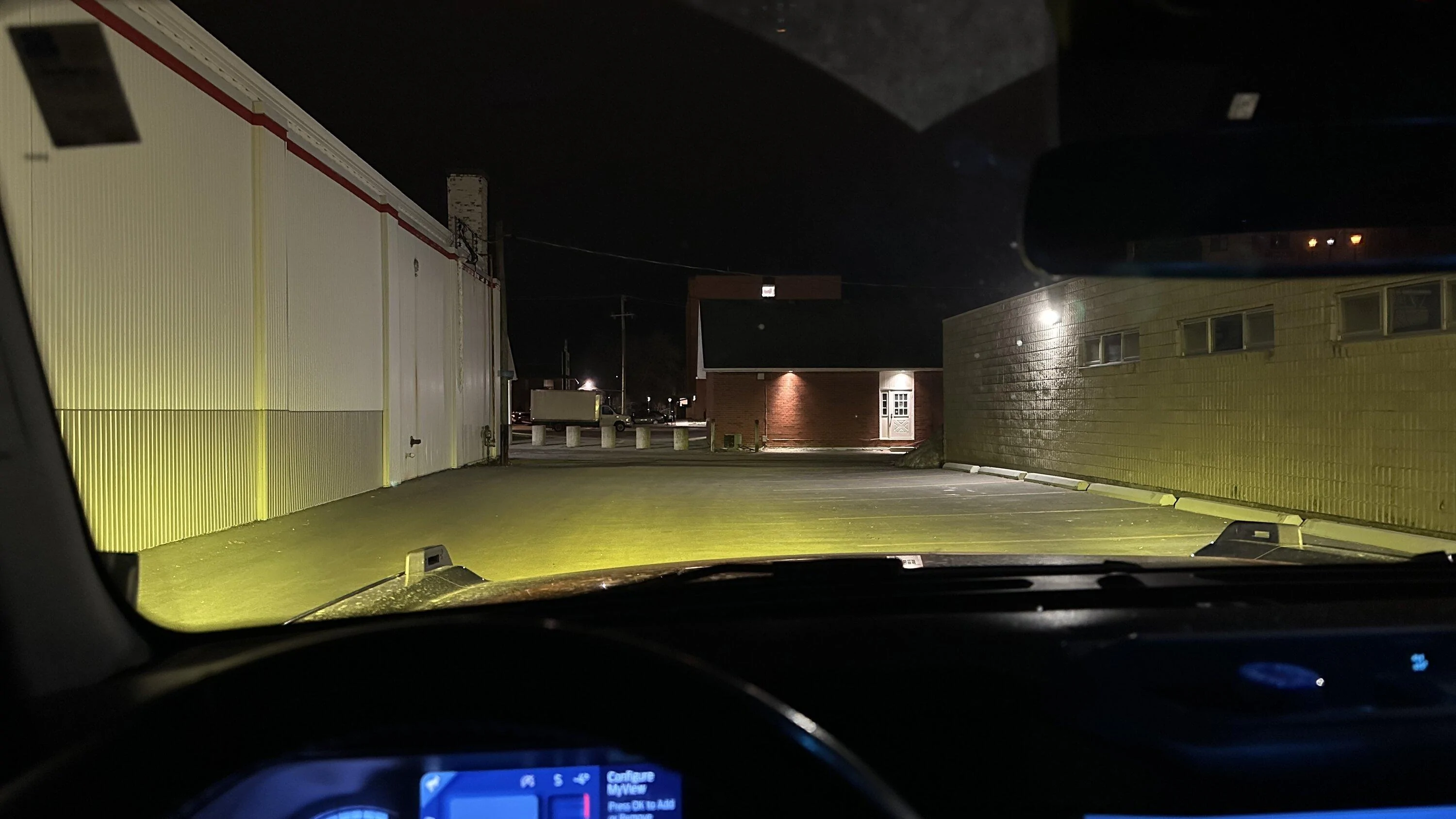

I’m a bit of a ding-dong so I don’t really have a pic on the other side (looking to where it is aimed at) other than in an area that is very well lit.. will try to take a better pic tonight or tomorro
Ford Bronco Oracle fog lights  are those adjustable? C7BFA1C7-BEDD-4650-8D98-F40F14FABF60
This is in a lit parking lot, WITH my headlights on.

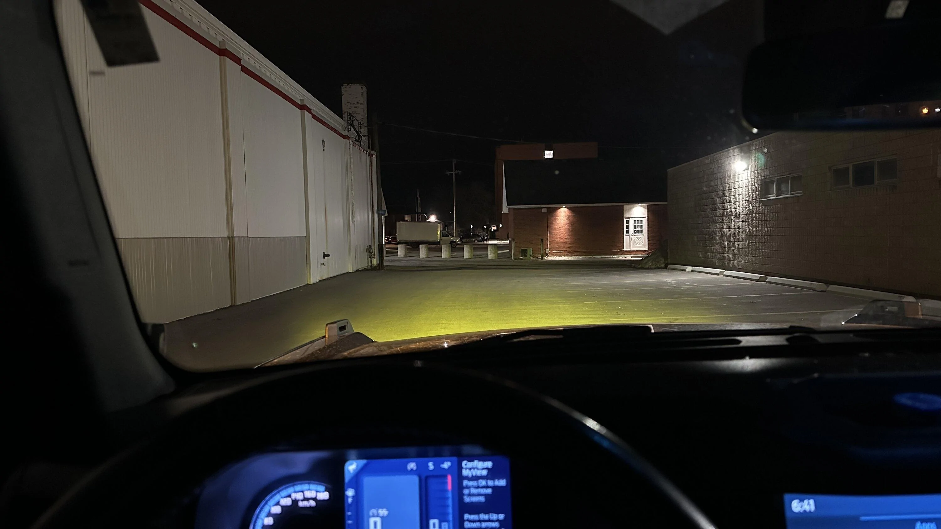

Ford Bronco Oracle fog lights  are those adjustable? 90949CE6-0249-4282-AFB1-AC56420E0617
Same parking lot, NO headlights just fogs. I’m aimed down with a 1/4” spacer. In darker areas it’s pretty clear that they don’t shoot as far. Hence why I’ve mentioned previously I’ll prob switch to 1/8” spacer.

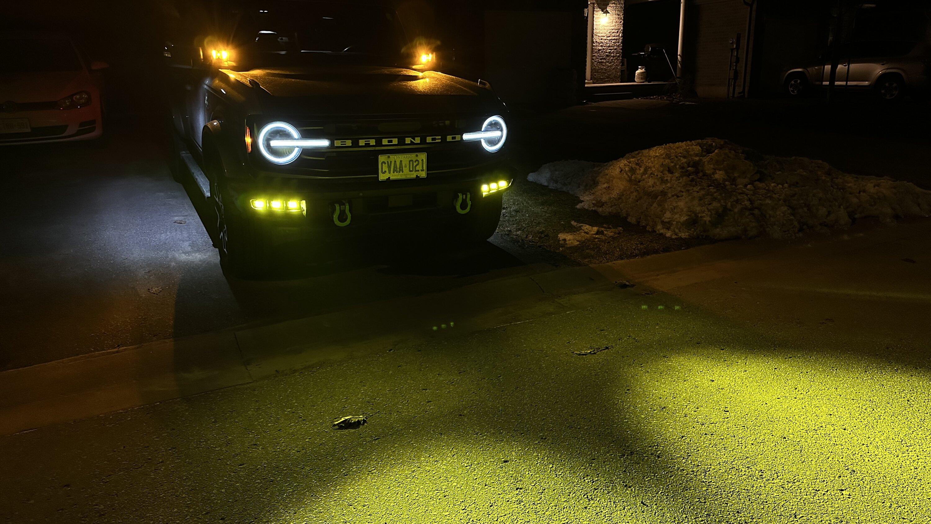

Lastly.. I think this is still with headlights off but includes my Amazon ditch lights.
