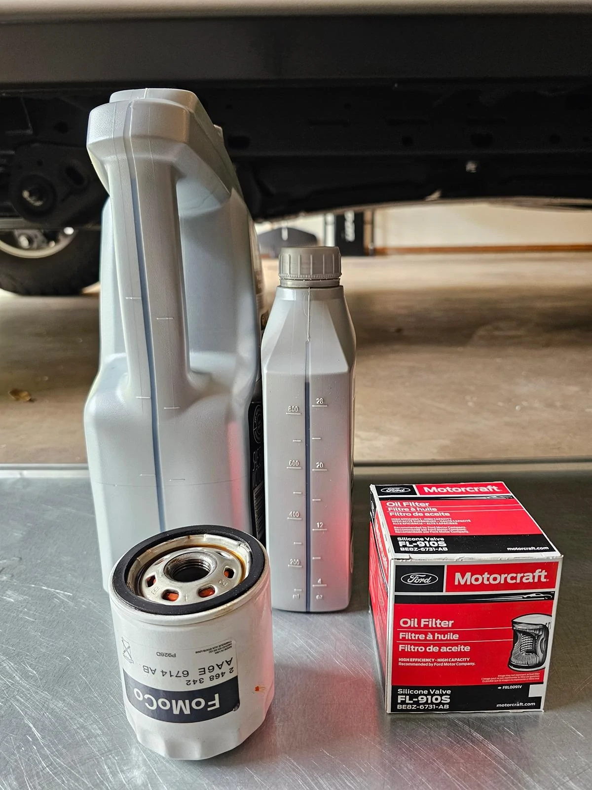

Just finished 1st oil change on 2023 Badlands with 2.3 manual.
I put in 6 qts of Mobil 1 and wil check in a bit.
I let the old oil drain for 30 minutes, put on a Fumoto, pulled and swapped the filter, then let it drain another 15 minutes.
No major spills.
Very unscientific, but here is a picture of what I took out and put back into the original jugs to take to the recycling center:
Ford Bronco Oil Change 2.3L lessons learned 20240617_104150

Will you still have to pull the skid plate for future oil changes with the Fumoto?
No major spills.
Adding the Fumoto oil drain valves is the ticket. For my two 2.3L's, I went with the F-107SX.
Up to you.
I'm probably going to use a hole saw in the skid plate then make a cover slighlty larger than the hole that is held on by 2 10mm bolts. It will mimic our family 4Runner that is notoriously easy for oil changes.
But I like messing with things and I know that's not everyone's bag.
