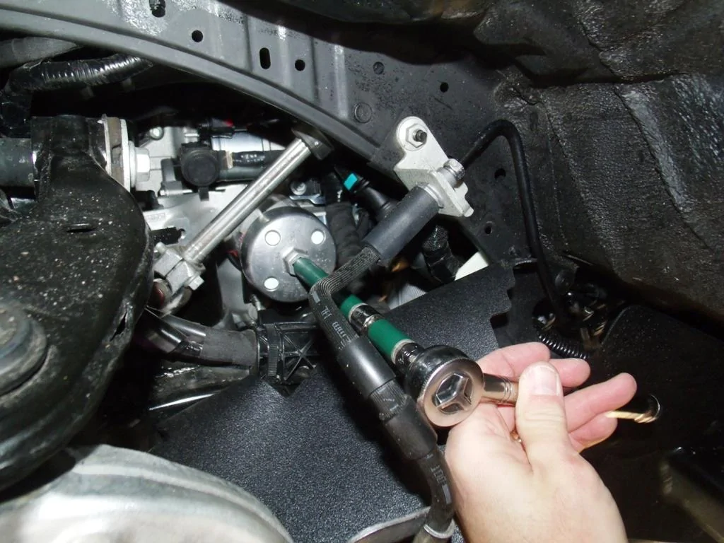

Yes, good point. There are a couple of Ranger videos and it looks like access through the LF wheel well works (with or without tire removal). If going that way, the filter "cap wrench" that fits on the end of the filter appears to be the way to go from the angle of the access.
I reached through the left front wheel to remove the filter. It worked well and I had the grip strength to remove it without a wrench.
