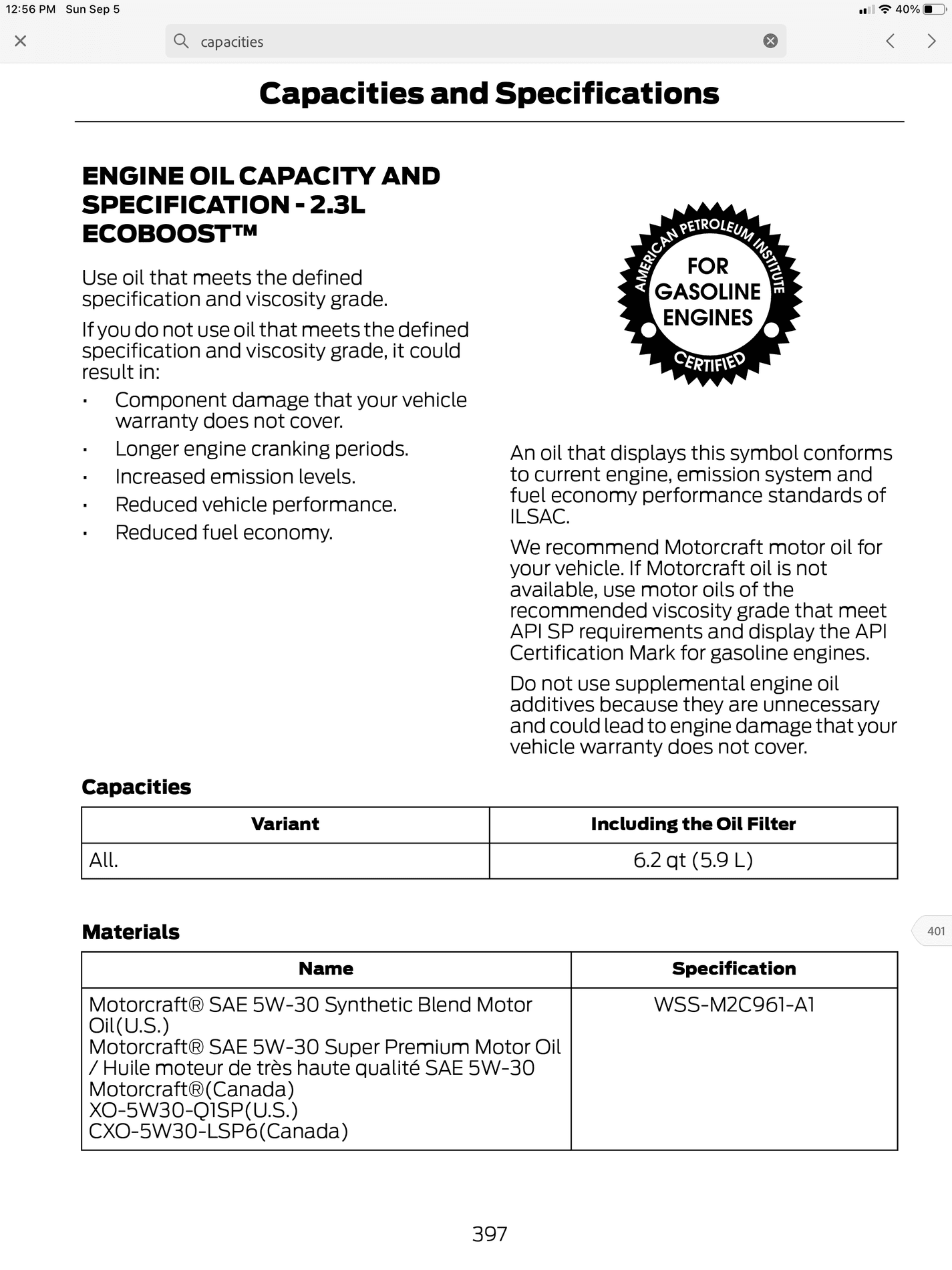

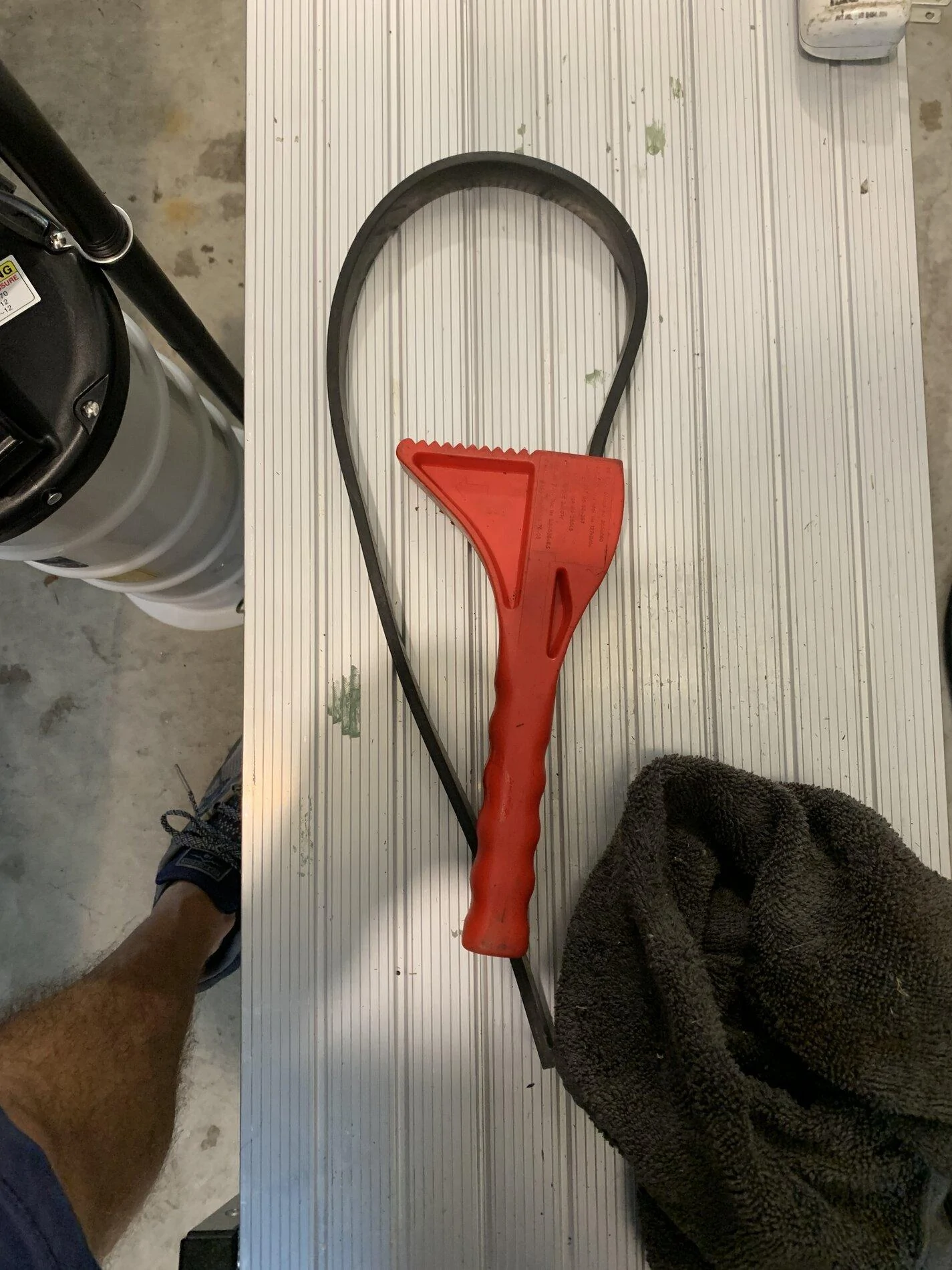

I hit 1000 miles the other day so figured I’d change my oil. 5w-30 oil filter was a motorcraft FL-910S. I used a siphon pump to extract the oil which worked well. But I do need to do a traditional change to see if the siphon is taking out all the oil. I only got 3.75L which is much lower than what is required on the oil capacity which was like 5.5 quarts or something like that. I feel like I left a liter of oil in it. But I hooked the siphon up to my compressor and it sucked all it could out of the engine. Biggest lesson learned is the filter change. Kind of a pain in the arse. Hard to get a tool on it. I ended up using a rubber belt foil filter tool. Pictures below. However once you crack it loose be aware. There is a little aqueduct type thing that is designed to route the oil from the filter right down your arm as you are reaching up there to remove it. See videos below.

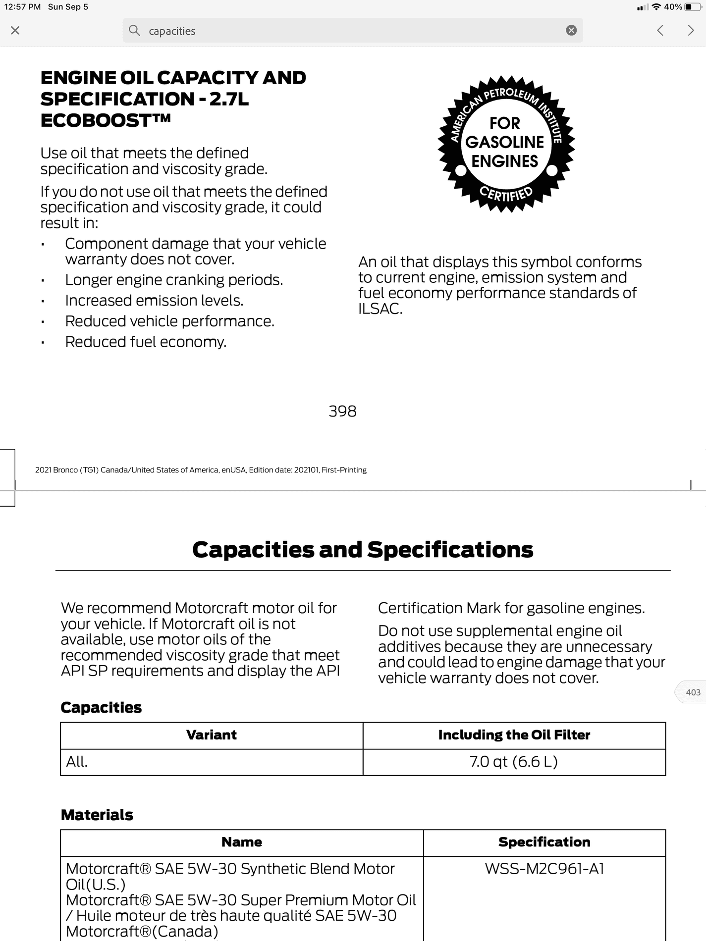

A member here posted a video of his oil change on a 2.7L. He let the pan drain a long time to get all the old stuff out. Now, here's the rub. The manual calls for 6 quarts, but the oil was spot on full after he poured in 5 quarts. I looks as if Ford has made a mistake somehwhere on the oil capacity of both engines.

Here is a video of the Siphon I used. It’s an EWK very pleased with it.

Minor correction. In the owners manual, the stated oil capacity for the 2.3L 4-cylinder engine is 6.2 quarts. Stated oil capacity for the 2.7L 6-cylinder engine is 7.0 quarts. Both capacities include oil that eventually sits inside the oil filter itself after circulation.
There is on ongoing debate about what the actual oil capacities really are, because the actual amounts removed during an oil change are lower than the stated capacities.
