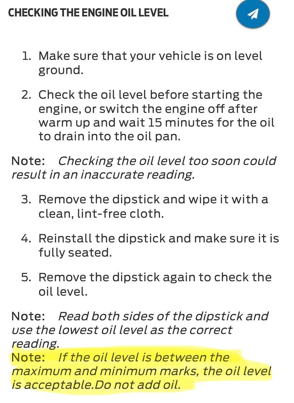

.5qt gets to the full.
Curious if adding the .5qt is a good or bad idea...
Anywhere between minimum and maximum is considered acceptable. Adding or not adding .5 quarts won’t make a bit of a difference either way.
Appreciate your thoughts on this.
