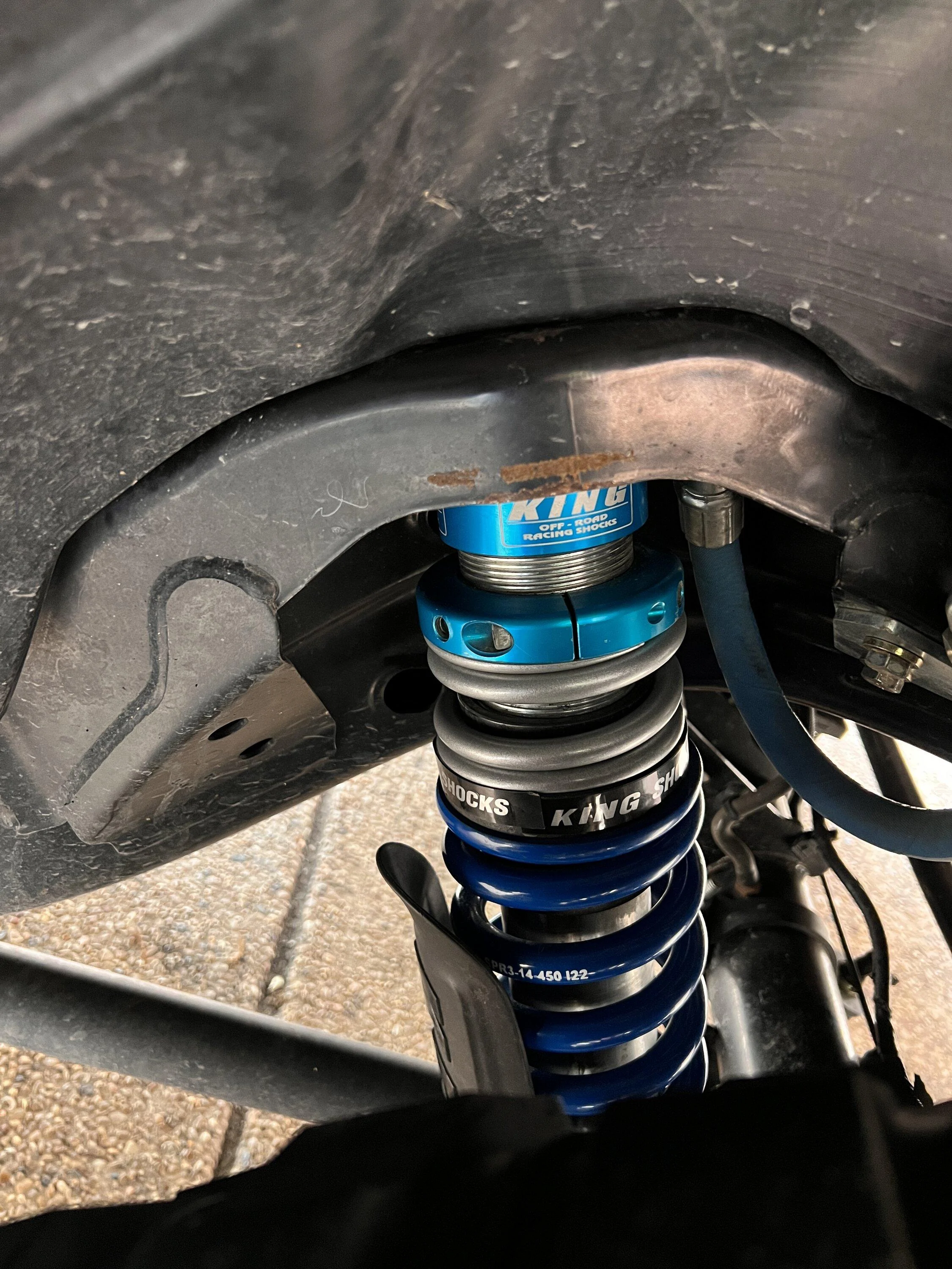

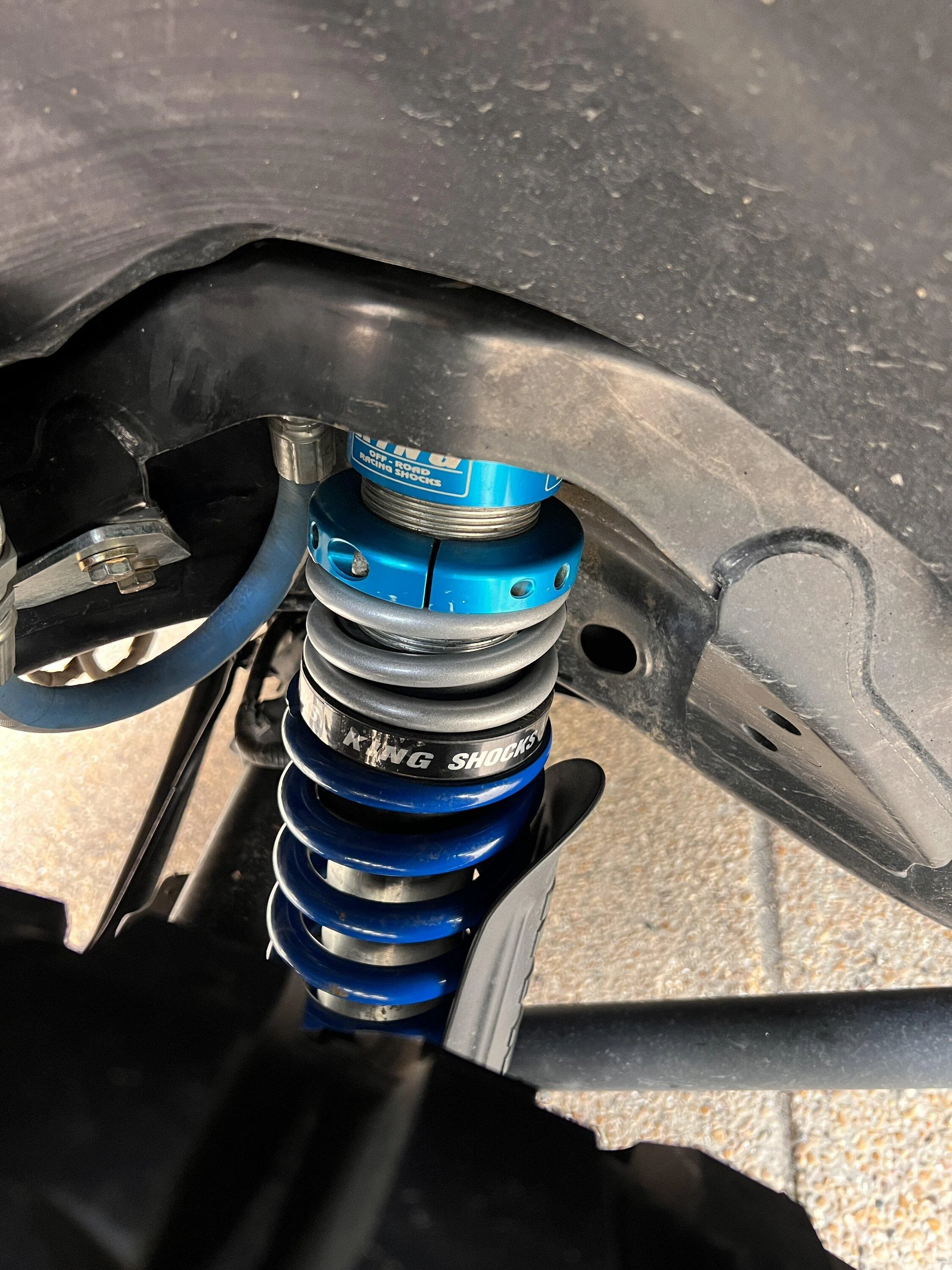

I just measured my fronts per your video and I measure about 5-1/2” as well. I have not noticed any roughness or loose feeling you are describing. I am at 15 clicks from soft. I attached a couple pics of how mine are set and how my Bronco is now sitting with the new 450/600lb spring setup with all my stuff in the back.
Ford Bronco Not sitting level after King shocks installed 207A9DDF-C314-4848-B654-2BE5F3AD0F87
Ford Bronco Not sitting level after King shocks installed 43302665-95F9-4D6B-B23E-DB92DD7D8610
Ford Bronco Not sitting level after King shocks installed 4B0B7818-E8E9-4192-9EE1-2082FAB17FEF

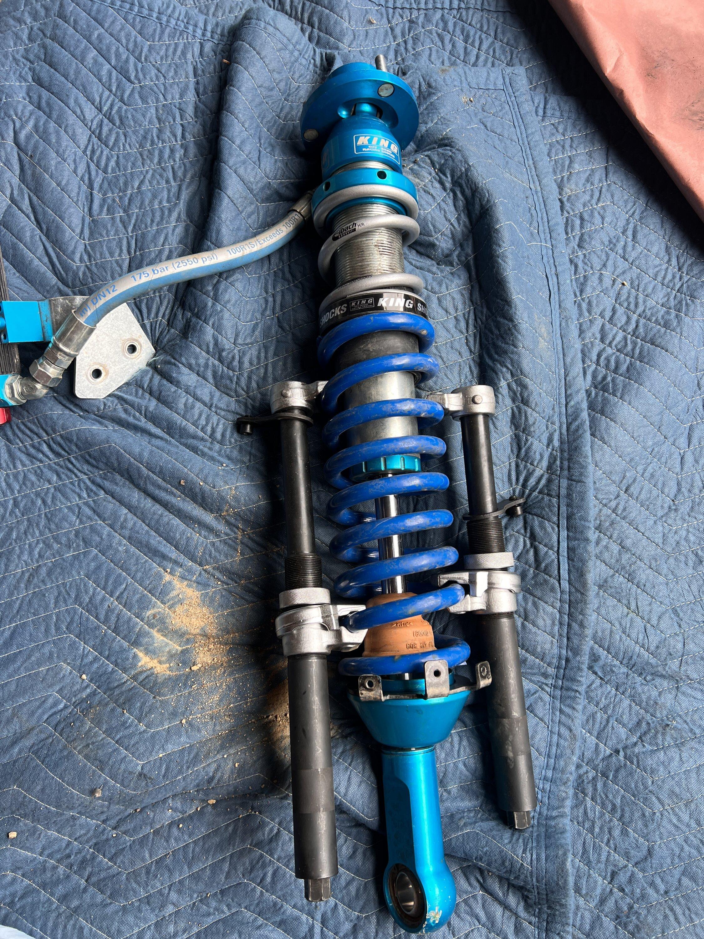

I have had the new 600lb tender springs for a while now. After changing out the main spring I just didn't have the motivation to take them out again and add the new tender. But, I had a free Saturday and finally got it done. The biggest pain in the butt is taking out the wheel liner. I only take out enough of the fasteners to where I can bend it back and get to the top bolts. But that freakin 7mm that is underneath, where the factory slider gets in the way is a royal pain. I have a million ratching box wrenches but I did not have a 7mm so I had to use pliers to get that one bolt out. I just order a 7mm so next time, I will be good to go. Anyway, once you past the liner, the rest is fairly straight forward. I also took the opportunity to install my Borne Off-Road rear shock protectors. I actually had some scrapes on the bottom of my shocks so I wish I would have added those protectors earlier.

Side note - Looks like maybe your Resi hose is taking a beating on the control arm
Yea, it was rubbing a bit but I ended up just lightly hammering in that angle piece at the top of the shock with a plastic hammer and it moved it out of the way. It is not rubbing any longer. The other side is actually worse! But both are good now.
