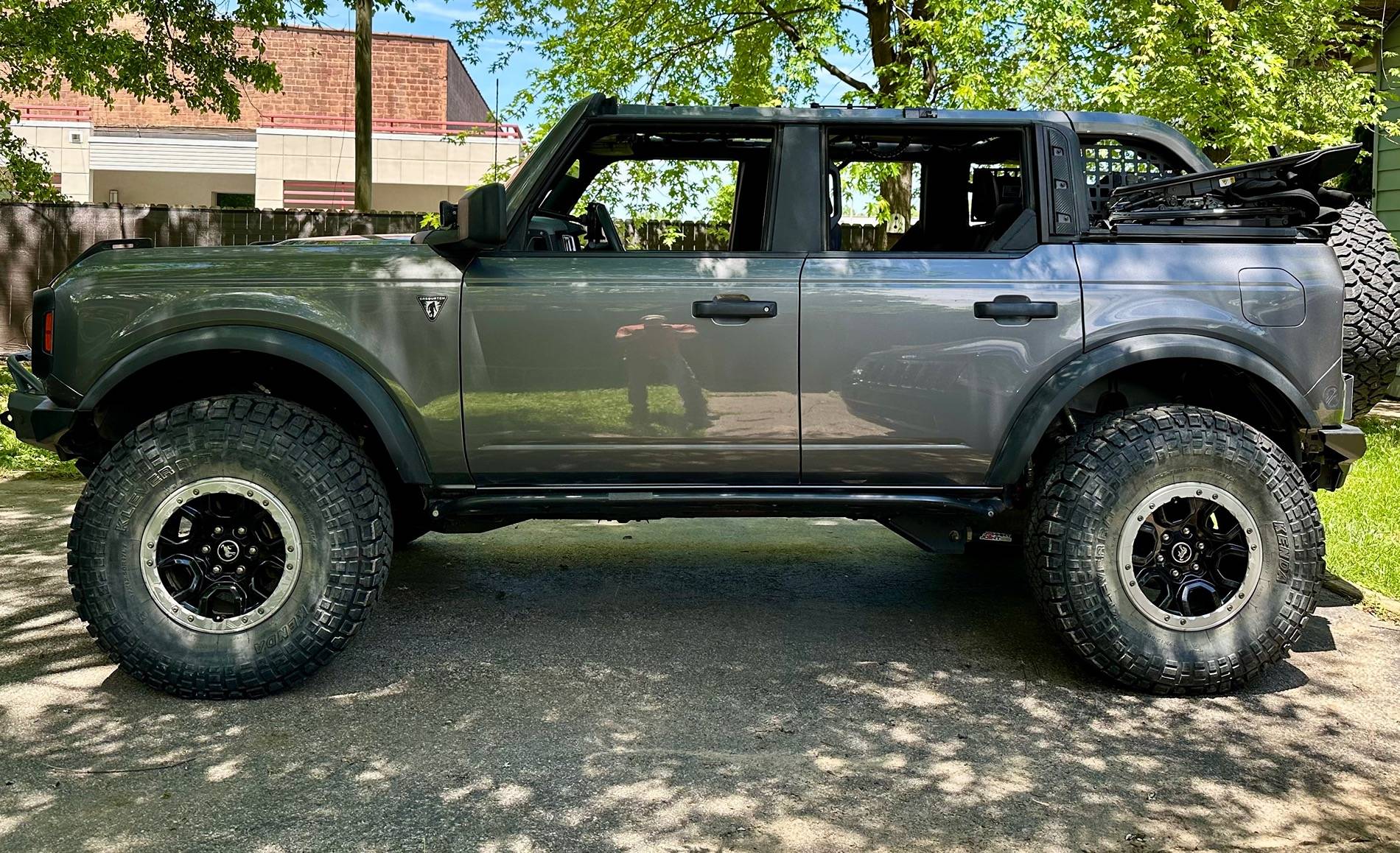

Ford Bronco Nose high on Fox 2.5 (not leveled) IMG_4823
I
I like them, I think they were worth the upgrade. In the beginning I did have a little too much rake. I didn’t want to increase the preloads on the fronts so to get rid of that rake I ended up placing 3 grade 8 washers under my front coilovers gaining about a 1/2” of lift to level it out. Turned out pretty nice I think. Pic here is with standard flares. Pics in that link are with DV8 tube flares.

Your ride looks great in this pick I noticed you have 37’s on the stock wheels I want to do the same thing. Do you have spacers or the jks kit.
I’m using the JKS max tire kit and I’m running 1.25 wheel spacers. You probably won’t need the max tire kit. I mainly got it to clean up the front end and to ditch those crash bars that stuck down under the bumper.
