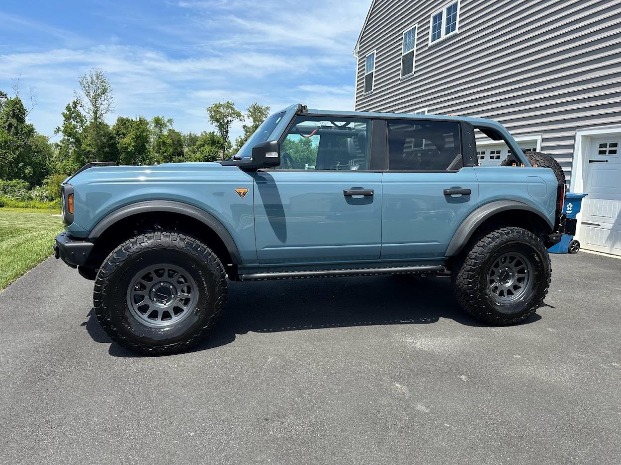

I'm running the FOX 2.5 PERFORMANCE ELITE COILOVERS and out of the box the rig is running nose high. The ride feels good in general, have hit a couple of gravel roads on Baja mode ..go fast :) nearby but I haven't got a change to flex it at the trails in PA. I'm planning on putting a few 100 miles before adjusting to correct for high and level it.
For reference I have Camburg UCA, ICON steering and RCV axles with ICON rear arms and track bar in my set up.

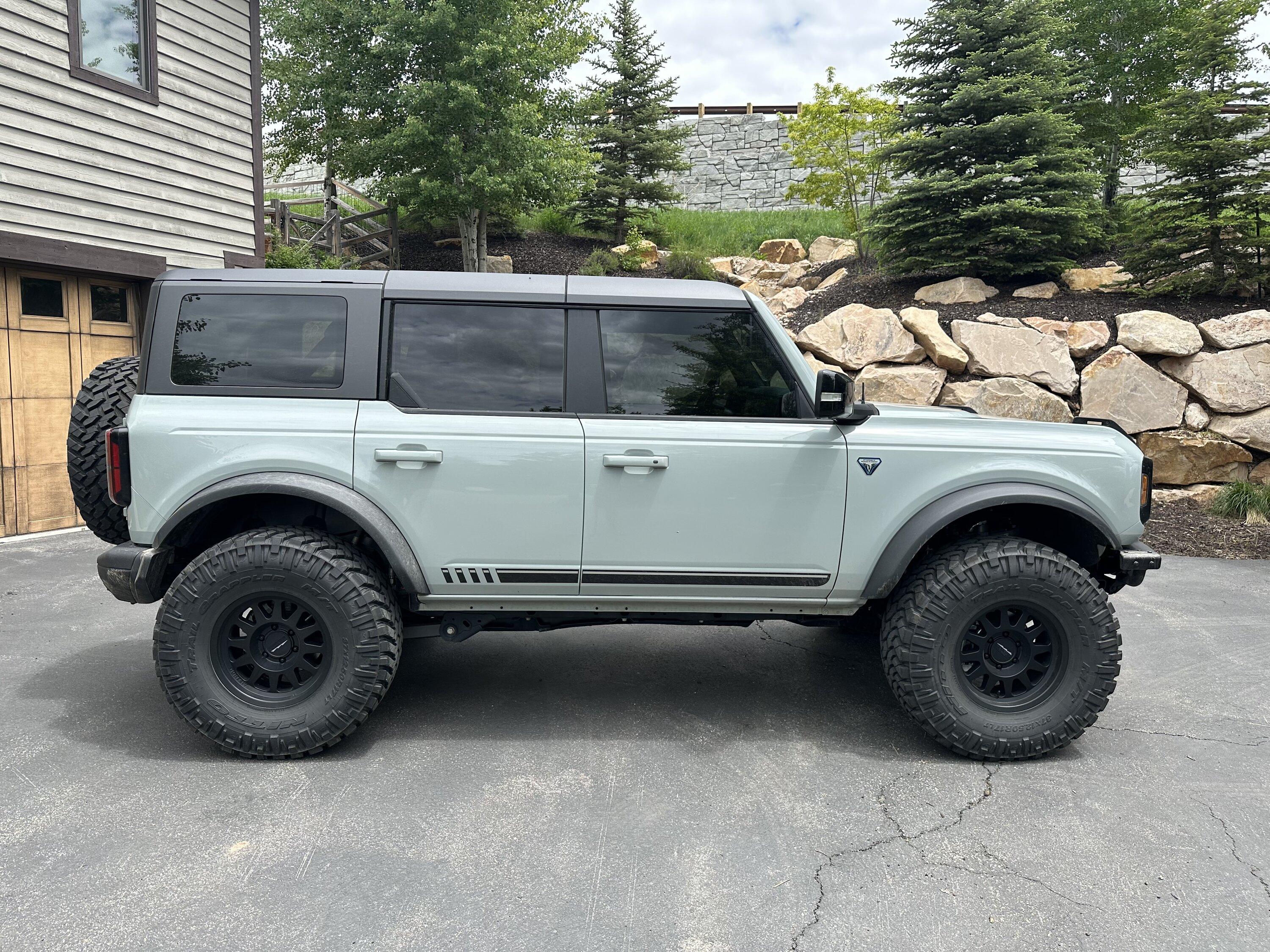

Thats odd! I’ve had my Fox Coilovers on my 4dr First Edition for over 1.5 years (I got one of the first sets available ). It sat perfectly level right after install and it is still level, even with the 80lb 37 Nitto hanging off the back. I expected a little drop in the front after a while but it’s exactly where it was after install. The spring preload on the rears on mine was barely turned down, just a few thread turns, so it would be easy to lift the rear a little by increasing the preload. Your referenced aftermarket goodies don’t have anything to do with with ride height … just spin down the spring a little 😁 using a spring compressor of course ! FYI the fox 2.5 tool does not work, get the 3.0 if you plan to buy the preload tool.
I agree with the post that the rear springs are a little soft, might change them when there are some aftermarket progressive spings available.

Thats odd! I’ve had my Fox Coilovers on my 4dr First Edition for over 1.5 years ( I got one of the first sets available ). It sat perfectly level right after install and it is still level, even with the 80lb 37 Nitto hanging off the back. I expected a little drop in the front after a while but it’s exactly where it was after install. The spring preload on the rears on mine was barely turned down, just a few thread turns, so it would be easy to lift the rear a little by increasing the preload. Your referenced aftermarket goodies don’t have anything to do with with ride height … so just spin down the spring a little (using spring compressors !) FYI the fox 2.5 tool does not work, get the 3.0 if you plan to buy the preload tool.
I probably agree with the post that the rear springs are a little soft, but not enough to change them out.
If you got those shocks 1.5 years ago, you likely have a different rear spring than what is being sold today. By chance, do you see a PN on the rear springs you can find?
I don’t see a PN peeking under the truck.
I did just measure mine for the hell of it, and I’m at 7” tire to flare in front and 6.5+ in the rear … but it looks level to me lol (37” Nittos which are one of the tallest 37s I think ). I’m assuming the OP is on 37s, so interesting the ride height difference.
Looks can be deceiving and the truck actually sits differently parked depending on if you stopped after going forward or after backing up

Mine rode a bit higher on the front end for the first couple hundred miles. I was hoping to lift it more today but my technician was not able to get the spanner tool. Can you provide the part number of the 3,0 tool you used ?
Interesting. Seems mine came with more front preload than yours, but like I said the rears have almost no spring preload, so like Accu said it sounds like I have a different spring in the back 🤷🏼‍♂️
I never actually changed my preload from stock after I bought the 2.5 spanner wrench that doesn’t work lol. So sorry, I don’t have the PN.
