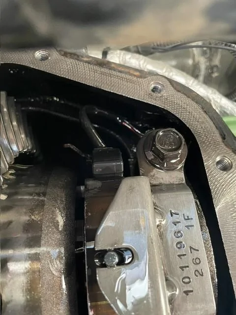

It took a while for the parts to get in, the carrier bearing was backordered until just this week. Today was the first day I had to get into it and replace the coil. It sounded easy - just pull the axles back, pop the carrier out, pull the right carrier bearing, and swap the coil.

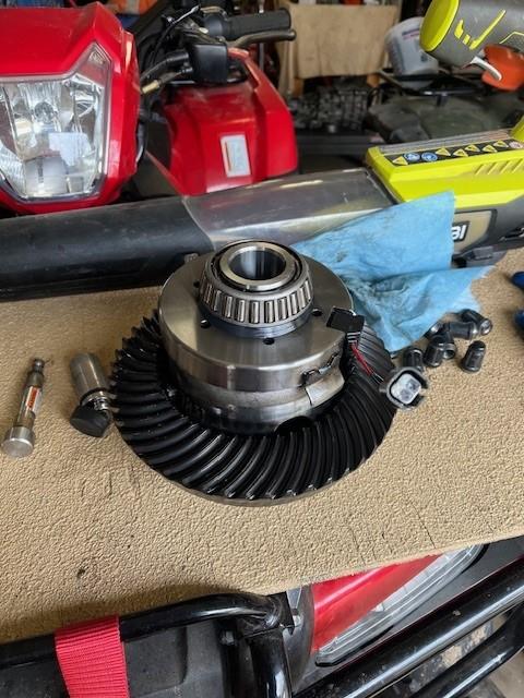

Here's the carrier, this is after I got it out with the old coil in it. It looks identical when I got it put back together.

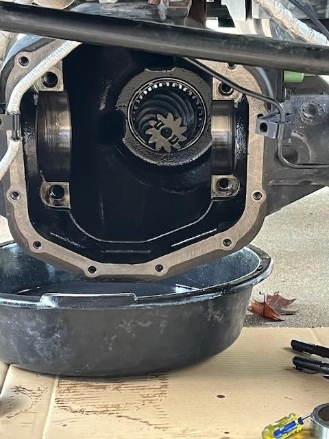

Just for the sake of completeness, here's a picture of the pinon with the carrier pulled.

Pretty sure everything went back the way it came apart - there wasn't exactly a lot to it - a small plate underneath the coil, the coil, and the carrier bearing. The little catch on the carrier housing that hitches a welded pin on the coil.
I can't even really think of anything else to check. Any ideas? Maybe it's working and I just am not testing it right? I'm stumped.
