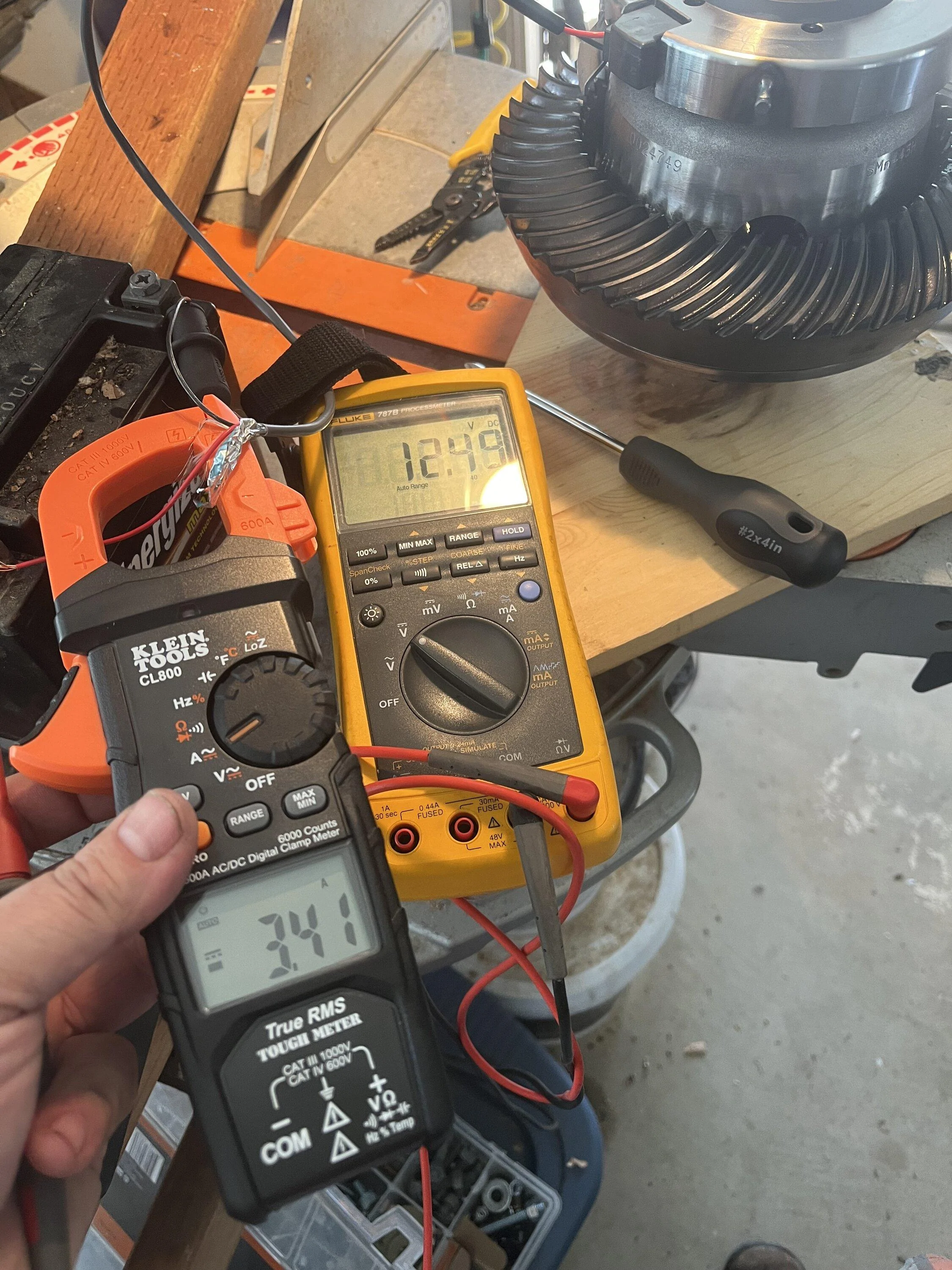

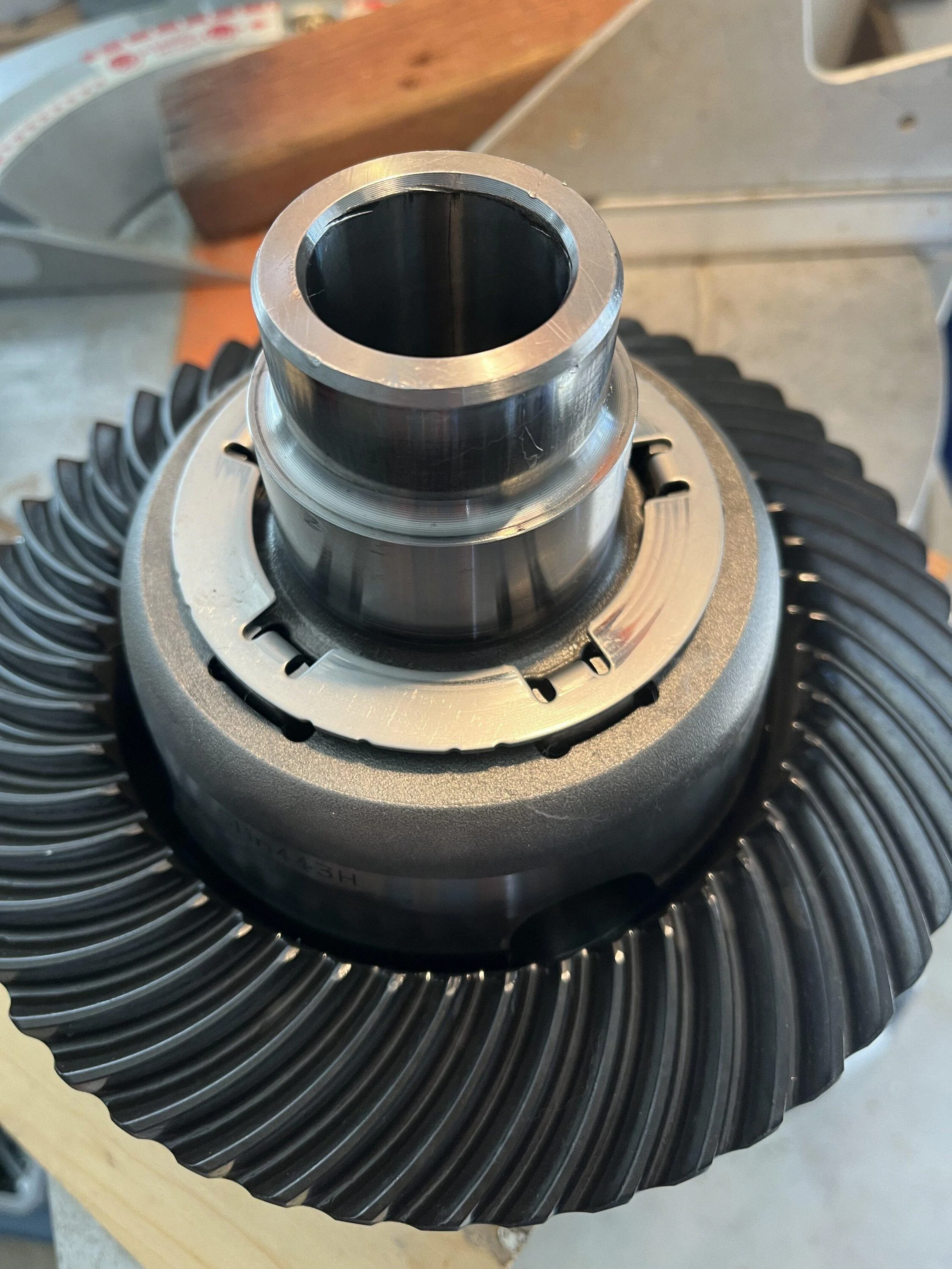

Ok, reviving this as I got coil #3 and looking for some confirmation.
Before pulling the carrier I noticed the fuse was blown again - I hadn't played with it since taking it into the shop earlier. I noticed the coil that was installed had dropped to 1.0 ohms. Not sure what went on there, but it never had pulled any amps so I guess bad coil is bad.

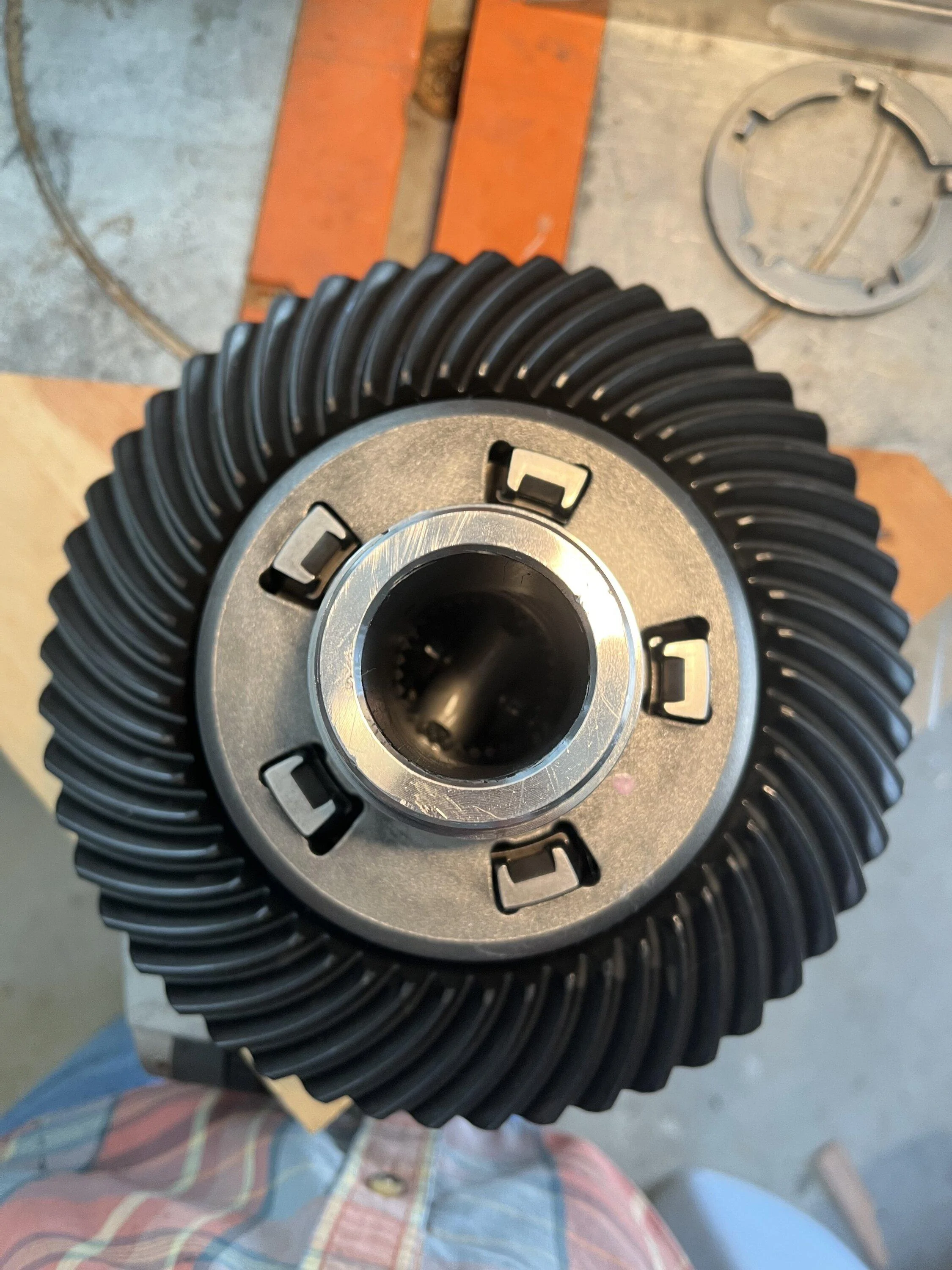

I've got the carrier on the bench, the bearing off and the new coil on. I can energize the new coil - it reads 3.7 Ohms, and it draws about 3.5A of current - so far so good. It doesn't really pull the locking plate up though. Any idea if this is normal or not? Every video I've seen so far while investigating this, the locking ring clicks and clamps up hard.
I will post some pics/vids when I can. When I energize the coil I can see it move just a bit but I can still pull it off the carrier easily (the bearing is still off). As recommended before - checking for magnetism - it does magnetize the center of the carrier (where the bearing will go). The towers/locking ring has some bounce to it when I check it, it isn't bound or anything and has free play (I think it's supposed to, looking at how it's put together here) — it could just be because I don’t have the bearing on yet too
Any feedback would be great before I stick the carrier bearing back on and make this thing semi-permanent. If this doesn’t work I’ve struck out and will start looking at other options.
EDIT - got the pics up. In the first video you can see the coil jump a little bit when I hit it on the battery (as well as hear it arc a bit when it comes off), but it isn't a strong grab. The last video is with the coil energized. I'm using a lawnmower battery while I have it on the bench.

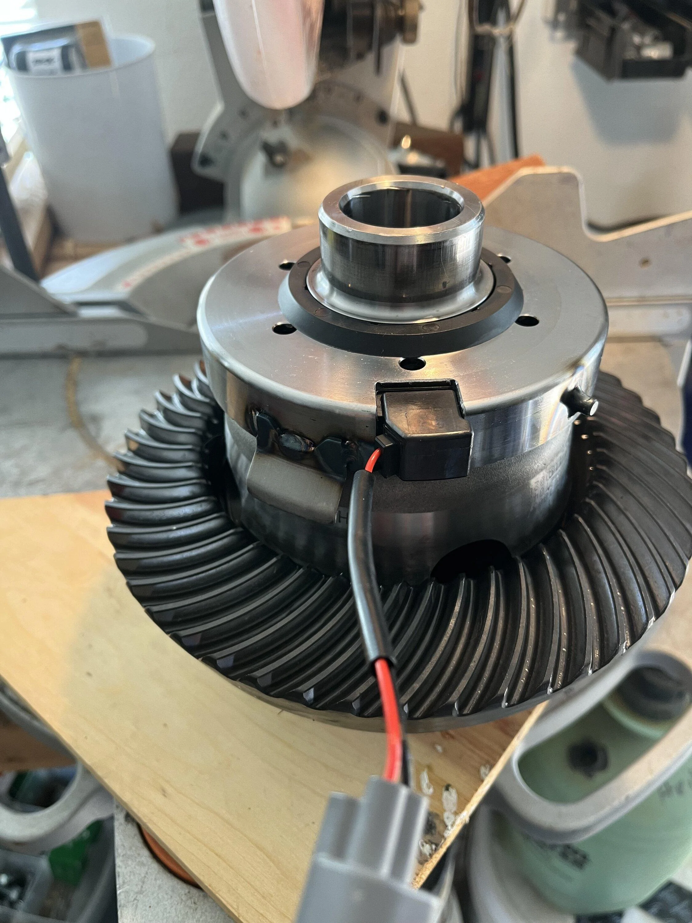

Well,
Got it all put back together. Got both tires off the ground and turned it on. I heard it click, but it didn't engage - tires spun in different directions. Tried turning the driveshaft to see if that would do anything - nothing.
So now after all of this, I'm convinced it's something with the carrier. What, I have no idea. But I have a coil that's pulling current, just nothing locking. I can't explain why it shorted/nearly shorted the first two coils out (I have a theory, but it's not terribly convincing and I only half believe it - just grasping at straws).

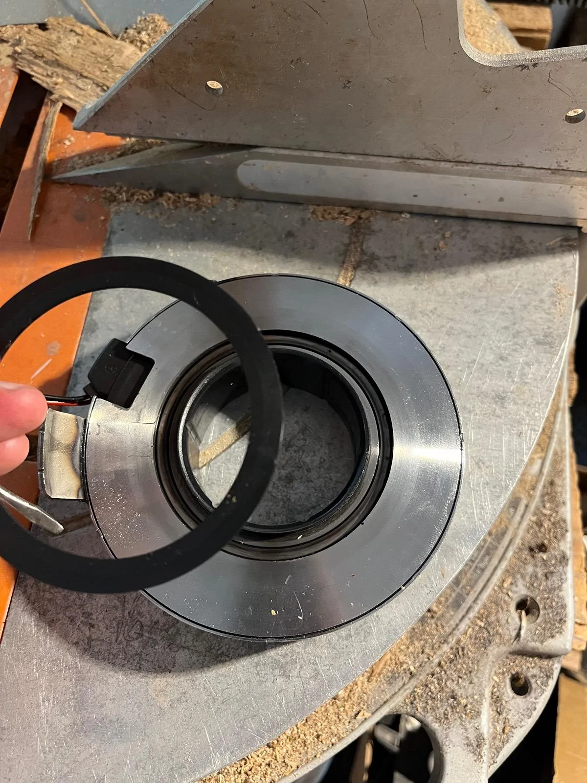

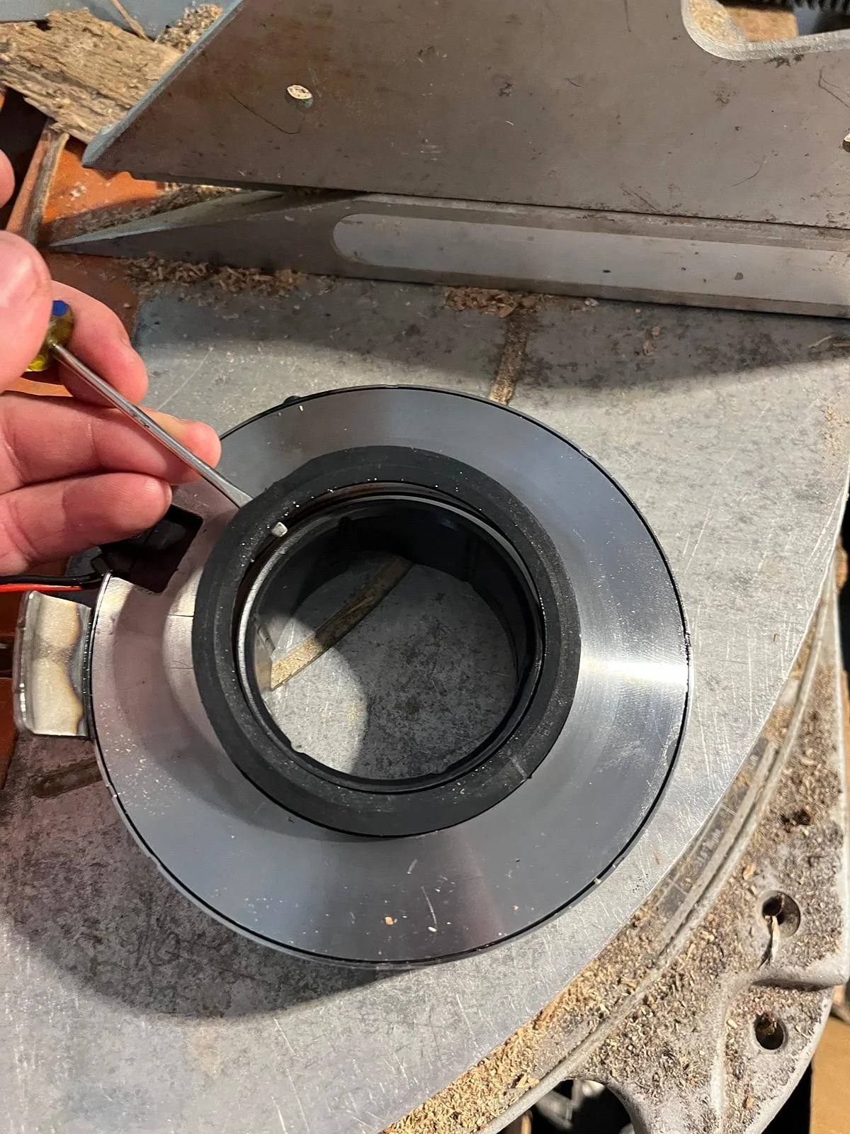

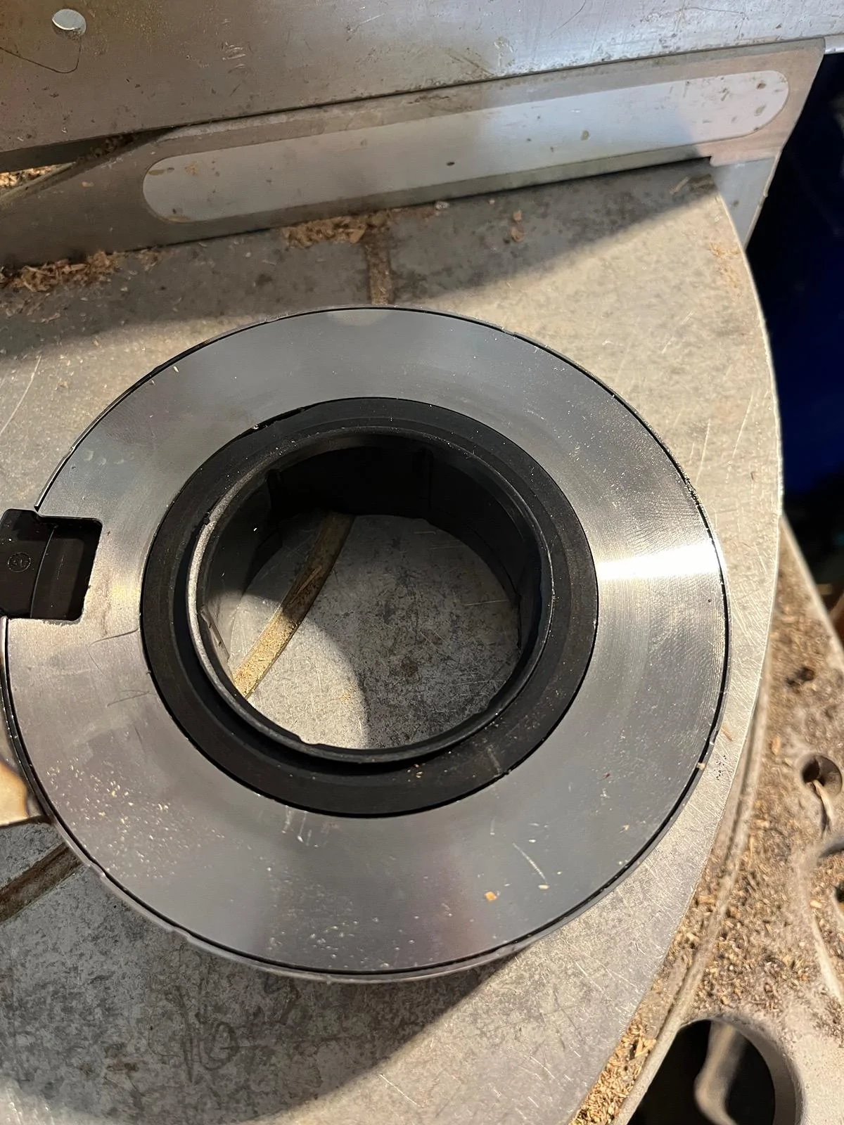

So last batch of parts finally all arrived.
This go around, I was looking at the Spicer parts list for this differential, and I noticed they list a spacer plate between the coil and the locking ring that I don’t recall seeing either time I took it apart.
So I ordered one of those, a new right side bearing, and to make sure this was the last time I was in there, I also ordered an entire new carrier and master rebuild kit (full set of bearings, shims, etc)
So I took it apart, and set the two carriers side by side. Couldn’t notice any difference. The spacer plate was just a thin plastic ring, I definitely didn’t remember anything like that before. But having the original coil still, and the latest coil - sure enough - the plastic spacer ring was stuck up in the original coil.
Just looking at it casually, I just mistook
It for part of the coil and didn’t think anything of it.
With the spacer ring - voila - it works.
Here’s a few pics of what I’m talking about
Ford Bronco New takeoff locker - I'm missing something IMG_1945
Ford Bronco New takeoff locker - I'm missing something IMG_1946
Ford Bronco New takeoff locker - I'm missing something IMG_1947
So if anyone may be interested, I have a brand new carrier, master rebuild kit with bearings and shims, a diff spreader, and a clamshell bearing puller that will be sitting around for a while gathering dust. I could make someone a heck of a deal.
