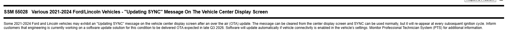

@rugedraw I started up my Bronco yesterday and got the notice that Sync is updating and will be unavailable until complete. Later I checked the updates screen and saw that is was the third sync update for "Software Update 12", but it was an error message...Not completed. Came back later to take a pic of the error message and it was gone. Back to the PCM not completed error. Will keep an eye out for the Sync retry. not sure why the final Sync update failed.
That issue I already reported to Ford a few weeks ago. It can happen to any 2021-2024 vehicle on Sync 4. They sent out an SSM to dealers about this a few days ago. Sometimes the update installs, and other times it doesn't.

Thanks for this info! Looks like they are testing these updates in production lol. Great QA process. /s

lol OTAs are a disaster for all brands; not just them. My truck is in EAP and it went through with no issue a month ago. Many people in EAP got it with no problems. Once the mass roll out started, it was hit or miss. The Expeditions were the first ones to report the problem, but sooner than later, the same issue started popping up on other forums.
