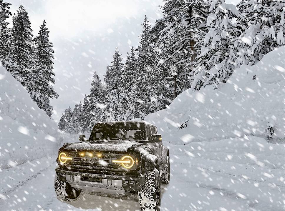

I am in the snow a lot as I head up to tahoe and have been in snow storms. Without a doubt go with amber lens, white will just reflect. I have amber fogs in the bumper now and i put amber lens covers on my baja design lp4s (not pictured here as i hadn't installed the lights yet)
Ford Bronco Need exterior light help from mountain snow goers F3B5B8E5-7AC2-4583-BD1F-E380428B4FBA

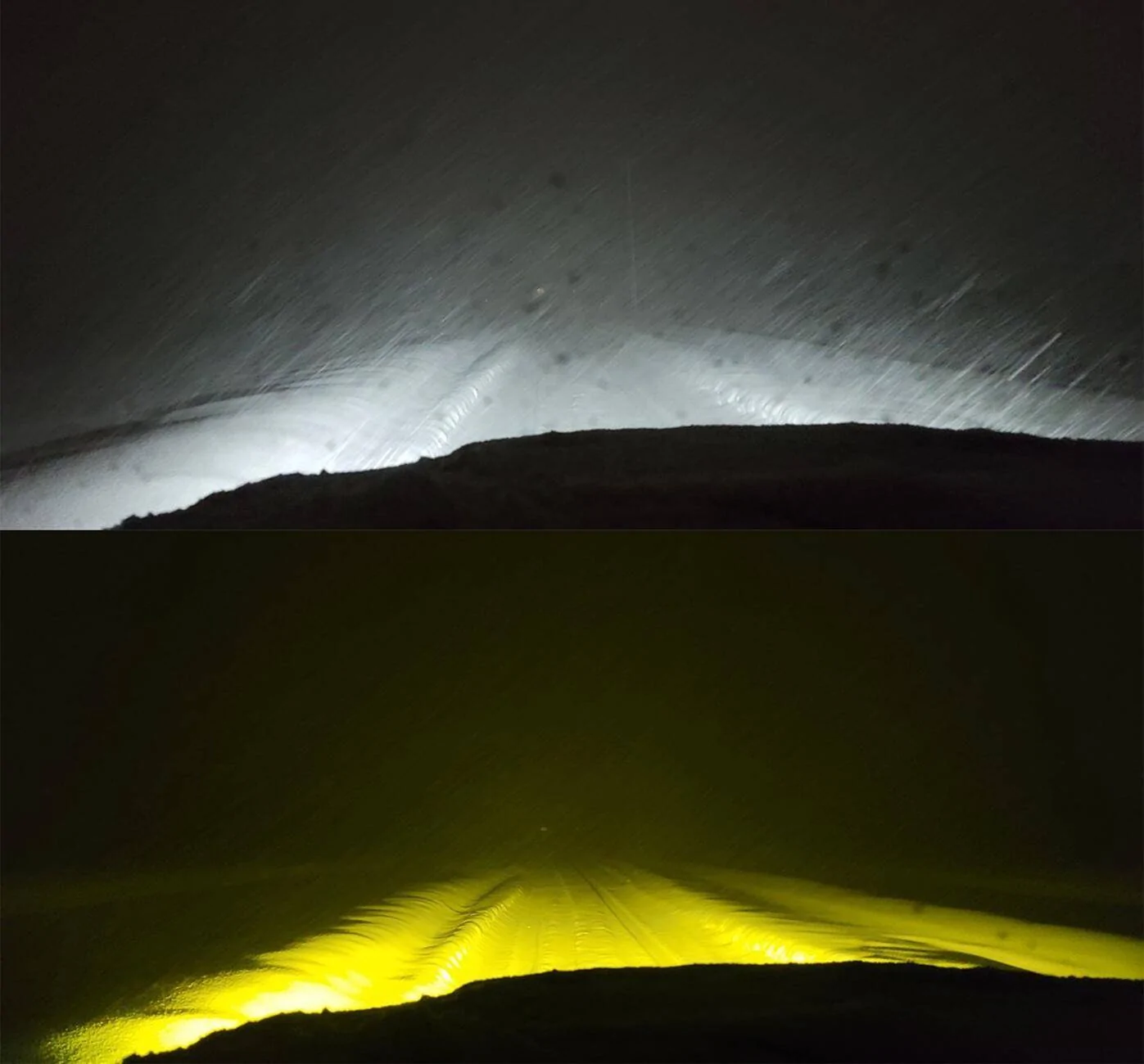

I think that's a 'capable' bumper....so just change out the fogs to any of @Diode Dynamics ambers. You need them LOW to the ground, it's an easy plug and play, just gotta pull the bumper and even an accountant can do it. Ask me how I know.
Ford Bronco Need exterior light help from mountain snow goers Inclement Weather Comparison

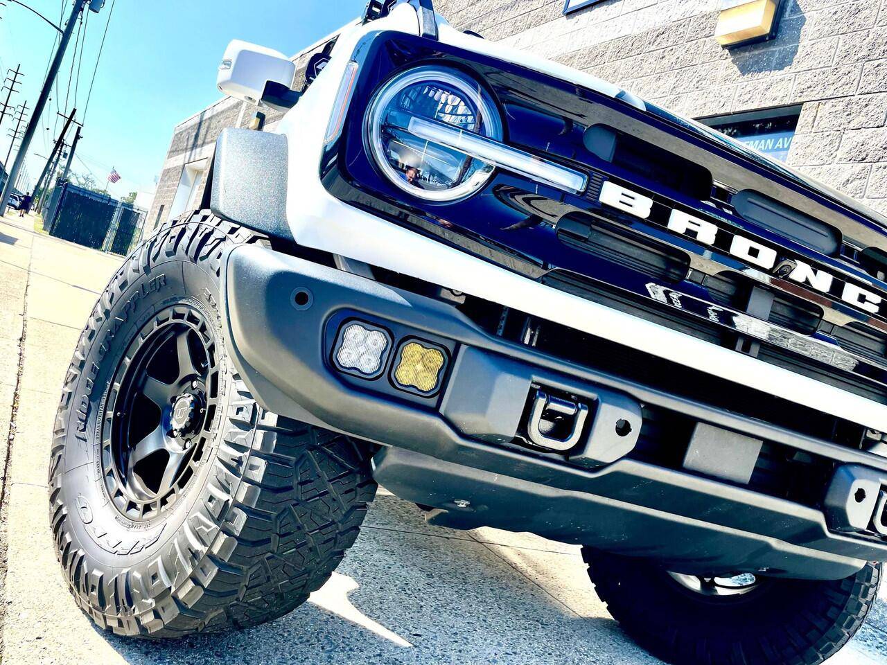

I'd recommend start with replacing your factory fogs with our Diode Dynamics Dual Fog Kit. The factory fogs are... well useless. Upgrading to our dual kit gives you some REALLY awesome lighting.
I'd do a White SAE Fog and a Yellow SAE Fog. The yellow will help with bad weather (snow/fog - cuts through better).
https://www.4x4truckleds.com/diode-...brackets-for-2021-ford-bronco-capable-bumper/
Ford Bronco Need exterior light help from mountain snow goers 1728912566103-t6

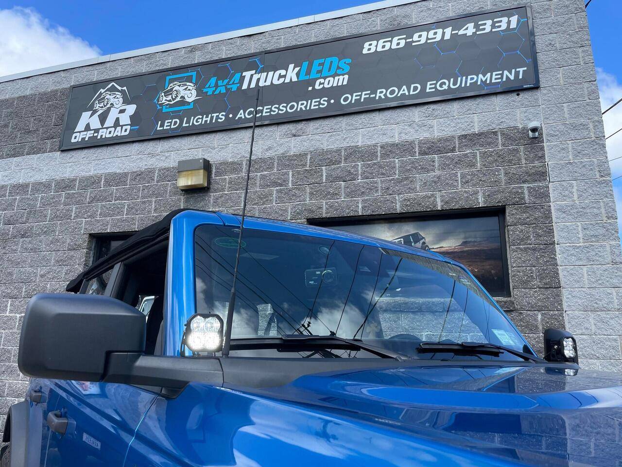

You can then add some accessory lighting like on the a-pillars/ditch lights. Not street legal BUT great for those back-roads where you want to add more lighting. The COMBO pattern is the most popular as it combines both a FLOOD and a DRIVING pattern into one. So you get a "wider spot" light down range and a light that illuminates 360 degree (for the most part) up close. Good to help light up things in front of you.
White is ideal, but in bad weather turn them off. You could do YELLOW for bad weather but honestly anything above your headlights will reflect back at you with bad weather.
https://www.4x4truckleds.com/diode-dynamics-stage-series-ss3-ditch-light-kit-for-2021-ford-bronco/
Ford Bronco Need exterior light help from mountain snow goers 1728912674192-3o
