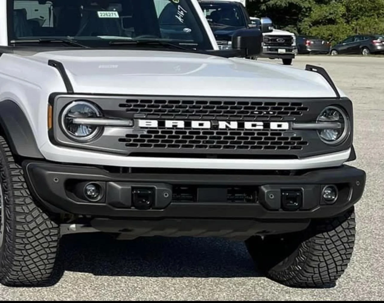

So, I have an ADD Stealthfighter front bumper on the way. It takes a 30” bar and a cube on each wing. The obvious and easy choice is Rigid… BUT I’m not looking to spend that kind of money at this point. Here are some questions (I have the factory off-road capable bumper). I like the fog light integration being that is utilizes the headlight switch. Is there anything I can do (aftermarket cubes) to retain the stock capabilities but “upgrade “ the light a bit with a cube? Is a special harness required? Also, and value minded brands that would be recommended? Please excuse my ignorance on the matter, don’t know much about lights!

Thank you for the great reply. I’ll reach out , I already have OEM fogs with the “off-road-capable bumper . So one of your harnesses could be used for the lights on the wings to adapt BD or Rigid, without Forscan (assuming here).
Correct. In your case the factory fog light connection is H11 so you'd use these harnesses instead
Baja Designs: https://www.4x4truckleds.com/crysta...gtail-pair-2021-ford-bronco-w-plastic-bumper/
Rigid Industries: https://www.4x4truckleds.com/diode-dynamics-deutsch-dt-adapter-wires-h11-h8-h9-800-881-pair/
