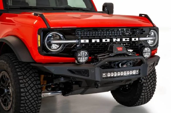

I have a Badlands and purchased an ADD winch bumper. I will have driving lights as shown and I will have a pair of fog lights and wide driving lights on each side of a front winch mount I am installing. I have 2 banger Morimotos on the A-Pillars, and a pair of small worklights on the roof rack. Additionally a winch.
The driving lights have back lights, low beam, and high beam. I am thinking of having the backlights turn on when the headlight backlights come on rather than using another switch
Switches used for lights
- Driving light low beam
- Driving light high beam
- SAE Fogs
- Wide
- A pillars
- Roof rack work lights
- (8) Rock Lights wheel well
- (4) Misc. rock lights
Bronco upfiter switches
- Roof Light Bar (?)
- Winch
- Compressor
- Cooler
- Inverter
- spare
I am thinking of a bluetooth controller for operating the lights and using the Bronco's aux switches for non-lighting functions. Does this seem like a good way to wire things or is there a better way? What are the best switches for this application- Trigger, Project X GhostBox, etc. ? Bluetooth would be a nice feature but not a hard requirement.
