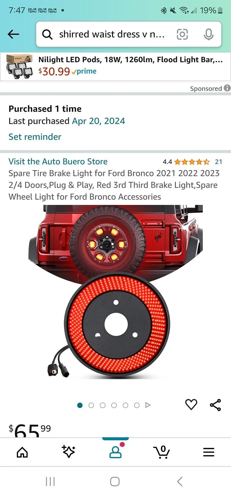

The connection plugs do not plug in to my 24 obx sas third brake light. Is there an adapter I can buy to go between the wheel light and the brake light? Or even a different wheel light? Thanks

So that's just some generic product. Those amazon sellers are usually fake brands from overseas that just re-list this for all types of vehicles. It's not vehicle specific.
We make a pigtail that plugs in-line with the tail light. It gives you reverse, red indicator (trucks running) and brake function. You could use it and extend the wiring to your spare tire and then splice it in somehow.
It'll take some wiring but at least you won't have to cut anything factory
https://www.4x4truckleds.com/crystalux-dt-4-pin-in-line-bronco-tail-light-harness-2021-ford-bronco/
Another option is just check the plug behind your tail gate. Remove the black vented panel from inside and you'll see the factory 3rd brake light wire. MAYBE it fits that. I don't know I don't recall what that connector is. Maybe that's where it goes though?
