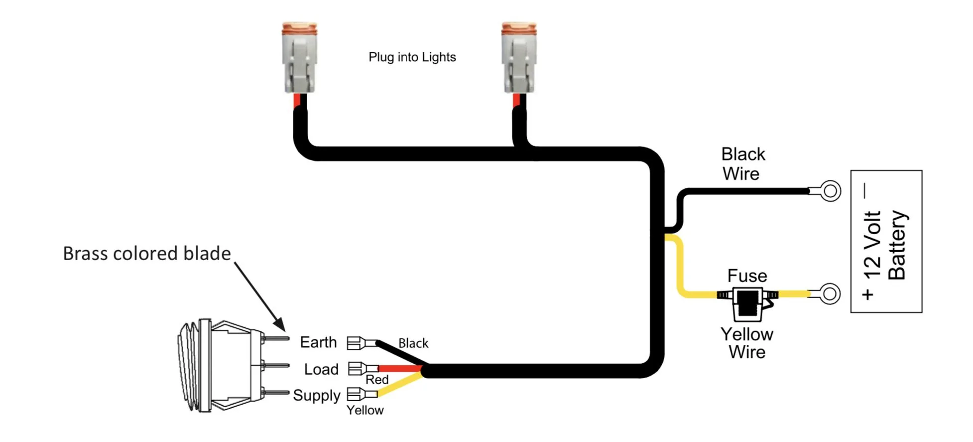

Gang: Just got my Bronco a couple weeks ago and am excited to get some lights on. I bought the Slimlites and it comes with a wiring harness. The harness has a switch built in and I’m not sure how to install this with the Bronco Aux/light switches. Anyone have an easy answer. Thanks so much

Do you have aux switches on your bronco? If so you don't need their wiring harness....find the current rating of the lights and use the correct current rating of the aux switches (my guess would be 4-6) and use the resources here to find the associated power from the aux switch to run to power the lights (you'll have to route a wire from the passengers side though to the feed) and run the Ground from the lights to any grounding point.

MAD: Yes, I do have the aux switch bank. KC comes with the harness that plugs neatly into the fixture. But then it is an octopus of wires that includes a fuse and a switch that I obviously don’t need. So I am hoping someone can tell me if I can just CUT the harness (where I have no idea) and wire it directly into AUX2. Thanks for replying! I appreciate it a lot

tie the red and yellow together. You are sending +12v from supply to the load. Basically you are removing the switch

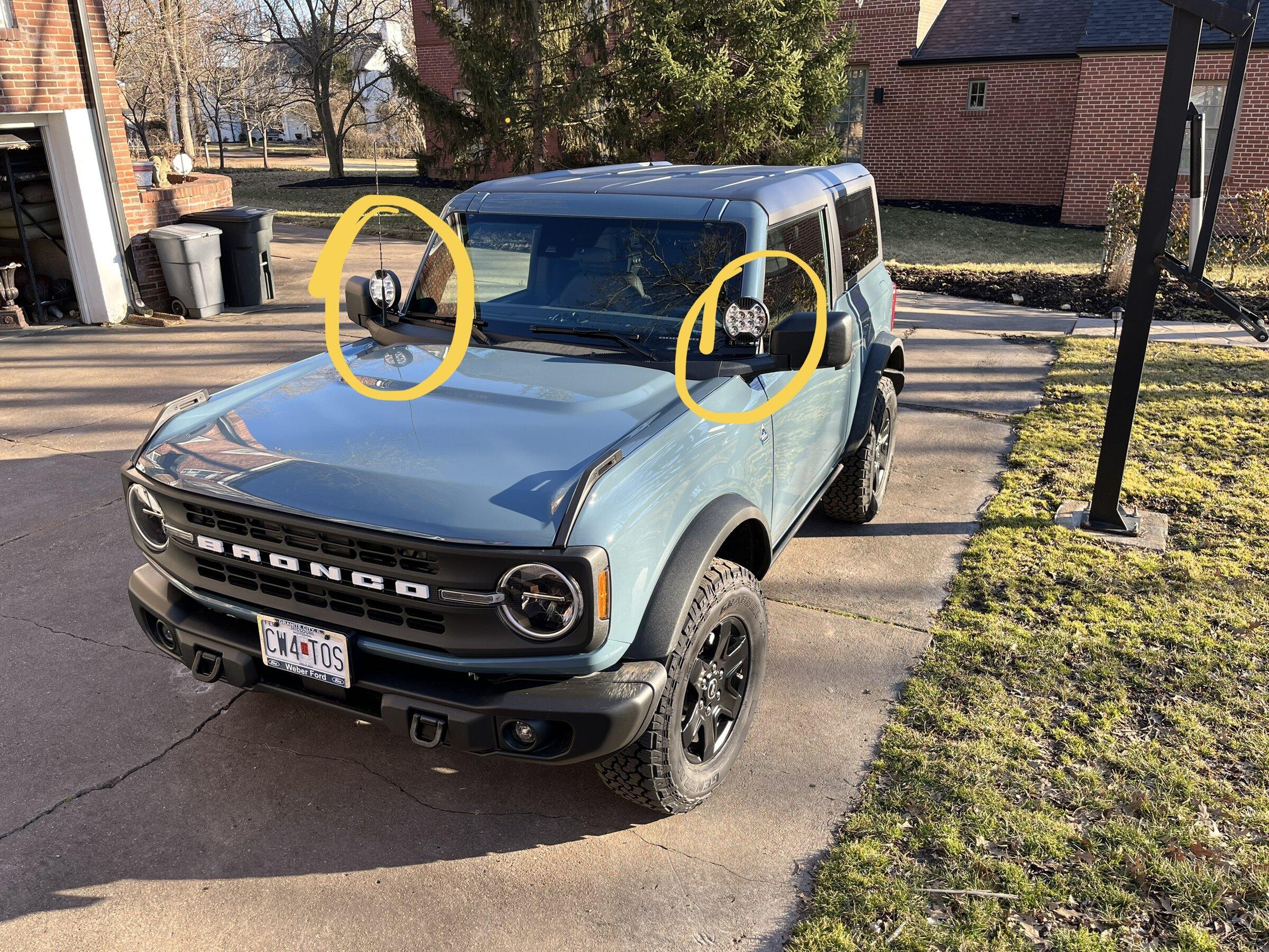

What bracket did you use to mount the lights? I can't find anything specific to KC and Bronco, and the ones I've seen for Bronco can't tell if the large bolt on the slimlites will fit.

Are you talking about the Pillar Lights - or the windshield lights. I used the same brackets everyone has been chatting about on here.
Bay Area Metal for the windshield.
I can look up the pillar mount - if you need it.

The pillar light mount is what I am looking for.

just cut the harness ahead of the switch and ground negative wire then connect positive to the switch wire you want on top of harness. I’ve done it with with my slimlites and ditch light harness from kc. no issues.

It looks like there are three wires. Which one is positive, negative, and the other is what? Hey

It is a mulit function wire, not used if using oem switches for on off

Strip back the harness at the closest point to your upfitter wires. Toss the yellow out( upfitters are already fused). Hook the red to the upfitter switch ground the earth to a convenient location or the battery. And you done enjoy your lights.

I know this is late but for future members this is all one would need to do in this application. You would just connect red wire to auxiliary switch and black wire to ground. The yellow wire in the supplied harness only goes from battery to supplied switch.
If you were going to use the supplied harness, the power would travel like this:
Battery + > Yellow Wire > Fuse > Yellow Wire > Switch Supply > Switch Load > Red Wire > Light 1 and Light 2 > Ground
So when using the Aux Switches, they are already fused and have our switched load under the hood. You then eliminate all before the red wire, connect red wire to Aux Switch wire of your choice and connect the ground to battery negative or a chassis ground connection.
Hopefully that helps in the future for other members.
