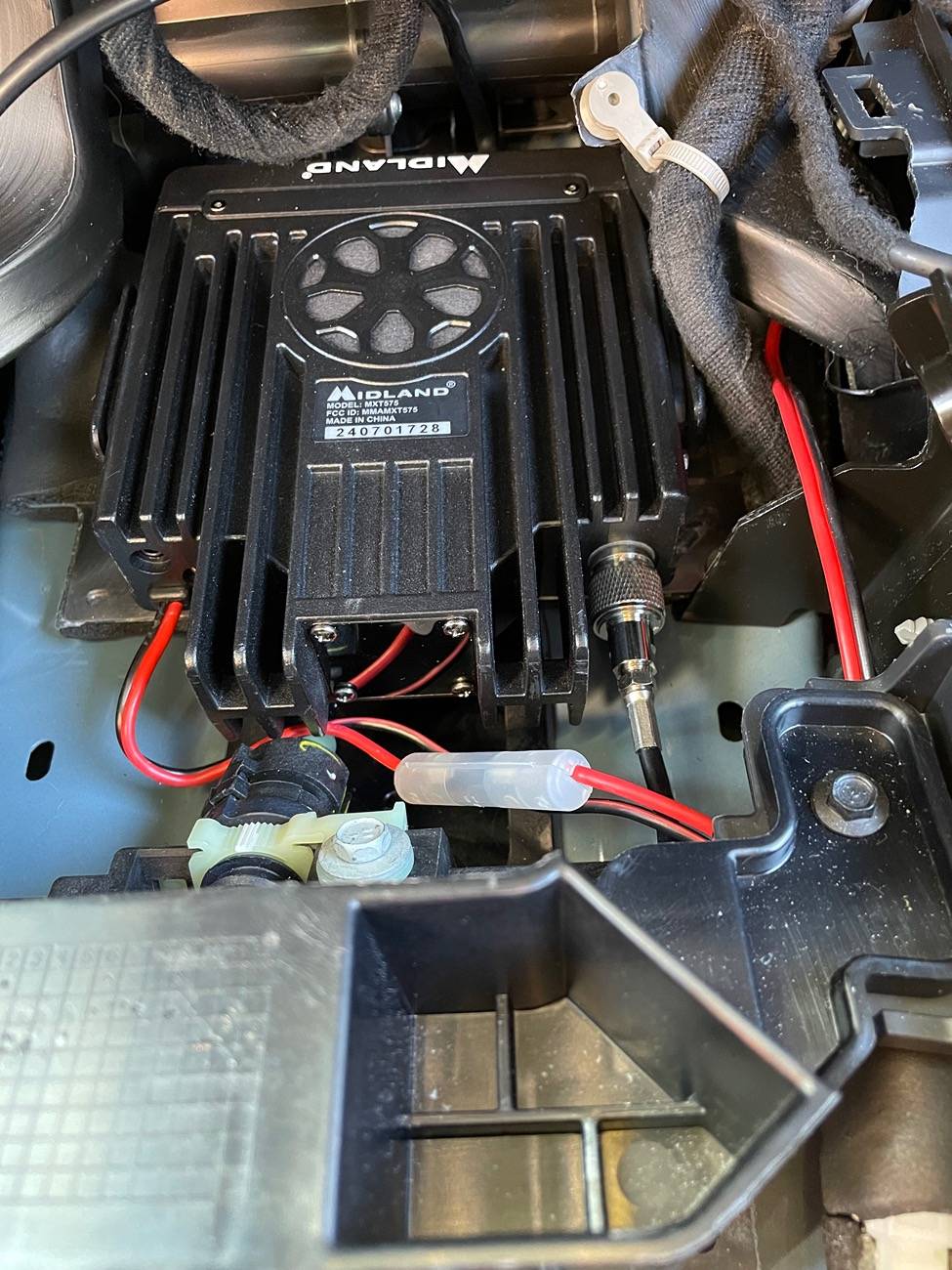

Why are you having trouble?
Hopefully in the last 6 months they have got it mounted :wink:
I too couldn't mount the 575 as shown in the posts here, my Bronco has ducting for the rear which limits space under the console- but I did manage to mount it there.
I posted details here: Link
I tried everyway possible way/angle and could not get it into the space to screw it down. Went with under console and it took 30 min to install.
Ha, was traveling for work and could not respond until this am.

Ford Bronco MXT575 Under Center Counsel Install? IMG_5102
The MTM bracket is under my radio, it wouldn't fit as shown in previous posts due the the HVAC Ducts on boths side of the center console.
Yes, it definitely a counter-intuitive mount, but that's just the way it has to be. But once you find the right spot it goes right in.
https://www.bronco6g.com/forum/thre...metal-bracket-and-67-designs-mic-mount.70922/
The challenge is that the pictures of the install are upside down so you have to get re-oriented.
