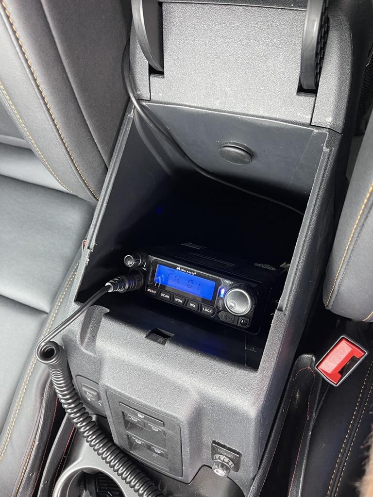

This is where I installed my Midland MXT500, antenna wire ran to the back, once I get tire carrier and place properly mount will come in from underneath.
