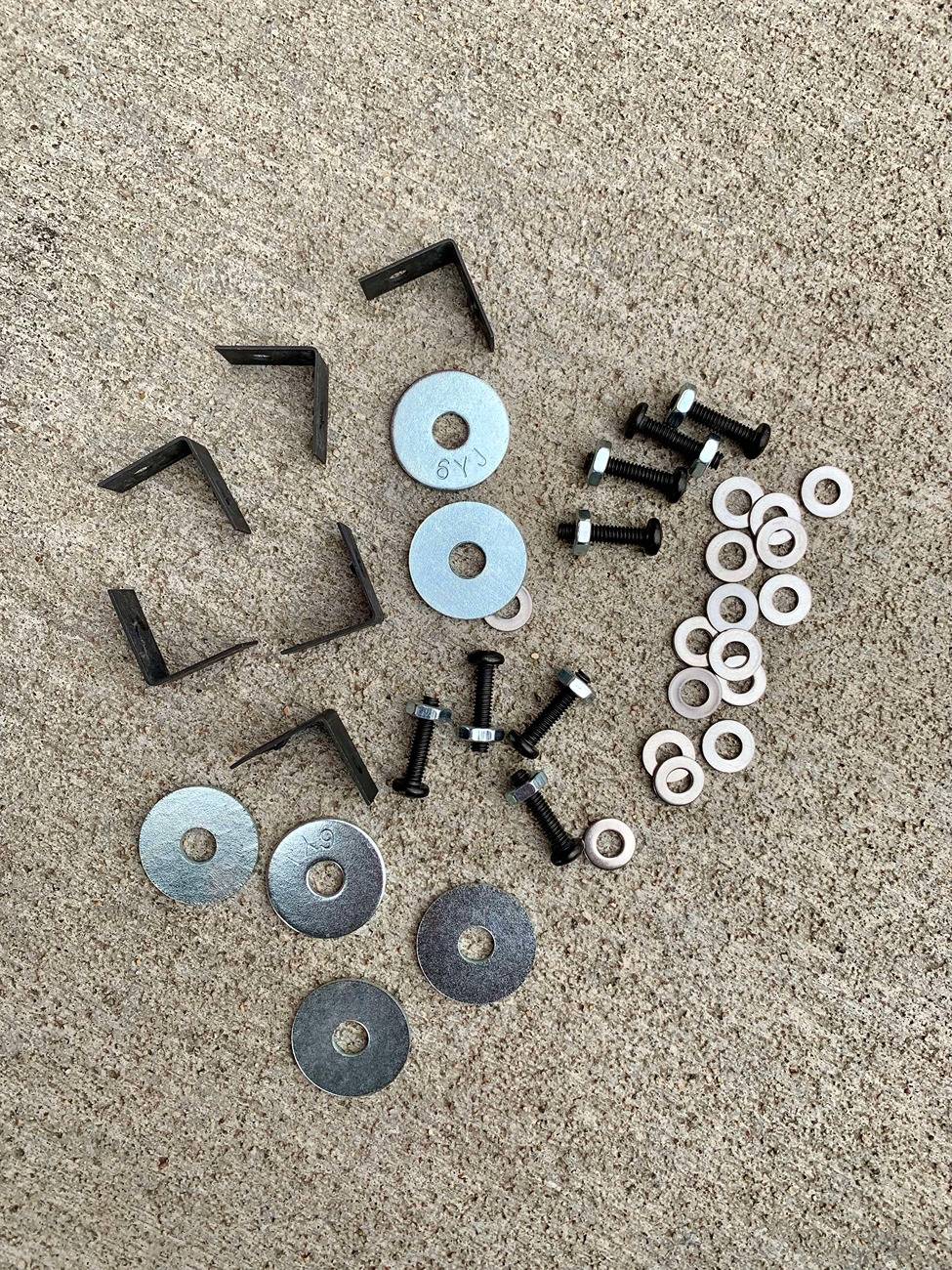

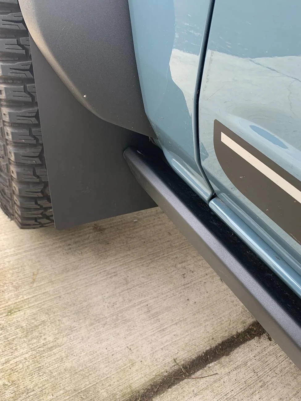

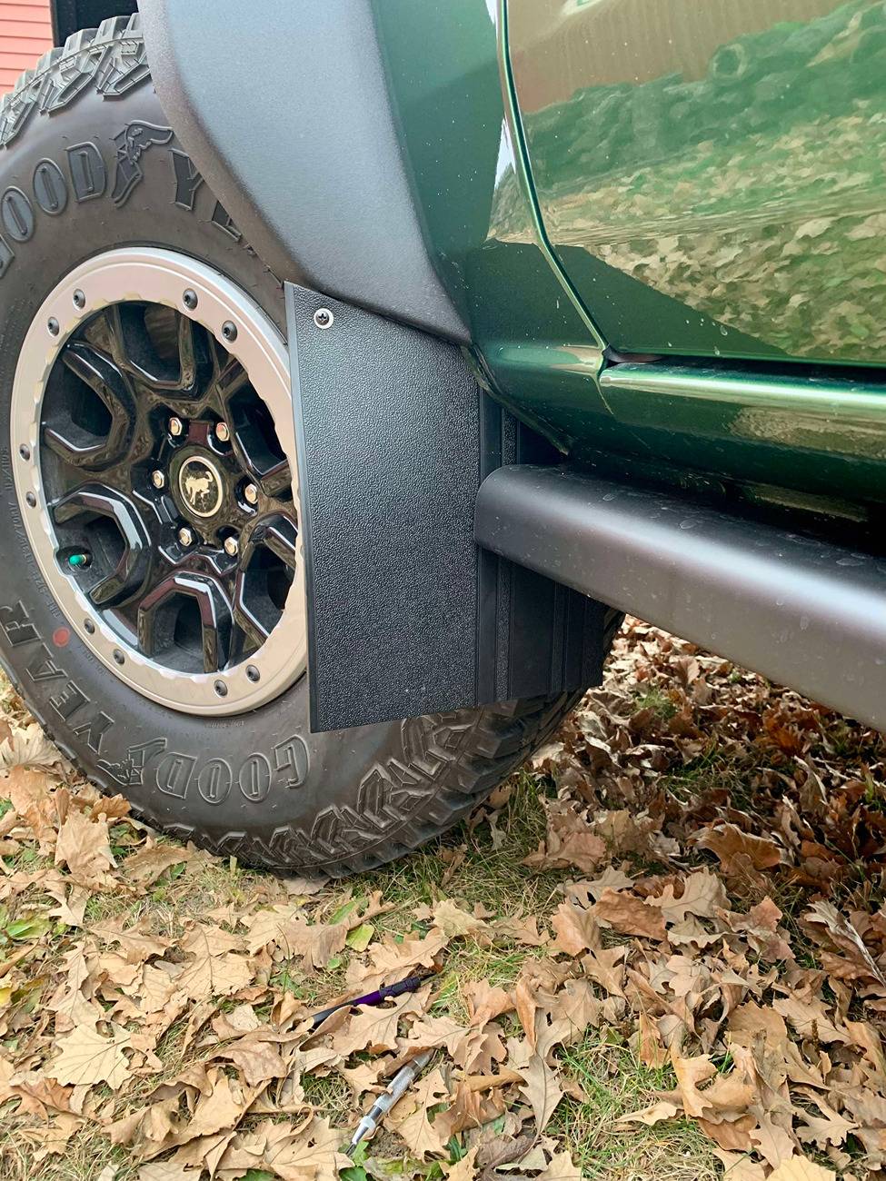

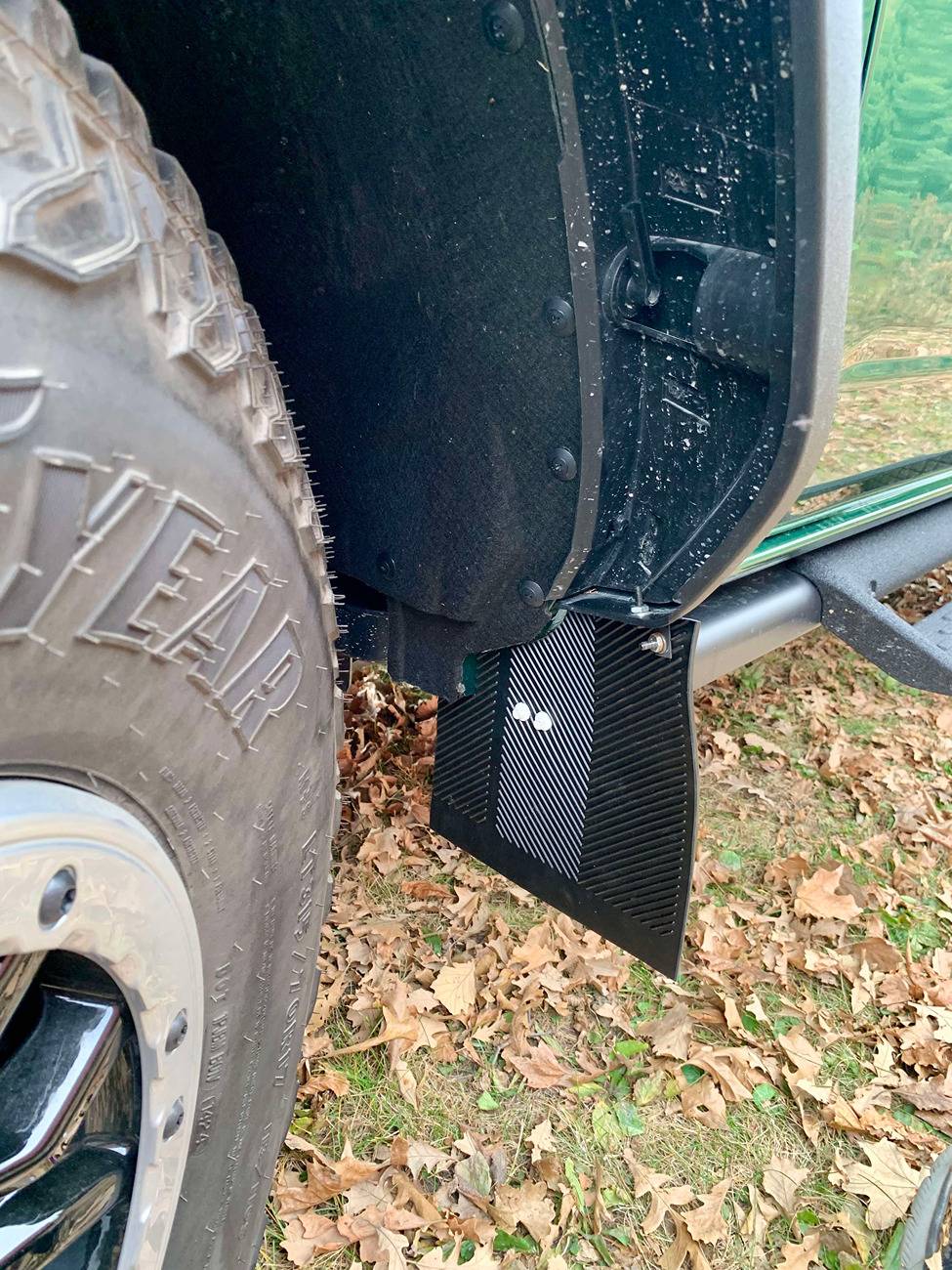

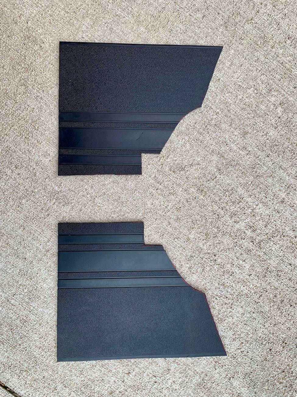

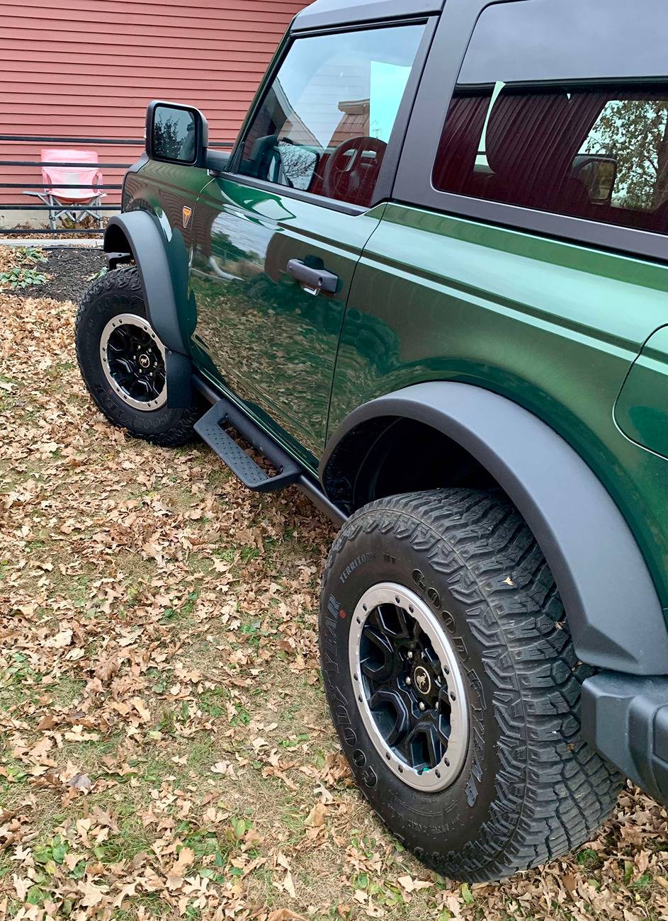

Made a pattern using card board. Bought some generic rubber mud flaps. Drill 2 holes in rock rail plastic end cap. 1 bolt under it to remove it. A couple of L brackets and a few screws and washers. Drill one hole in bottom lip of fender flares. Used sheet metal self tapping screws to screw into rock rail end cap. Best part is you can make what ever shape or size you want. Trim a little to refine it if need be. (touch up screws with flat black paint)

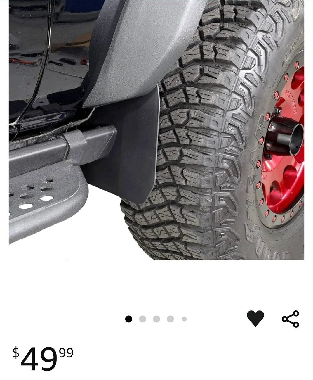

I've had these for a long time and I really like them.
IAG I-Line Rock Rail Side Mini Mud Flap (2pc) for Ford Bronco 2021+ 2/4 Door (Not Compatible with Hoop Step Rock Rail Option) https://a.co/d/bSQ4Wox
