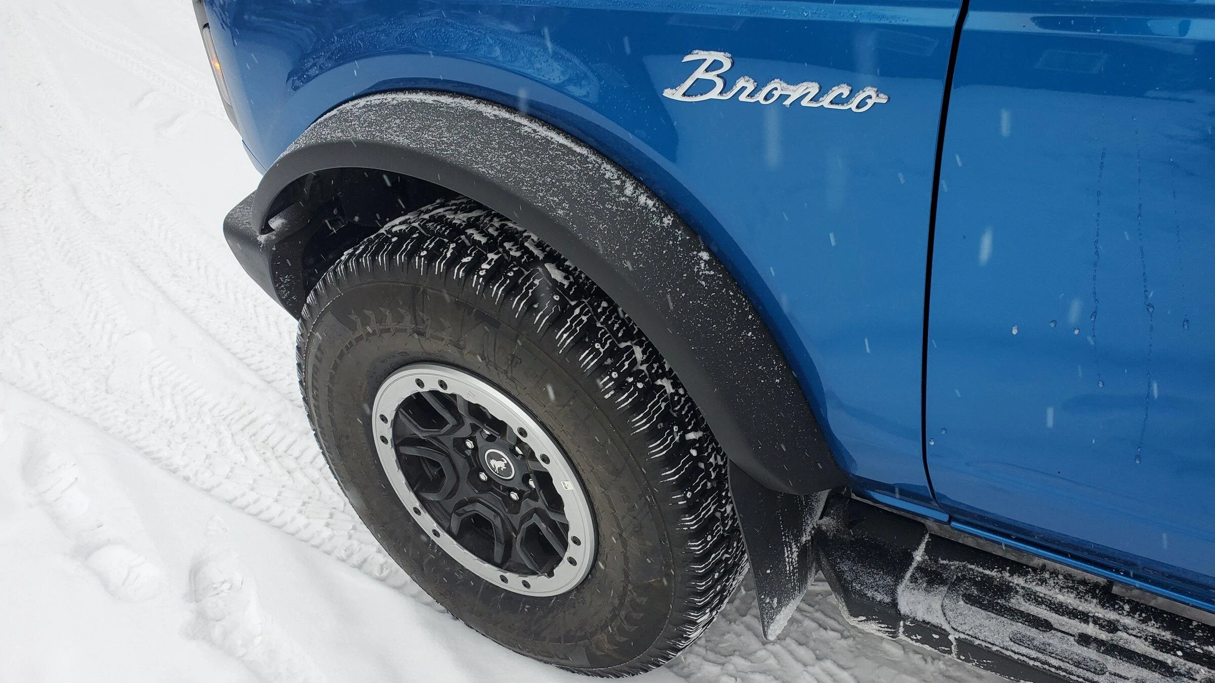

My solution, a cheap universal flaps cut to fit.
Ford Bronco What Mud Flaps / Splash Guards With Wildtrak? 20211125_125324
