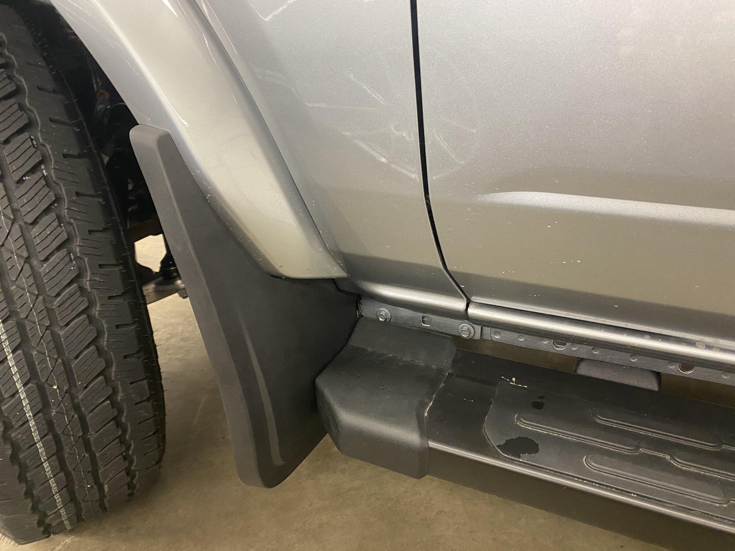

I’m trying to find front mud flaps that will fit my soon to be delivered Outerbanks. It appears that the sidesteps interfere with the Ford splash guards. Any suggestions for other options?
Please find below picture of Ford Mud mud flaps with the Tube step that comes on the Outerbanks. You can do this with a drill , dremel and a file by moving the mounting holes in the bottom of the tube step. .

actual was 1-1/8”

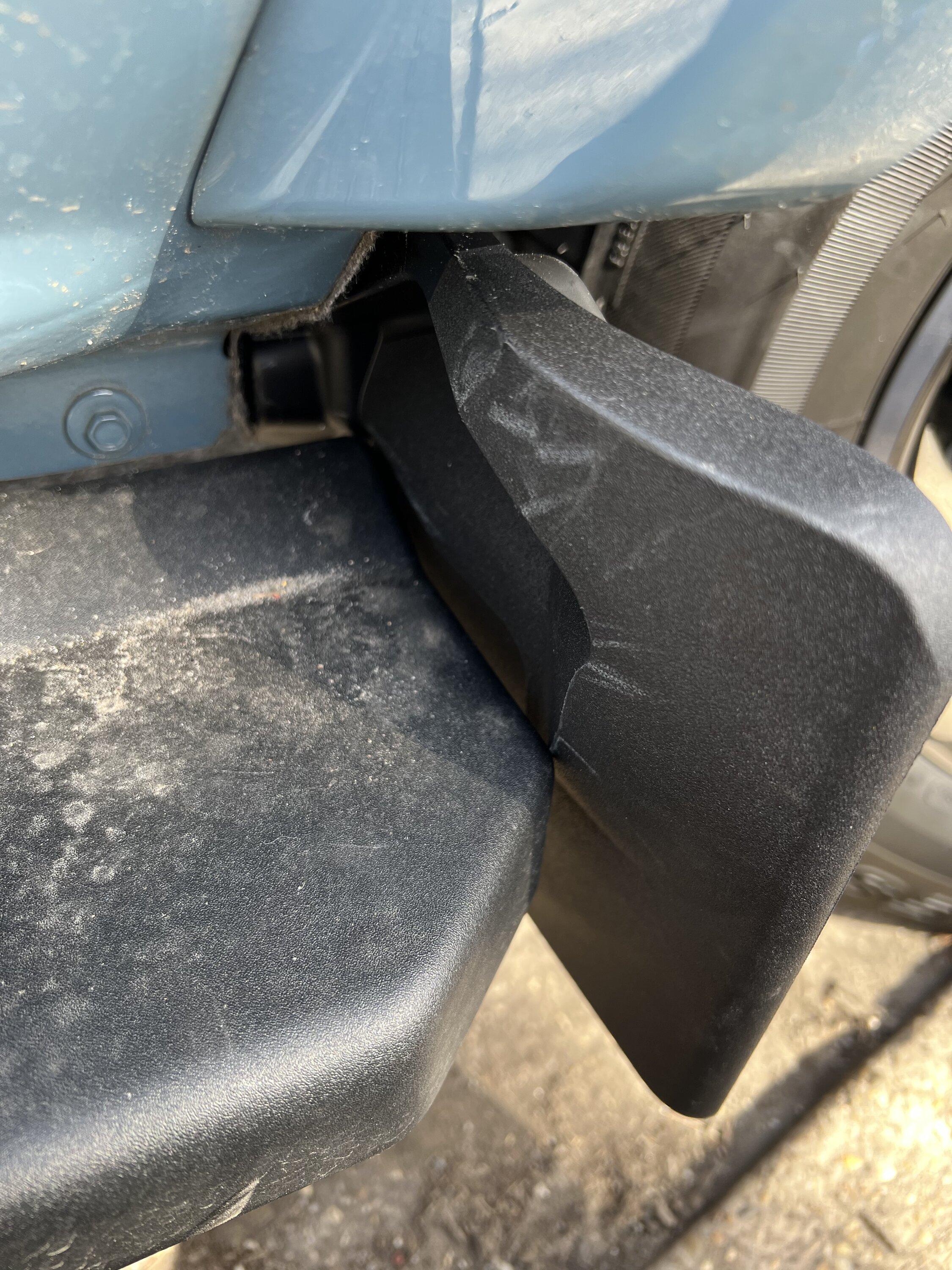

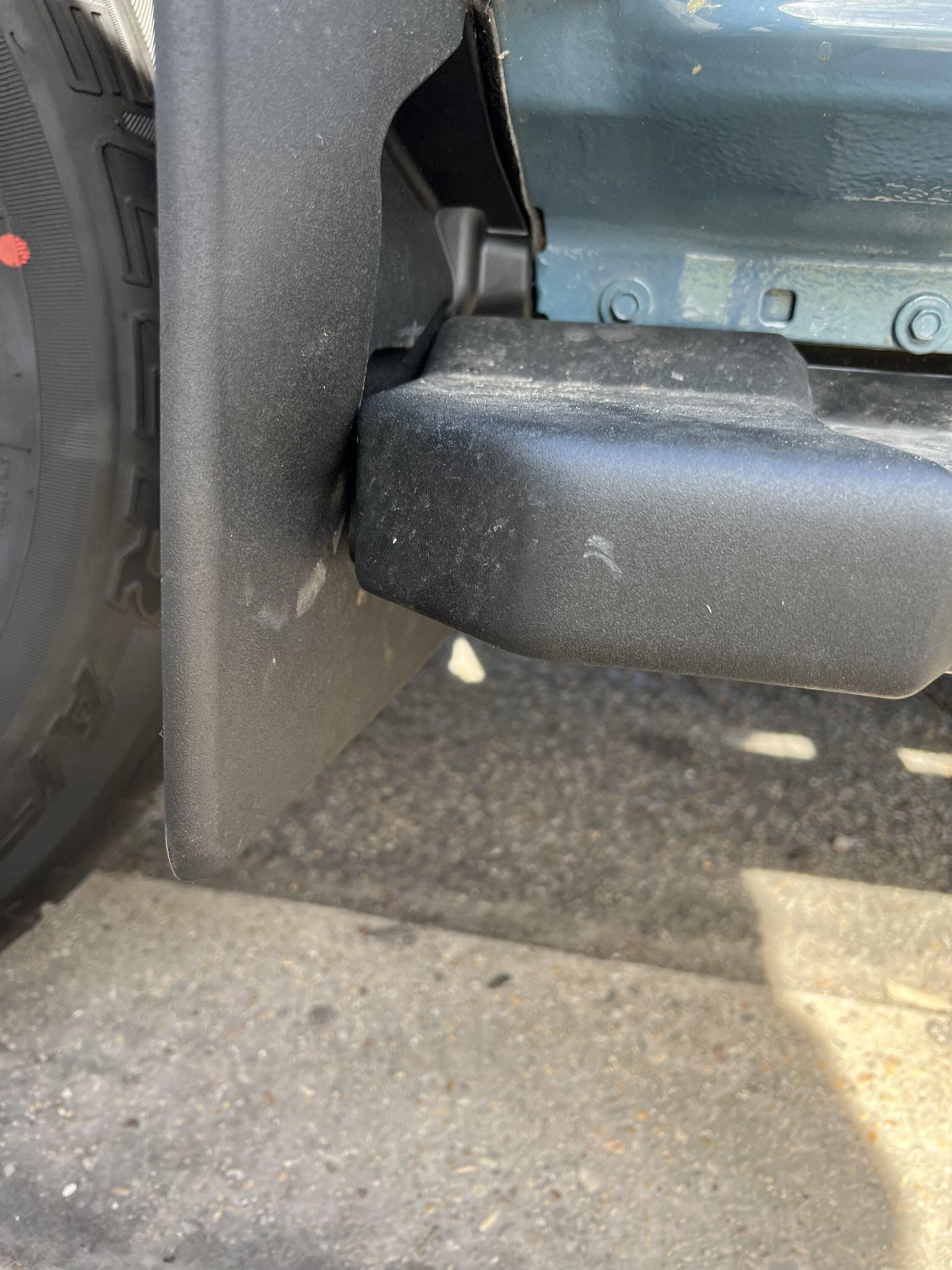

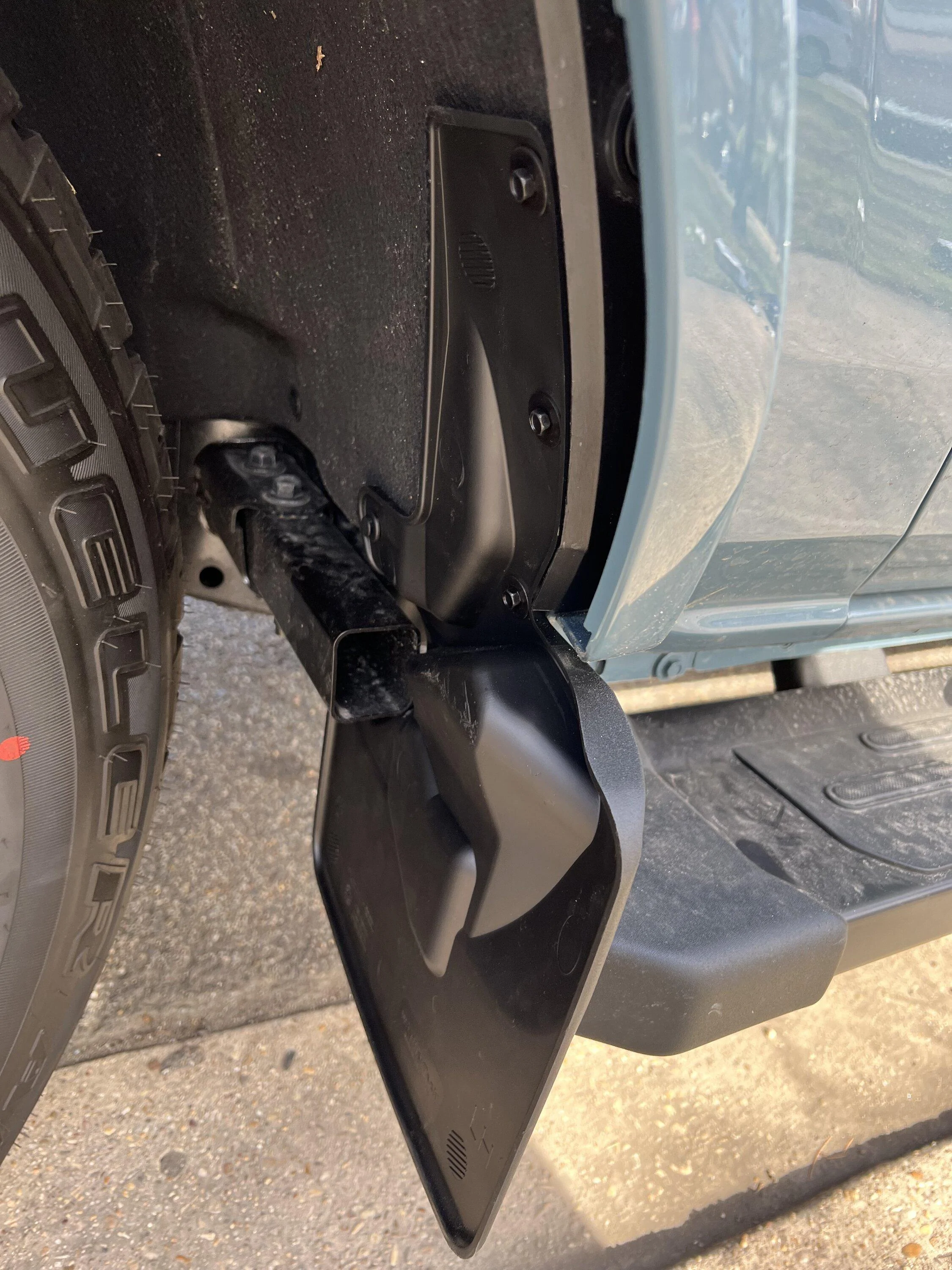

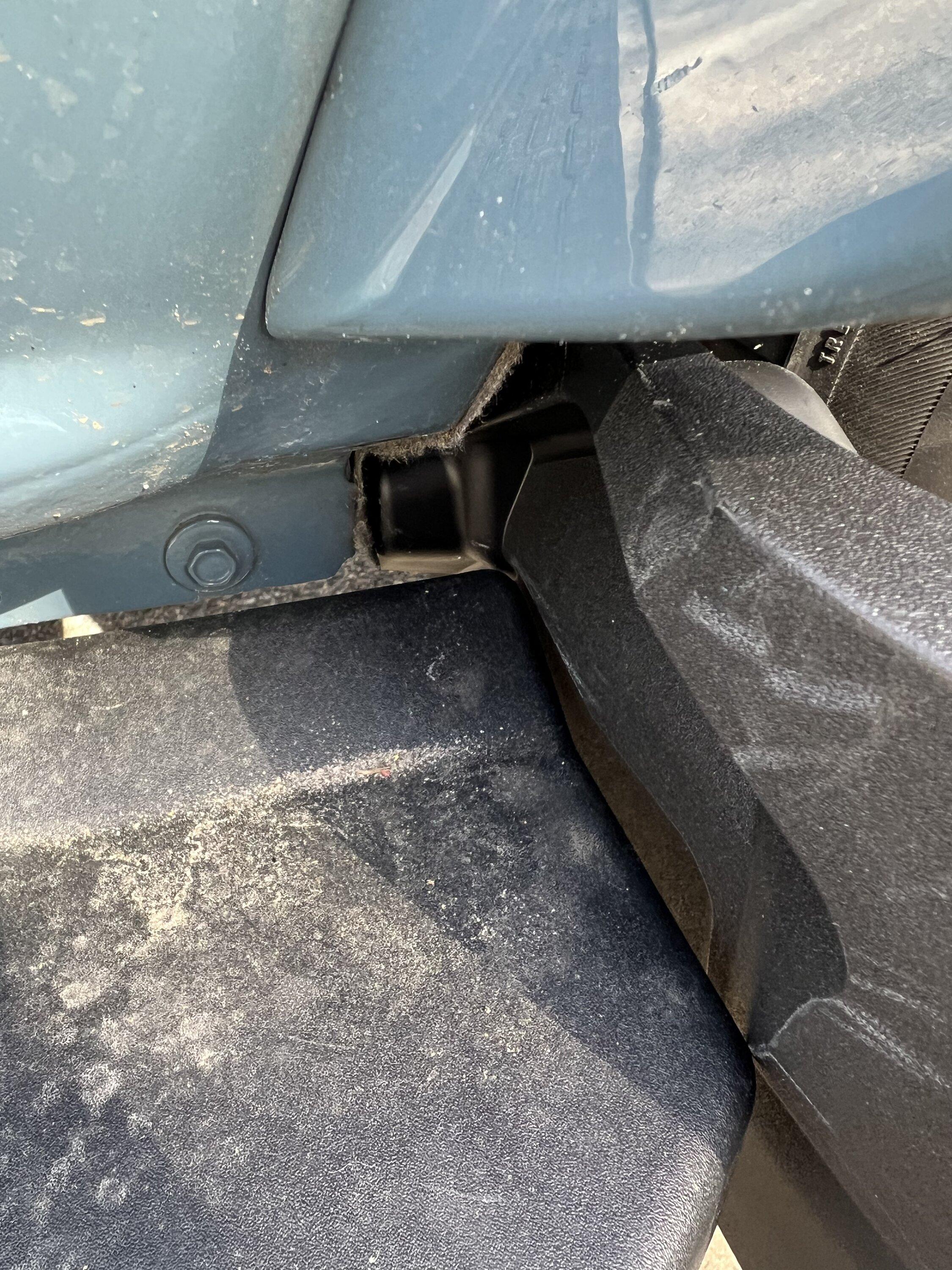

How did you get them to fit properly? I’m assuming yours is an OBX based on the flair? I attached mine yesterday, but had to remove the OEM tube step on my OBX and it doesn’t fit quite right.
