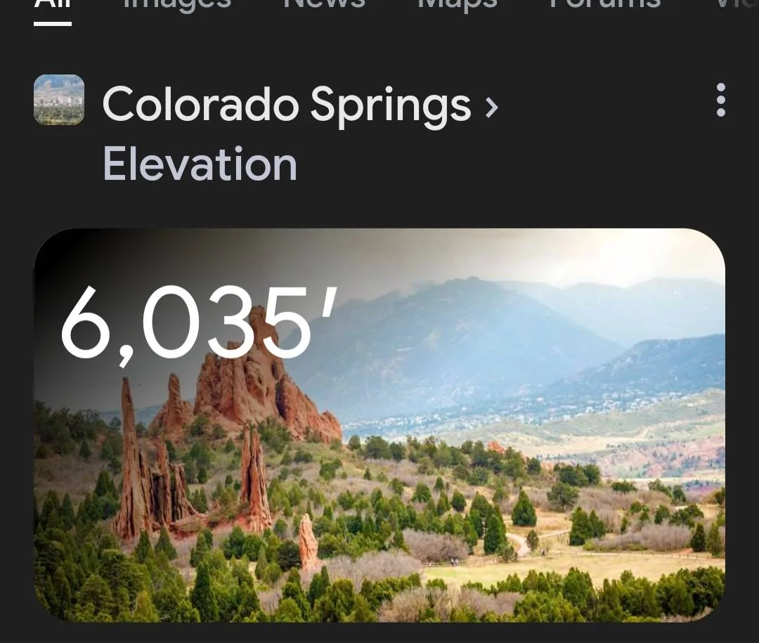

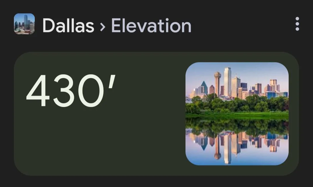

I moved from Dallas Texas to Colorado Springs and in Dallas I averaged like 18.5 to 19 mpg, since I have moved to Springs I am getting like 14.5 to 16 max? I thought being in cooler environment for turbo would be better??

Also note which one of those images has plenty of mountains and hills in it... and which one has... well... none of that.
Dallas is flat, boring, and close to sea level. Good for fuel economy.
I did a road trip recently to Michigan from the New England area. Driving through the Pocono Mountains of Pennsylvania I was averaging around 20.4 MPG on the highway. Once I got to Ohio it jumped up to 23.9. Same thing you are experiencing, Ohio is flat and boring.
🤣 :oops: 😂 :LOL: 😁 :unsure:
I have to laugh, my house is about 28 feet above sea level, of course my town goes right down to sea level.
I know it's all relative, but 430 feet is like being in a skyscraper :eek::rolleyes:o_O

With the elevation change you have a drop in atmospheric pressure. That effects the power and efficiency output of your motor.

Thanks Guys I figured it was the elevation but was just making sure, I use the mid grade gas here which is 87, I tried the 85 once and the Bronco did not like that so got that out asap.. :)
