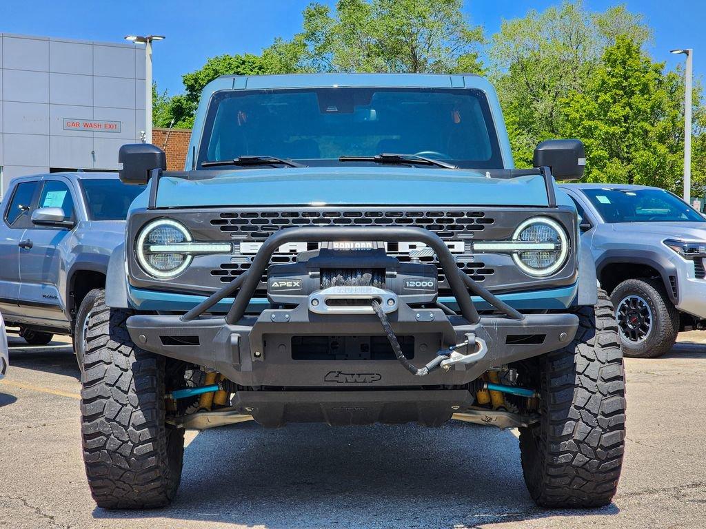

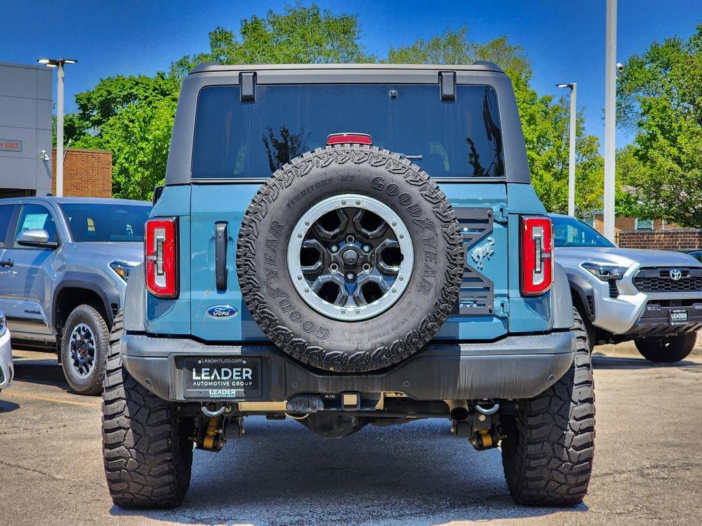

BTW, I'm not convinced those fender flares were swapped for non-Sas flares. The photo angle is too far off to make that call, even though it looks like a possibility. That is a rare type of swap for sure.

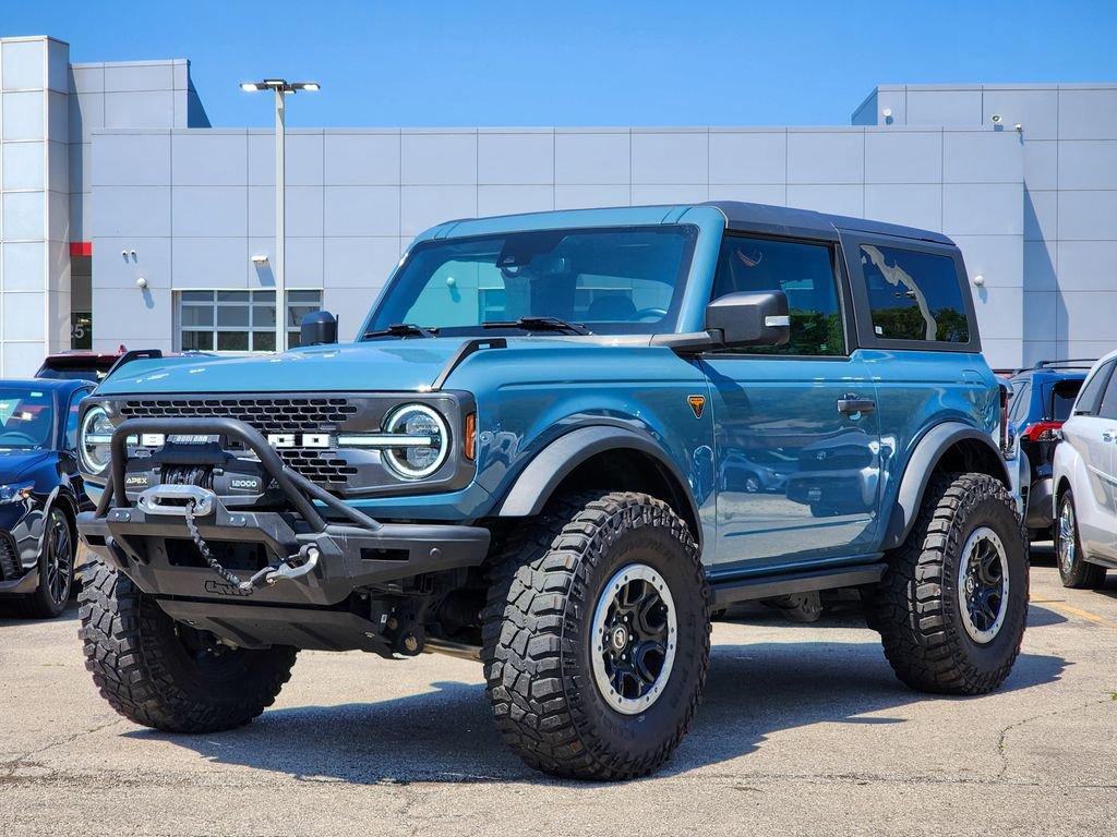

Here's a front facing and rear facing view if this gives any more clues:

I see the stock yellow Bilstein Sasquatch shocks, so only suspension upgrade from the pic are the tie rods. Likely nothing happened, guy just got paranoid from reading all the drama here on Bronco6G! :ROFLMAO:
Front bumper swap isn’t a big deal and looks good. I doubt that thing has seen a day of dirt, or at least not much.

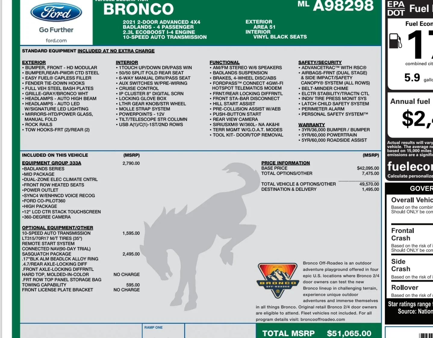

Window sticker for reference. The VINs do match on this sticker and the door panel sticker.
Wrong transmission otherwise you are good :) . Nice ride.

That front end alignment looks all f'ed up. Get it checked. It's definitely going to need new tires.
Ford Bronco Moving Up in the World IMG-05c6bbd49ed9171086c562b03d235171-V
Ford Bronco Moving Up in the World 1000007228
That alignment looks jacked up.

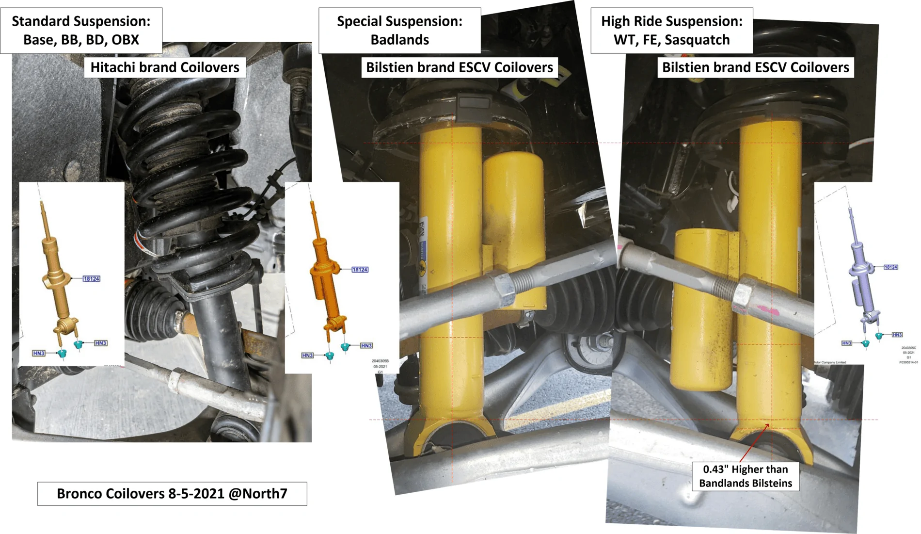

As far as the shocks, you are good to go.
Ford Bronco Moving Up in the World 1628166169031
Notice the orientation of the shock reservoir on the Badlands and the Badlands Sasquatch shocks?
Ford Bronco Moving Up in the World 1000007196
It (on second look) appears to be a Sasquatch shock. I had to look side by side to really tell.

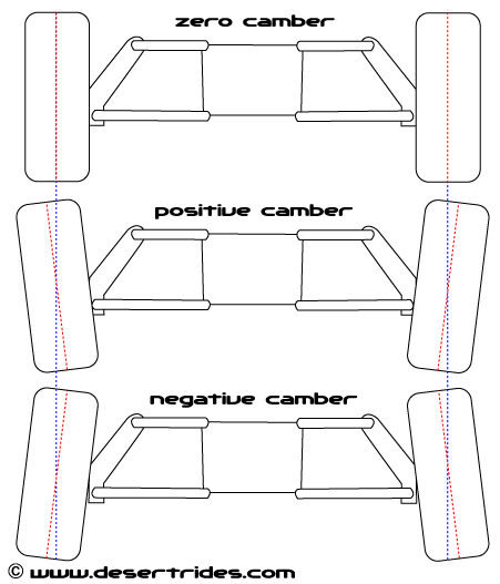

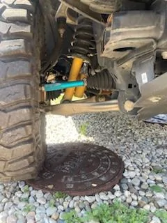

The alignment definitely looks strange. The Camber looks way too positive. A slight positive camber is good for off-roading. But this one looks way too much. Hard to believe an alignment shop would leave it like that
From your first photo I think it also has a leveling kit (front-end lift.) Another reason for the alignments.
Not a bad thing. We have leveling kits in ours

It looks like it has wheel spacers to push the stock wheels/tires out that far past the flares (even though they aren't the Sas flares). That alignment does need some help for sure.
Based on the front tire wear and that alignment, be prepared for it to drive a lot rougher than your Bronco Sport. That can all be adjusted/fixed but the 2 door rides a bit rougher to begin with because of the shorter wheelbase and that front end looks like it will be even rougher. Maybe see if someone here is close enough to take it for a test drive for you to get an honest opinion.
