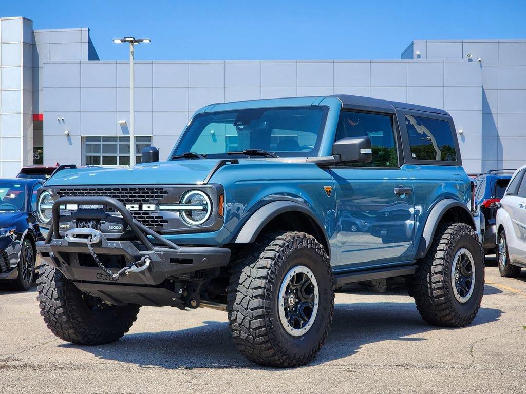

Hey y'all. I'm a current Sport Badlands owner from NC who has been searching for a Bronco Badlands for a bit now. I love my Sport dearly, but really want the added capability of the full size to do more technical rock climbing and some more difficult trails. After all, it's about smiles per gallon, not MPG.
I found a used 2 door 2021 Badlands with Squatch and low miles at a dealership about 11 hours away from me, and the price is exceptional - Less than $40k. I've spoken to the dealer for the past two days and it seems to be the actual price. I even pressed about dealer addons, which they guarantee me there are none of. They gave me my out-the-door price in writing and nothing seems to be shady. It's got a ton of aftermarket upgrades and looks to be in fantastic shape, plus the Carfax is clean. I went ahead and reserved it and have already started applying for financing.
I'm left wondering what would cause a Badlands with Squatch to be listed in the $30,000s. What's the catch?
I've heard the 2.3L is a pretty reliable engine and the Badlands is super fun to drive. Are there any watch out situations I should be on the lookout for before I head up north and purchase this Bronco? Are there reasons an owner would add expensive modifications to a vehicle and decide to let it go before 25,000 miles? Is there a common flaw in the 2021s that would encourage trade-ins? The dealer claims there simply isn't a huge market for Broncos in their area, but I'm still skeptical. I want to be realistic and listen to those who may be able to give me the insight to pounce on a great deal or avoid a horrible one. Thanks in advance!

Pictures look good, that's a nice looking Bronco.
I see nothing that would worry me from the information provided. I'd check the vin tags and look for signs of body work. Just because the cax fax is clean doesn't mean it hasn't had extensive work done.

It is going to need tires. If it has wheel spacers, they need to go. Also what size and make are the tires currently on it? Looks like Cooper STT Pro's but I can't read the size. I would not be surprised if they were bigger than the factory Goodyear on the back of the Bronco, I suspect that they are 37s.

It looks like it has wheel spacers to push the stock wheels/tires out that far past the flares (even though they aren't the Sas flares). That alignment does need some help for sure.
Based on the front tire wear and that alignment, be prepared for it to drive a lot rougher than your Bronco Sport. That can all be adjusted/fixed but the 2 door rides a bit rougher to begin with because of the shorter wheelbase and that front end looks like it will be even rougher. Maybe see if someone here is close enough to take it for a test drive for you to get an honest opinion.
Any Bronco is going to ride rougher than the Bronco Sport. The two door does ride a little rougher than the longer wheelbase more door, but the good outweighs the bad, as you get a very nimble Bronco. You give up a tiny bit of stability for agility... That said, I love having the 2 door.
Kinda like comparing an F-16 with an F-15. Both of them are great, but that little F-16 is so agile and turns on a dime... The F-15 turns on more like a nickel.

Otherwise, new tires & alignment and setting it up correctly, spacers removed or whatever may be all you need to do to have a mighty fine Bronco at a good price.
And 2 doors rock on tight trails and turn a tight U-turn too. I think they handle on road just fine for a heavy brick of an SUV. I love the 2.3, plenty of power compared to my last truck, a V-6 Tacoma.
Don't add too much value to the mods, the winch looks to be a Harbor Freight winch with a aftermarket bumper, somebody went for looks. Those blue tie rods could have been just for looks too or after they upgraded to tires to bigger, but with the cheaper aftermarket parts I'm betting those blue tie rods/sleeves were for looks more than function or repair.
