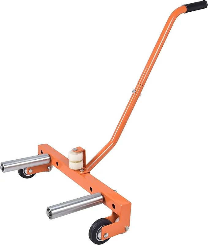

Have been considering this tire dolly but doesn't help much for spare mount/dismount.
My current solution is my teenage son but he will heading off to college soon🙂. I've had knee replacement surgery on both knees so I am also looking for a solution. Considered your tire dolly recommendation but that particular one has almost 20% one star rating with complaints of breaking. Here are two other options I'm looking at though more expensive. (Get what you pay for.) They appear better built. One even looks like it is for tractor trailer wheels and rated to 485 lbs.

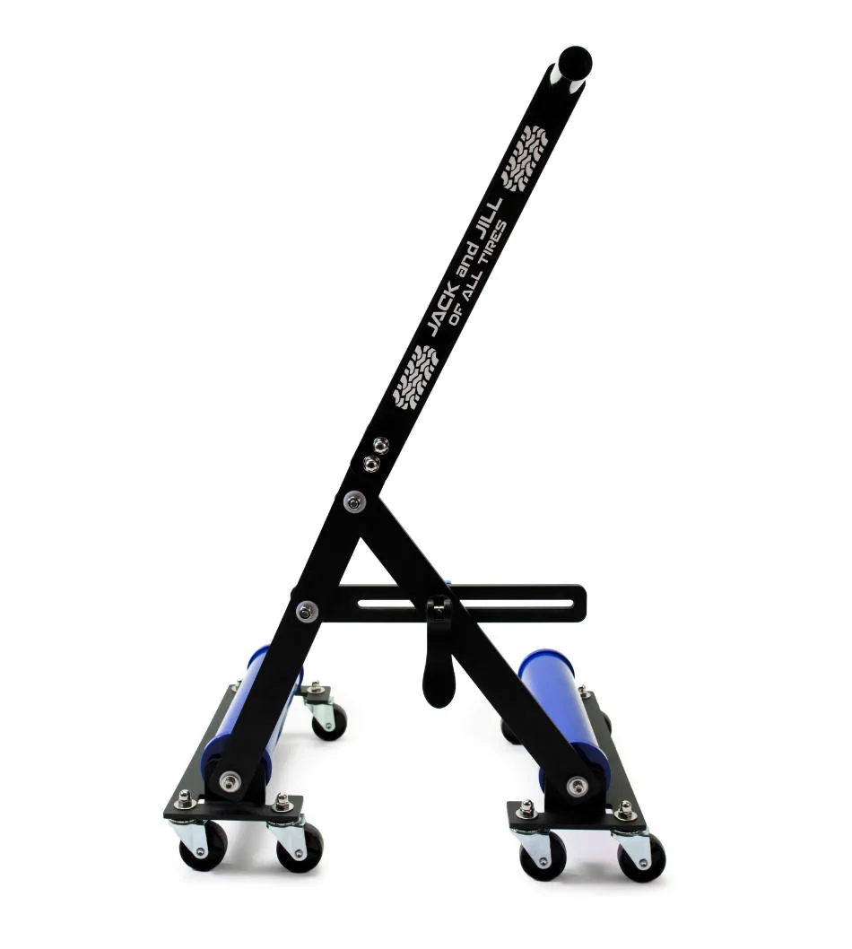

The 315 Hakkas are kind of heavy to lift with my toes, so I have been contemplating one of these:
Ford Bronco Mounting Sasquatch-Size Wheel/Tire Assemblies . . . IMG_0736
http://jackandjillofalltires.com
Seems like it might do the trick. The manufacturer claims it will work with “35”s.
I really like that! More compact than the dolly from Amazon. Couple of downsides. It's rated at 100 lbs. My Method 315 wheels and Falcon ATW4 tires weigh in right at their limit at 102 lbs. The Amazon dolly is rated at 330 lbs. Also the Jack and Jill dolly has to be ordered from Canada. Not sure about the shipping cost to lower 48.
