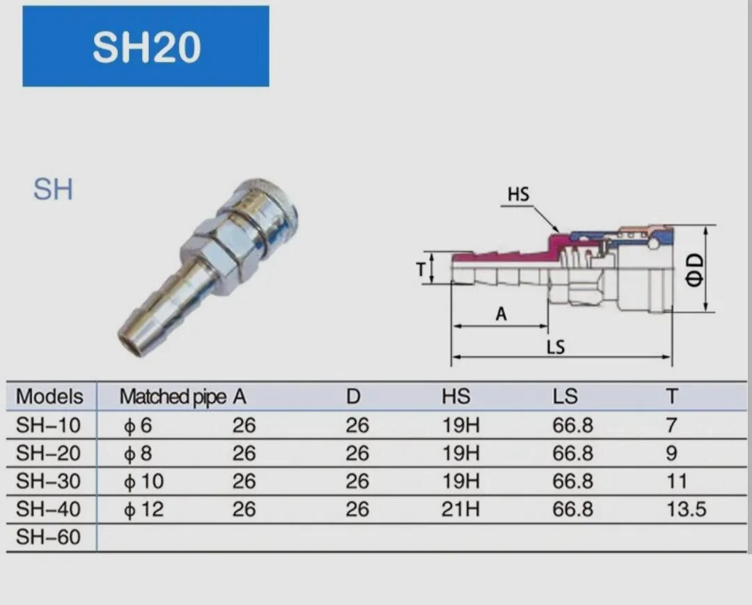

No one mentioned doing a DIY 4-tire setup? I'm going that route because I can do it for less than half the price. The hardest part (for me) was finding the correct adapter for the Asian type connector on the compressor, as I wanted to keep the stock hose intact and usable for a single-tire use or for inflating other objects.
SH20 (barbed) or SF20 (female threads) for those that wonder.

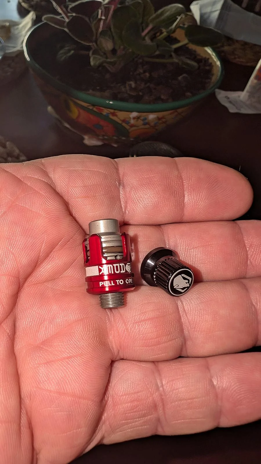

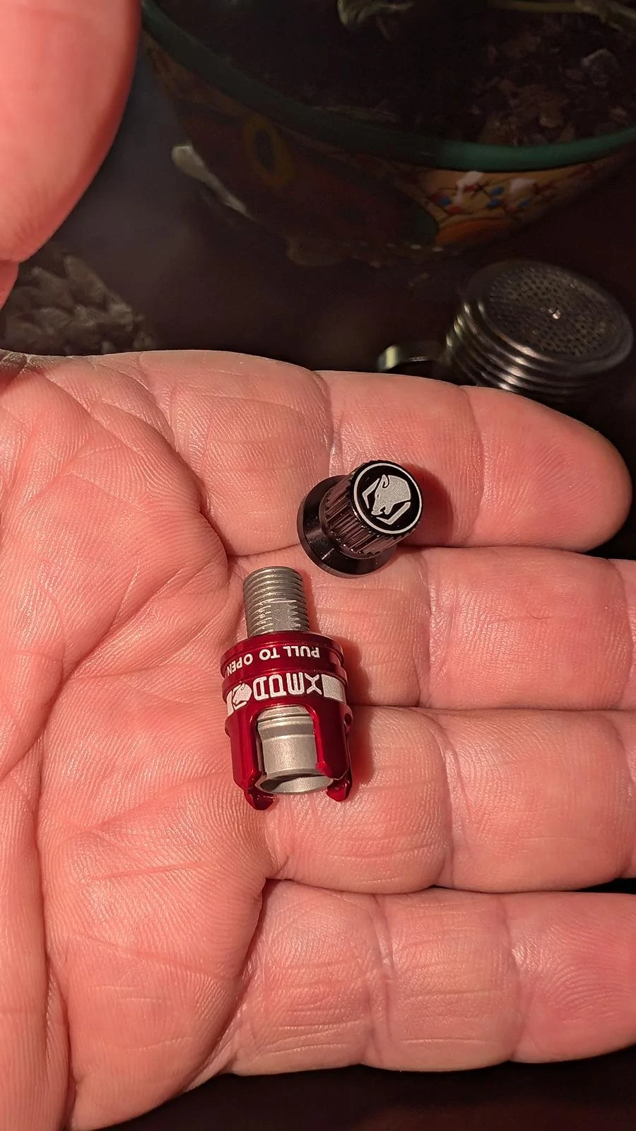

Trying these out before I upgrade to the full meal deal
Ford Bronco Morrflate Quad Hose Question PXL_20240626_143449669
Ford Bronco Morrflate Quad Hose Question PXL_20240626_143408580

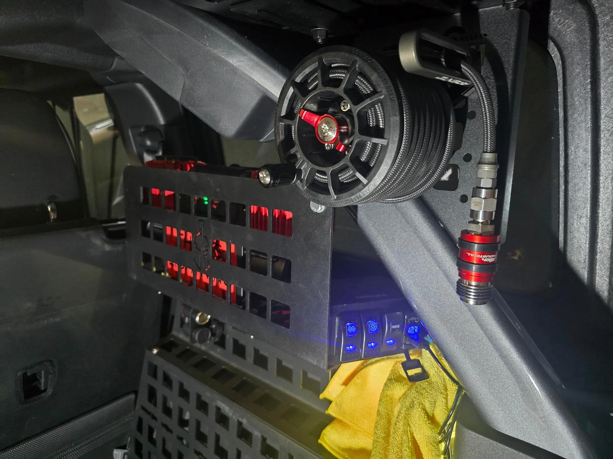

I also have the Thors Molle mount. I ran the wire through the firewall and inside the door sills. There is a race there with plenty of room. Put a relay behind the trim panel in the cargo area and a switch to activate. Also put in a CRS reel. Works great.
