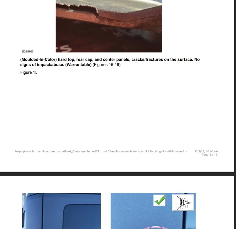

Seems like cracks in the top would fall under Page 8 of the Ford pdf. But when looking at that page, seems like the photo for Figure 15 is missing (see below). My top has spider cracks as other owners have encountered, and so I'm wondering which part of the pdf may relate to that?
It’s the picture right below it on page 9.

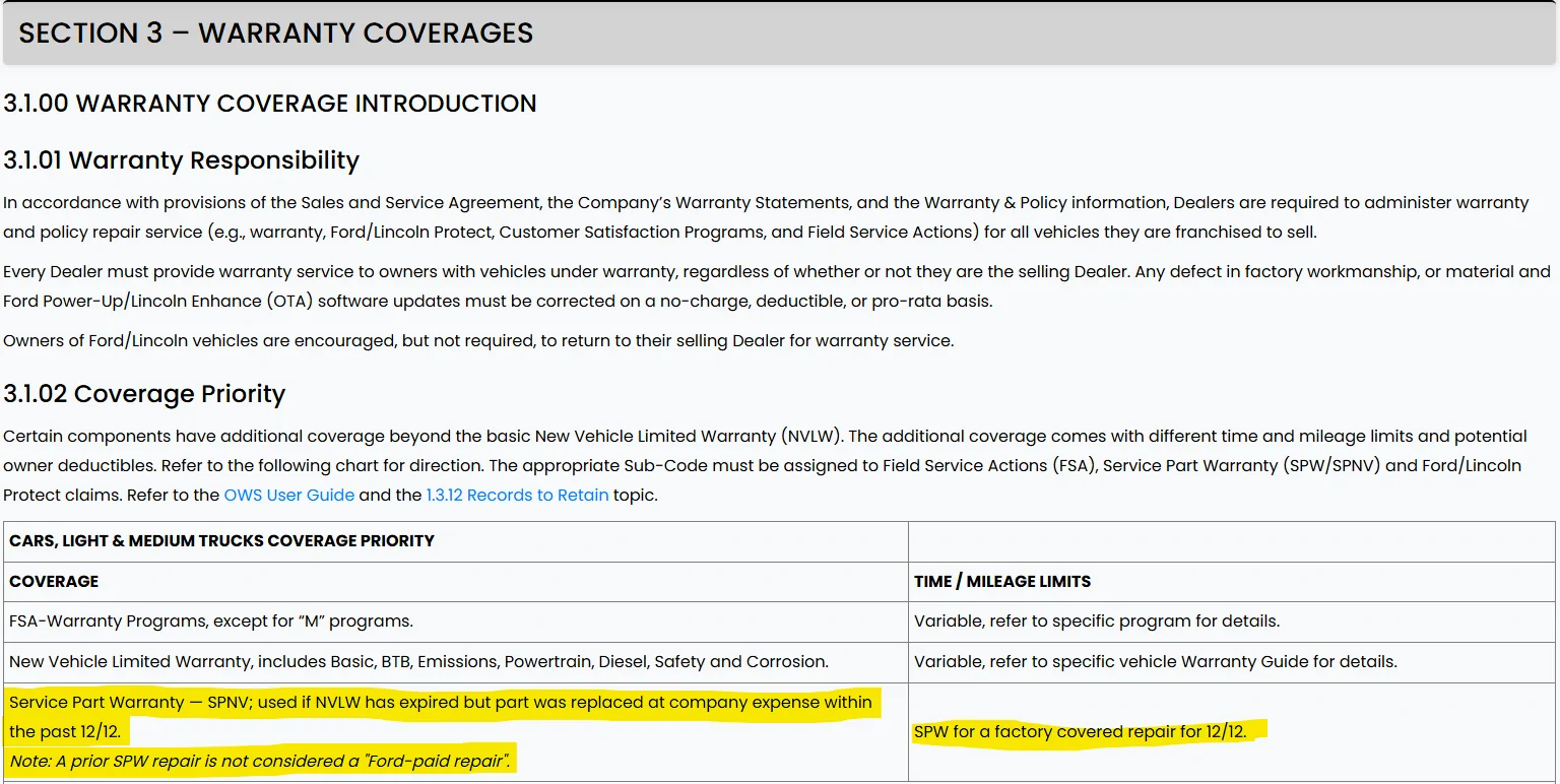

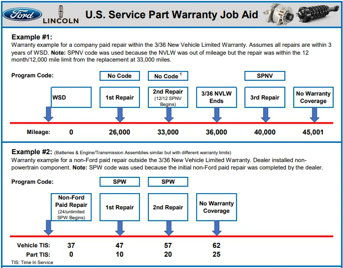

Assuming they replace my top as it appears to match what’s covered, how long is the warranty on the replacement? Does it reset the 3/36 warranty on the top or portion of it that is replaced?
@Beach_Bum
I finally had time to look into this because I was curious:
There is a 12/12 warranty from the most recent/latest NVLW repair.

@Beach_Bum
Good to know. Thanks for looking into it and providing a reference. For those that are at or near the end of the 3/36, they still will have a window of coverage for the replaced MIC tops. But of course, that is dependent on the dealer knowing the nuances of warranty coverage. At least with the reference you provided, others that are in that gap have a fighting chance to dispute any lapse in coverage from the 3/36.

Yep. That first picture is straight from Ford's Warranty and Policy manual, so hopefully whoever is dealing with this can just reference the section number of it for their dealer.
Can someone remind me where this PDF is available?
I'm about to take my MIC top to the dealership to be evaluated and photographed prior to the impending end of my warranty period.
Thanks!
