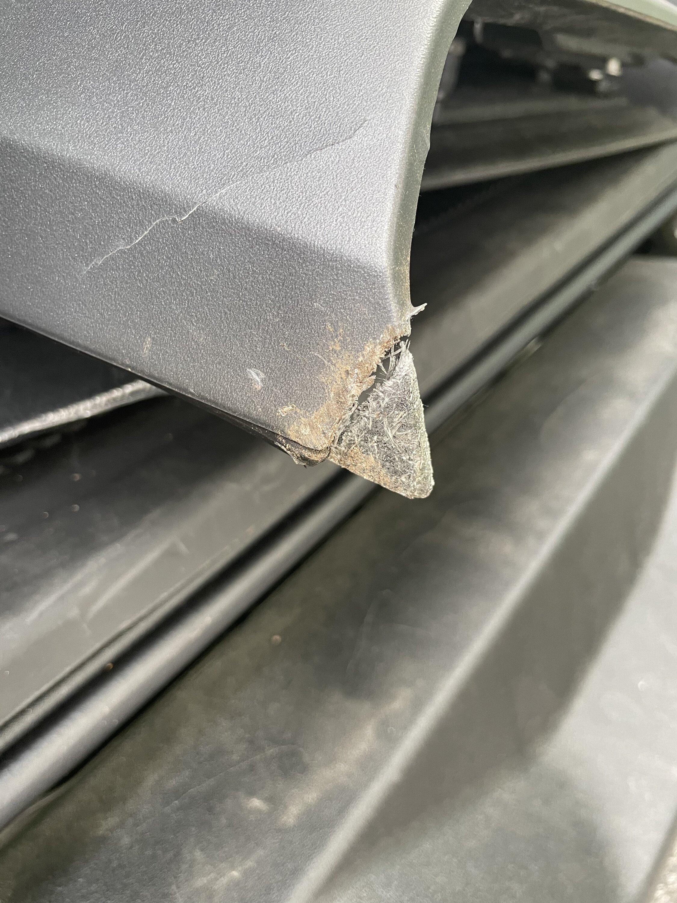

When you store them in the trunk, are they in the bag and standing up, secured to the rear seat?
Reason I ask, is if they're simply laid down in the rear, it is completely possible that you shut the swing gate on that corner to do that damage... the swing gate isn't flat completely across it.

Completely fair… they are down and not in the bag this time (and a few other times). My dumb ass didn’t realize this could happen if they aren’t in the bag

I'm sure it could still happen if they were in the bag... you just have to watch that inner swing gate.... I can't even lay mine down in the back unless I fold the rear seats down. 2 doors don't have near as much cargo space as 4 doors. In nice weather, I'll take off the front panels, place them in the bag, then secure the bag to the headrests of the back seats. Only downside is that you can't see anything directly behind you, you just have to rely on your side mirrors.

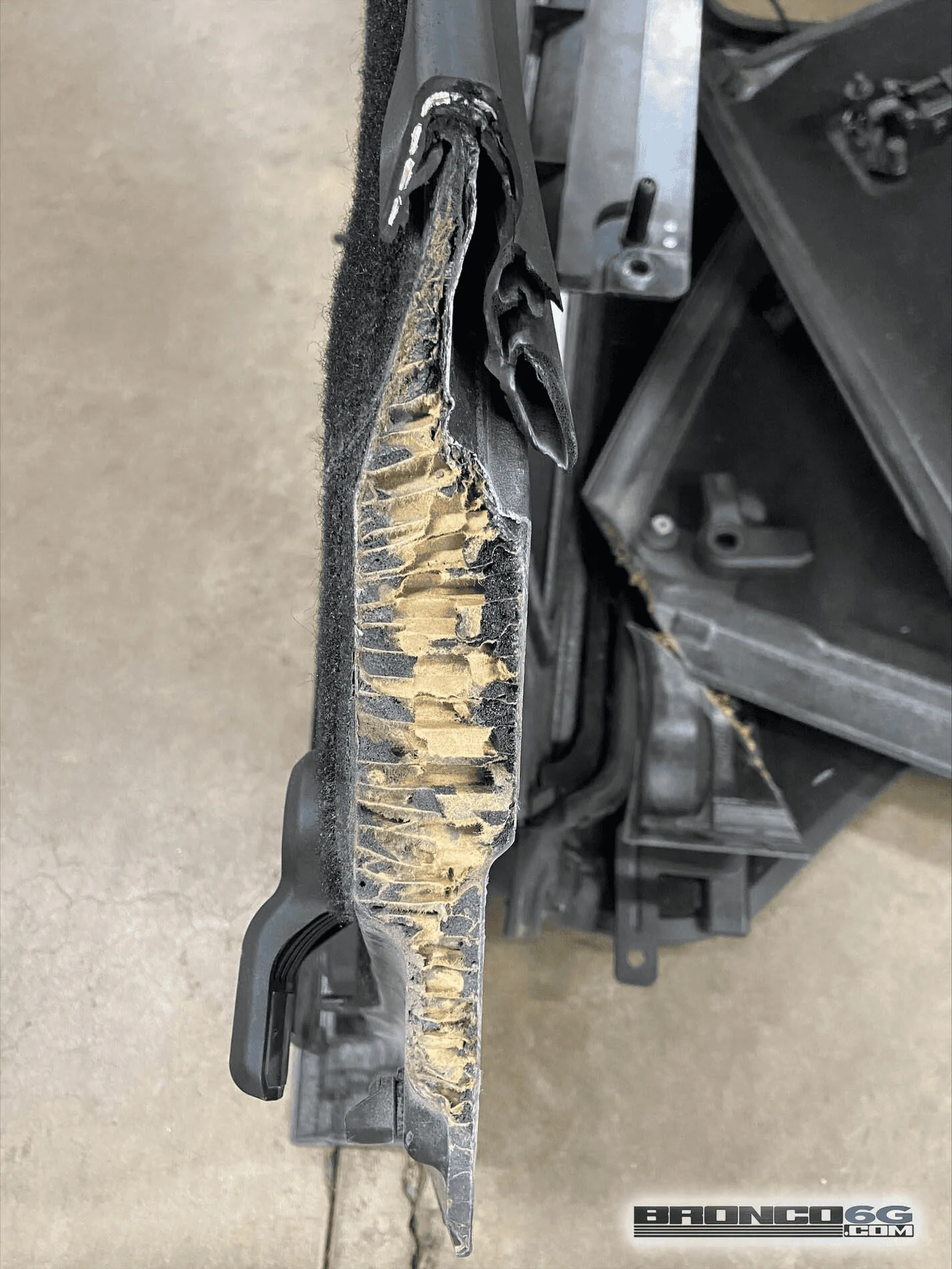

Off topic…..I thought the roof panels were solid MIC plastic? I see fiberglass in there. Isn’t that a good thing if the roof panels are fiber reinforced?
It is mostly cardboard actually.

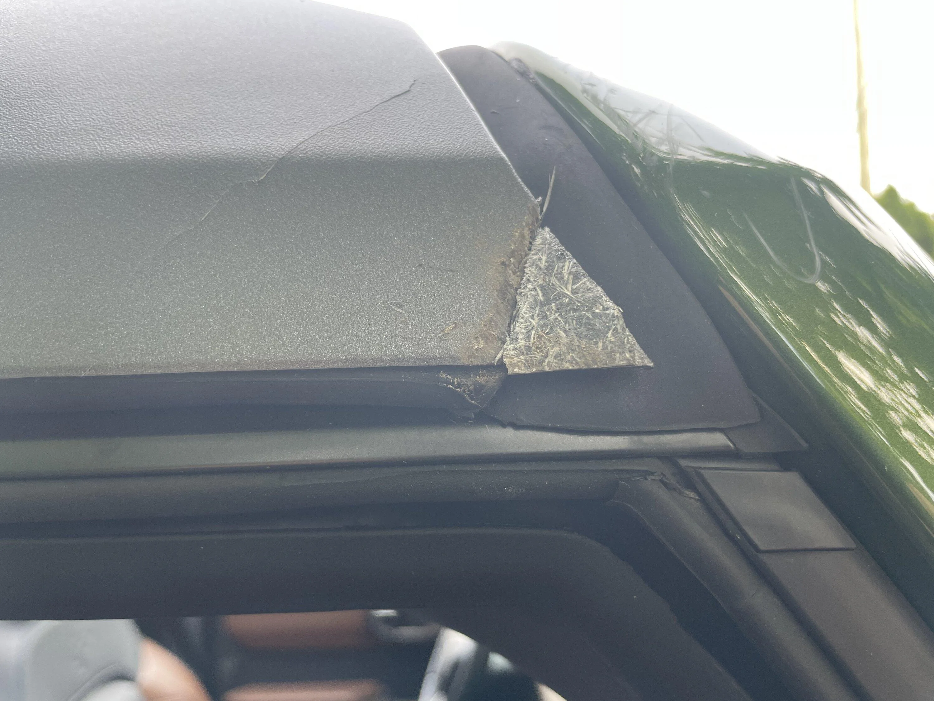

Have a quick question. Anyone else’s roof breaking?

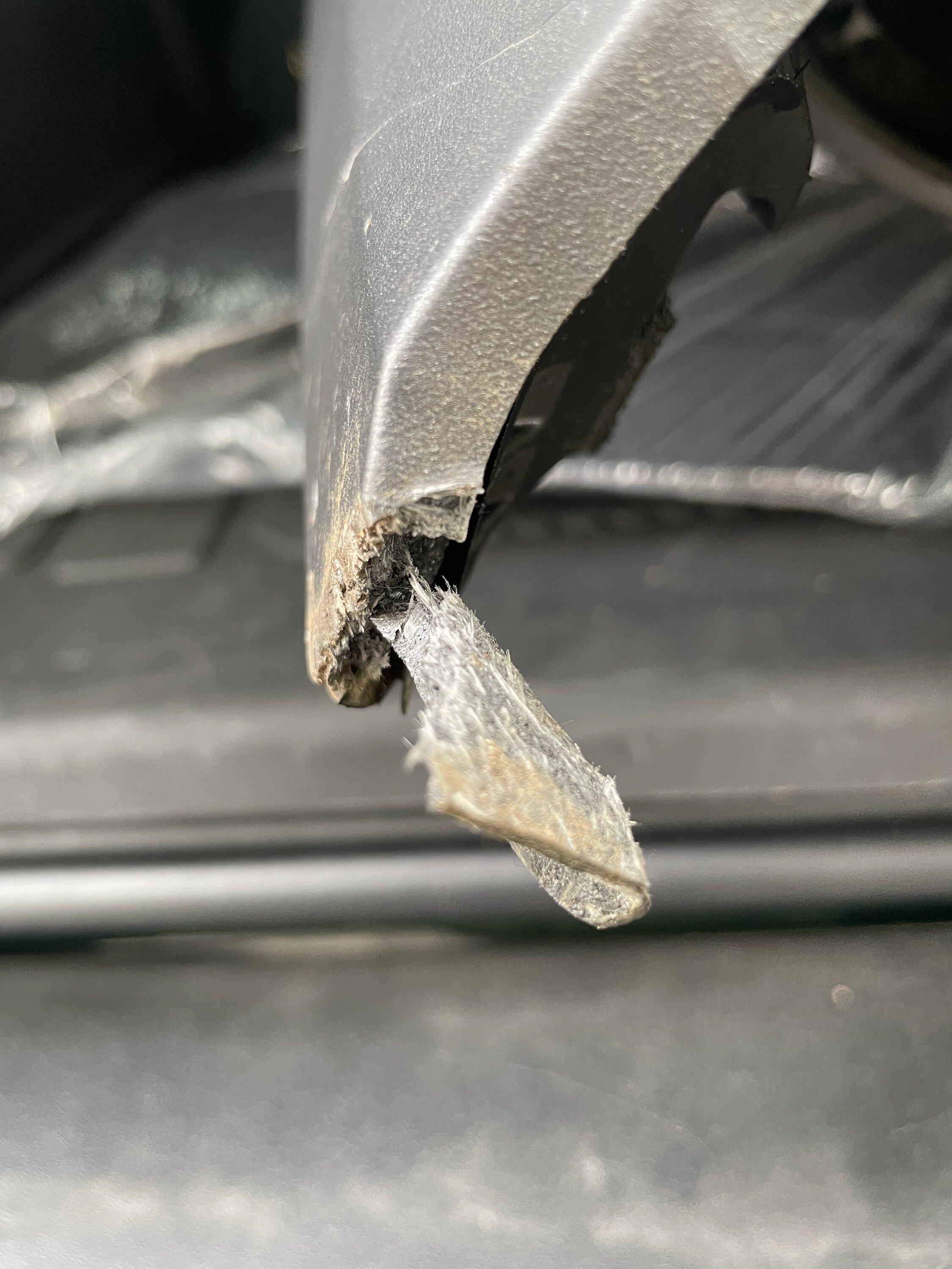

I have a Jan’22 with a hard top and am on the east coast. I’ve probably taken my driver | passenger side roofs off about 15 or less times this year. I do store them in my trunk if I am out on the road when I take them off - And today when I went to put my roof back on I noticed the front tip is completely falling off and cracking. I hadn’t notice until today.
Is this even capable of being replaced or covered under anything?

Ford will probably deny any warranty claim. I would say that looks like it was dropped or was hit from moving around in the trunk. Make sure they are strapped down in their carrier and not placed on top of each other.

That looks like the sound deadening headliner, not the roof panels.
Yeah, it’s not… that’s the roof innards. “Sound deadening headliner” is just a fancy phrase for that thin, fuzzy felt you see on the left side of it. The majority of the hardtop construction is essentially a cardboard honeycomb that is sandwiched by two thin layers of plastic. If you haven’t seen it mentioned before, do a search for snakeskin (the plastic is so thin the honeycomb pattern shows through sometimes).
Also to OP, I agree with the other guy. If you just had them loose in the back you either pinched it in the tailgate or had to have smacked the shit out of it coming to a stop/taking off or cornering. Cause to me it looks like that dangling piece is only the inner portion and is completely missing the outer layer of plastic.
