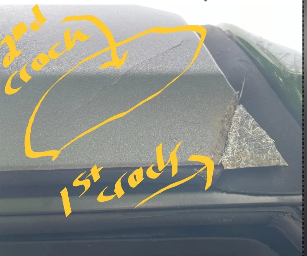

I have a Jan’22 with a hard top and am on the east coast. I’ve probably taken my driver | passenger side roofs off about 15 or less times this year. I do store them in my trunk if I am out on the road when I take them off - And today when I went to put my roof back on I noticed the front tip is completely falling off and cracking. I hadn’t notice until today.
Is this even capable of being replaced or covered under anything?

It is repairable.
I blew my roof off last October, joining the Flying Roof Club through my own mistake (forgot to latch), and the injury looks exactly like that in your photo. Those front corners protrude and are easily broken. If you store in your car, you have to protect those corners. You also need to modify your removal/reinstall proceedures. Given the extent of the break in your photo, it was most likely dropped on the pavement, IME
I personally repaired my broken corner, Because of my previous experience with epoxy boat repair. While there is honeycomb coring in the MIC panels, THE CORNERS AND EDGES ARE SOLID, i know, I opened up and repaired mine. You should be able to have yours structurally repaired by a good body shop, however, the paint match will be imperfect unless you paint the whole roof. That was fine with me.
You should be able to find my repair journal by searching "mic roof repair" or at this link: https://www.bronco6g.com/forum/threads/a-mic-top-repair-after-panel-blew-off.28919/
However, you may have more extensive damage than a corner. I notated a photo of OP 's photo, there's a second long crack paralleling the first, indicating a strange impact, or perhaps a compression fracture, like someone stood on the roof panel on the ground in order to reach the top, sat on it, etc. Theres more to the story, perhaps someone borrowed the OP's car and did damage by mistake. This panel has more damage than my panel did, and mine hit the asphalt highway at 45-50 mph, tumbleweeded down the road, and I was able to recover and put back on vehicle before repair. These panels are sturdy.
The reason the interior diagonal crack is worrisome is that is over a laminate coring area. More difficult repair in so many ways than the corner. Also, the curvature of the panel may be permanently compromised during repair, causing leakage at the gaskets underway in the rain. The more I think about it, replacement or one of those Sunrider tops is the best option . . . Or buy a Sunrider now, and a replacement piece in a couple of years or when found used.

Yeah, it’s not… that’s the roof innards. “Sound deadening headliner” is just a fancy phrase for that thin, fuzzy felt you see on the left side of it. The majority of the hardtop construction is essentially a cardboard honeycomb that is sandwiched by two thin layers of plastic. If you haven’t seen it mentioned before, do a search for snakeskin (the plastic is so thin the honeycomb pattern shows through sometimes).
Also to OP, I agree with the other guy. If you just had them loose in the back you either pinched it in the tailgate or had to have smacked the shit out of it coming to a stop/taking off or cornering. Cause to me it looks like that dangling piece is only the inner portion and is completely missing the outer layer of plastic.

Dang not solid at all like I thought… cardboard nice… best top it is
Lightweight sandwich coring is used in boat hulls, airplane fuselages, and auto panels. The inner and outer resin-infused fiberglass skins combine with (wrap) a lightweight core to make a stronger, lighter part. Resin Infused paper/cardboard, end grain balsa, foams, more exotic Divinycell panels and more are used. It is not evidence of cheap construction. Well enginerred, It makes a strong, lightweight structure . . . In this case, so the roof panels are light enough to lift on and off the roof. Or a boat to be light, especially the upper decks . . .

Don’t get me wrong, I don’t think there is anything inherently wrong with the design/engineering of the hardtop (apart from wind noise issues). Structurally it’s pretty sound, it’s not some flimsy p.o.s. that’s waiting to fold up on you. I wouldn’t do it, but there are pics of people standing on their hardtops. The design meets the purpose, strong enough to meet demands yet light enough to easily remove/replace. If the hardtop was made from a solid chunk of plastic it would be way heavier and way harder to remove. Hell I’ve seen some people state that the middle section is hard enough for them to remove solo as is.
Just as @lakesinai said this design is the way to go for the top’s purpose.

Thanks for explaining that makes a bit more sense. Did look just like cardboard with a carpet sticker so seemed concerning but explaining that helps understand it a bit better.

A decent body shop or boat fiberglass guy can fix that if the OP isn comfortable doing it himself.
