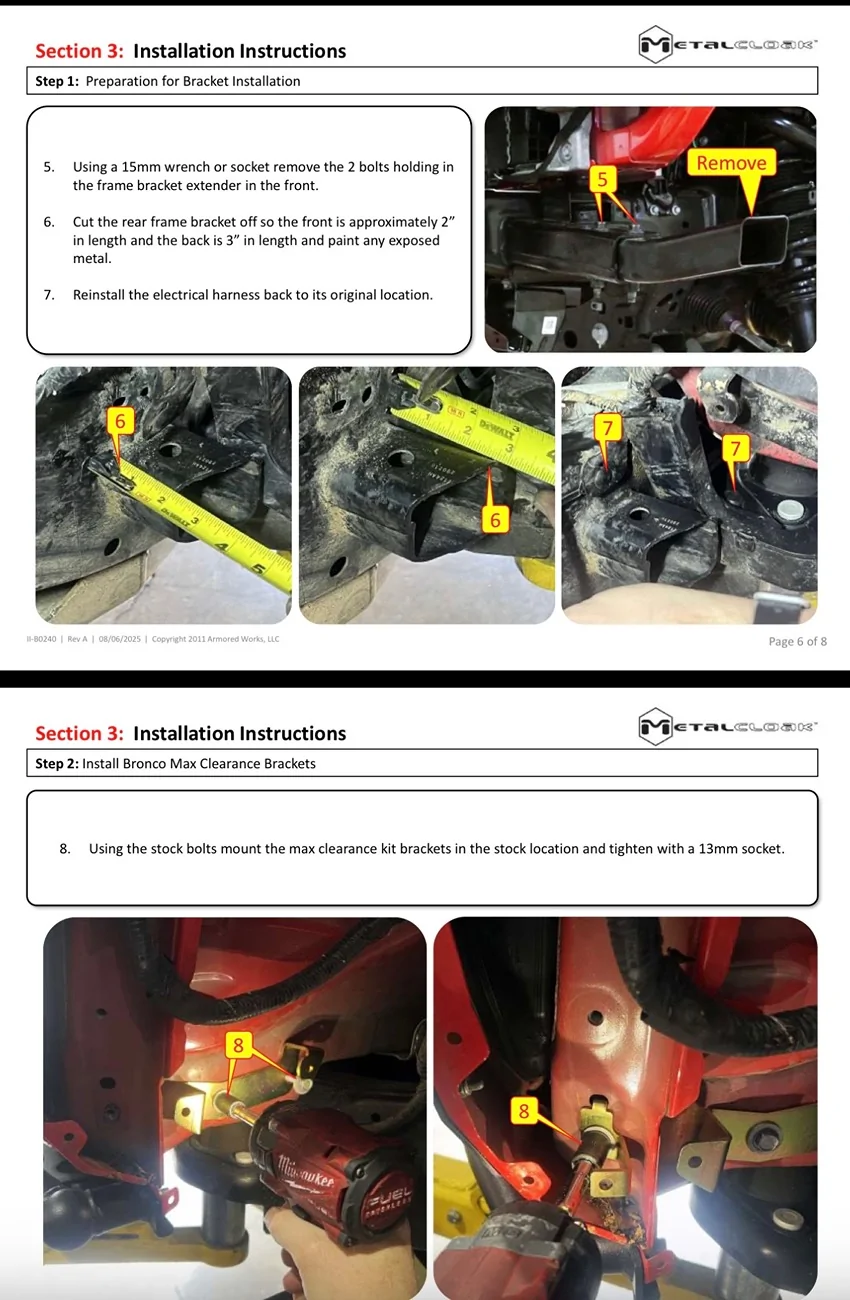

Has anyone used this? Looks like it accomplishes the same thing as HKS but $100 cheaper

Metal clock does not remove the front crash bars so you don’t get the body mount relocation brackets. It’s half of the Jks kit, so 1/2 the $.
Look again at included parts and you will see.
Totally different from the JKS kit. The Metal Cloak kit tucks in the fender liner and does nothing to address the front crash bar/body mount that the JKS kit addresses. If anything, they are complimentary products and not competing products.
Just a heads up the JKS kits also includes those parts metal clock calls the kit.
I have the JKS and they are part of their package.

This kit pairs well with the stinky fab weld on body mounts (which appear to be sold out)
I have those but haven’t had time to do them yet. Very simple clean solution for someone who has the capability to weld them on.

That makes sense.
it does look like they cut part of the crash at bracket. Is this the rear or front one?
Ford Bronco Metal Cloak max clearance kit? IMG_0456
