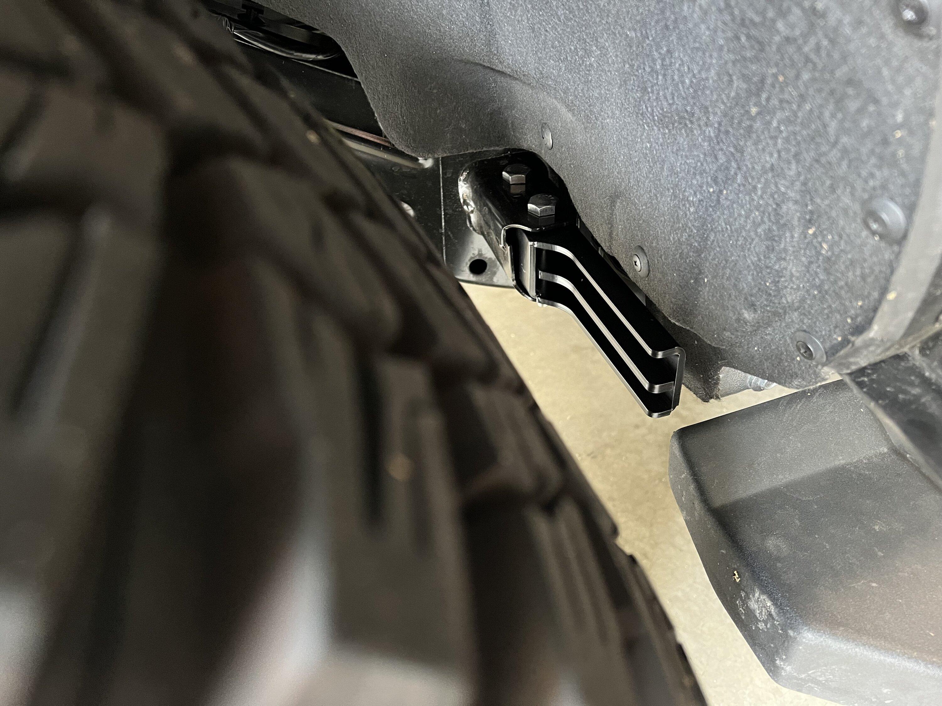

I opted to install Icon High Clearance crash bars on my factory Sasquatch. These are really easy to install and do have plenty of clearance for the 35s. You would need to purchase bolts if you currently don't have crash bars installed. I assume you already have the mounting bolts so not needed for your scenario.

Not here for a crash bar pro or con debate buuuuuut that little thing looks like something some lawyer cooked up to satisfy a “I still have crash bars” argument… zero chance that serves to protect in the event of a meaningful impact.

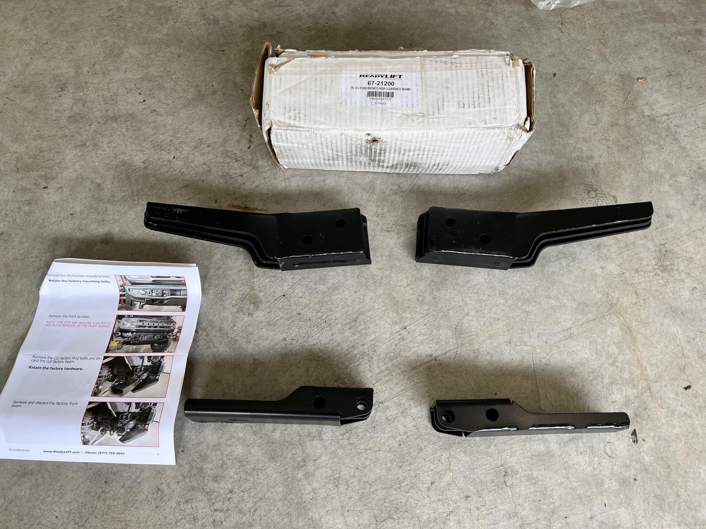

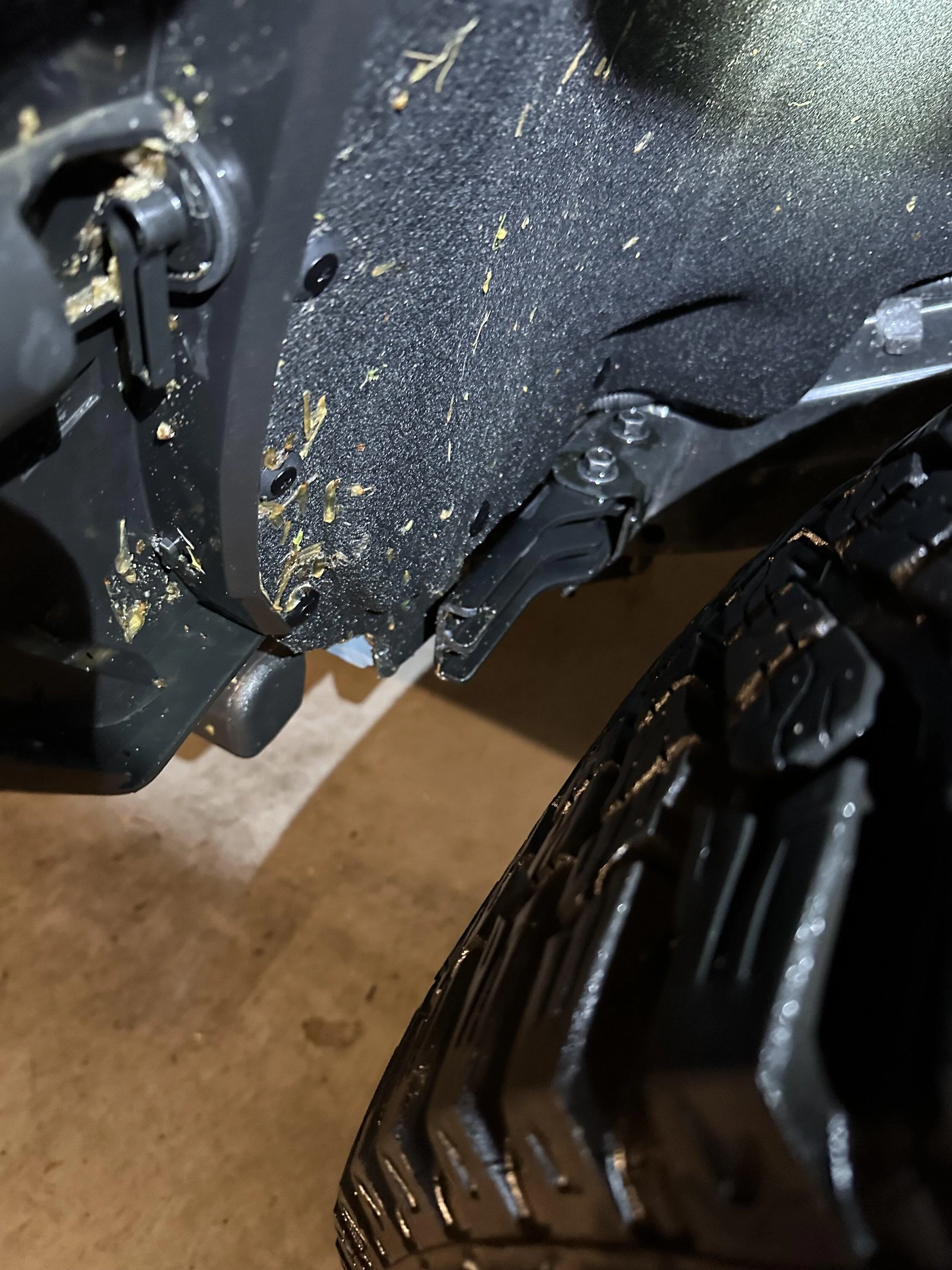

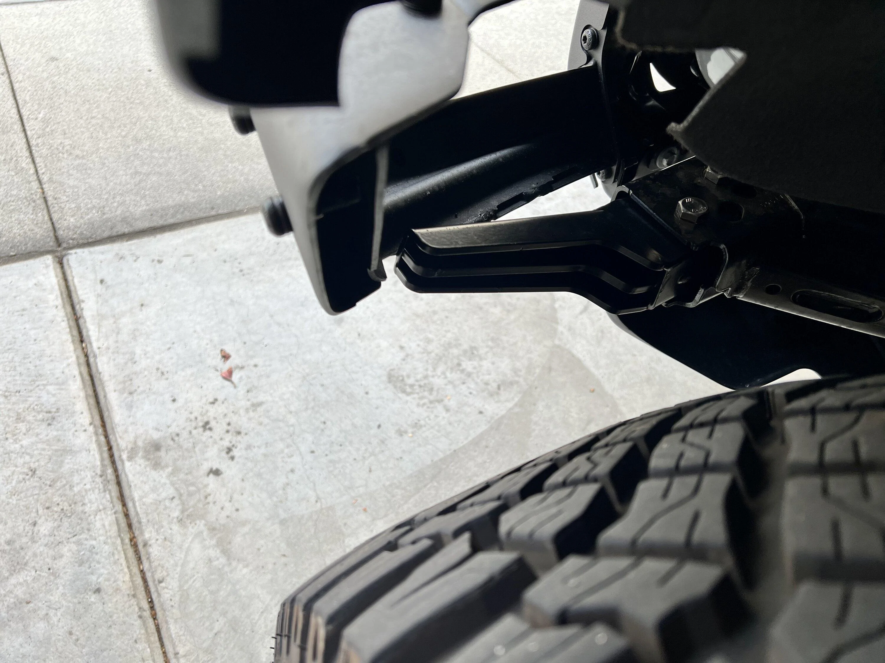

I have them too for peace of mind. I would feel bad if my wife gets hurt in an accident and I didn’t do the most that I can to prevent or reduce the injury. Besides, it’s only $150. If I never use them or they don’t work, it’s not that big of a deal. I have lights installed on my bronco that cost more and I never use them.
The back bars are puny but any bigger they would rub with 35”+ tires. The front ones are beefier. The crash bars working together with the rest of collision system should provide more front crash protection than without them.
