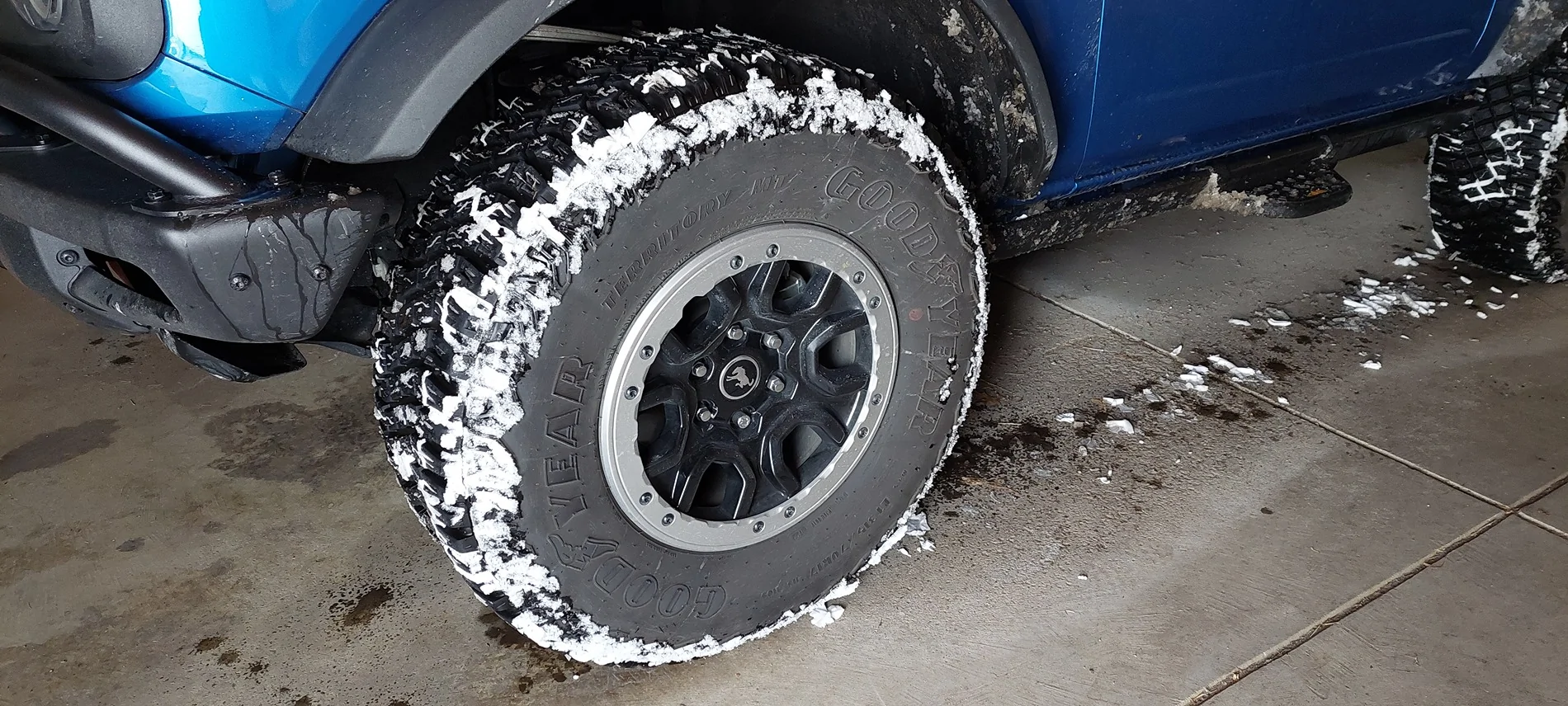

Ford Bronco McGard vs. Ford Performance Black Lug Nuts 20250111_143646
