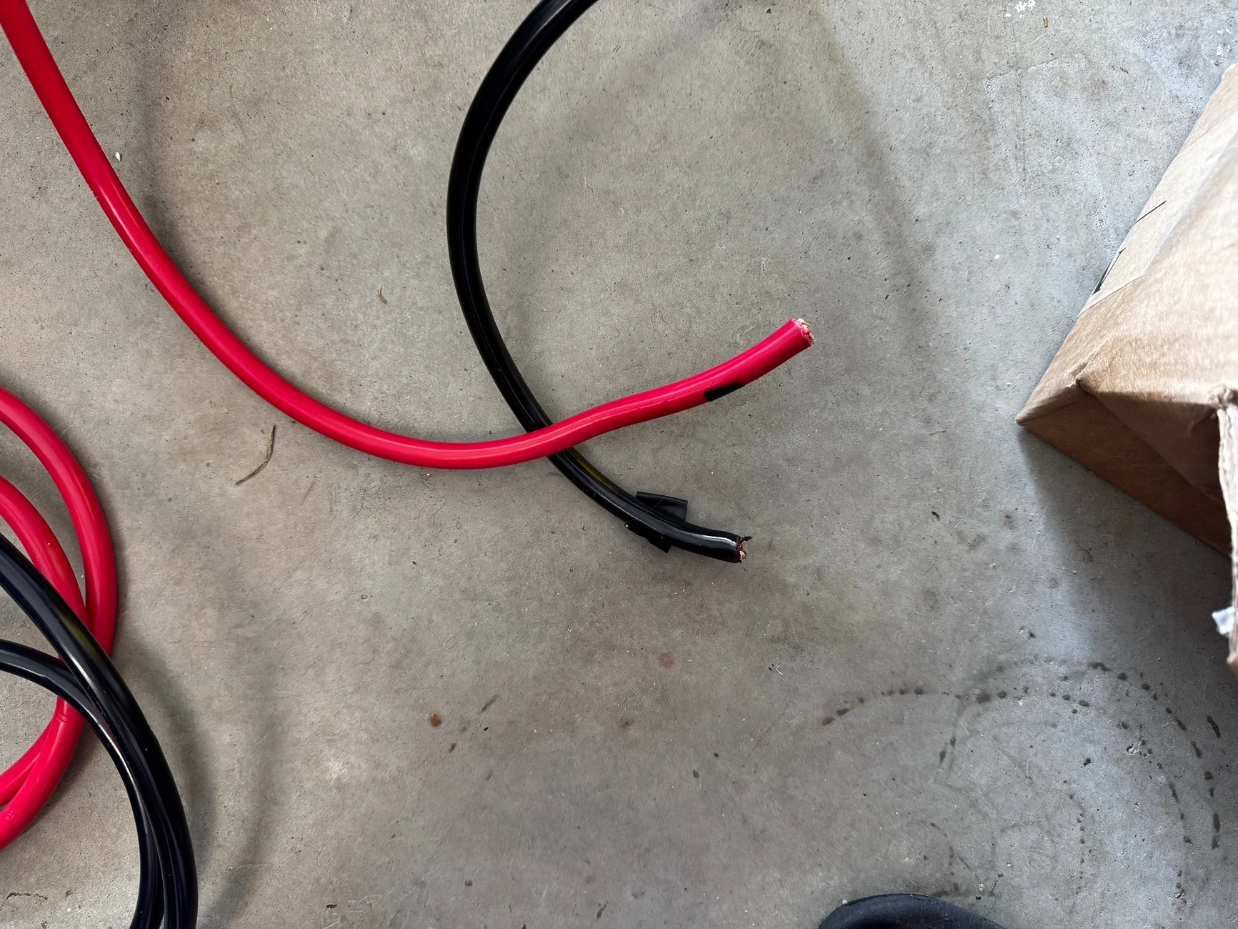

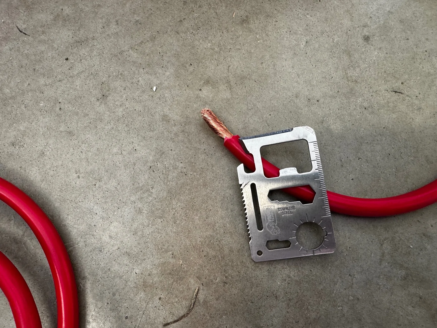

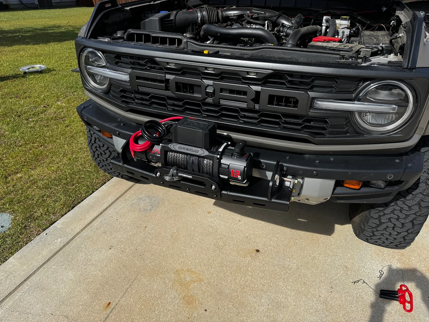

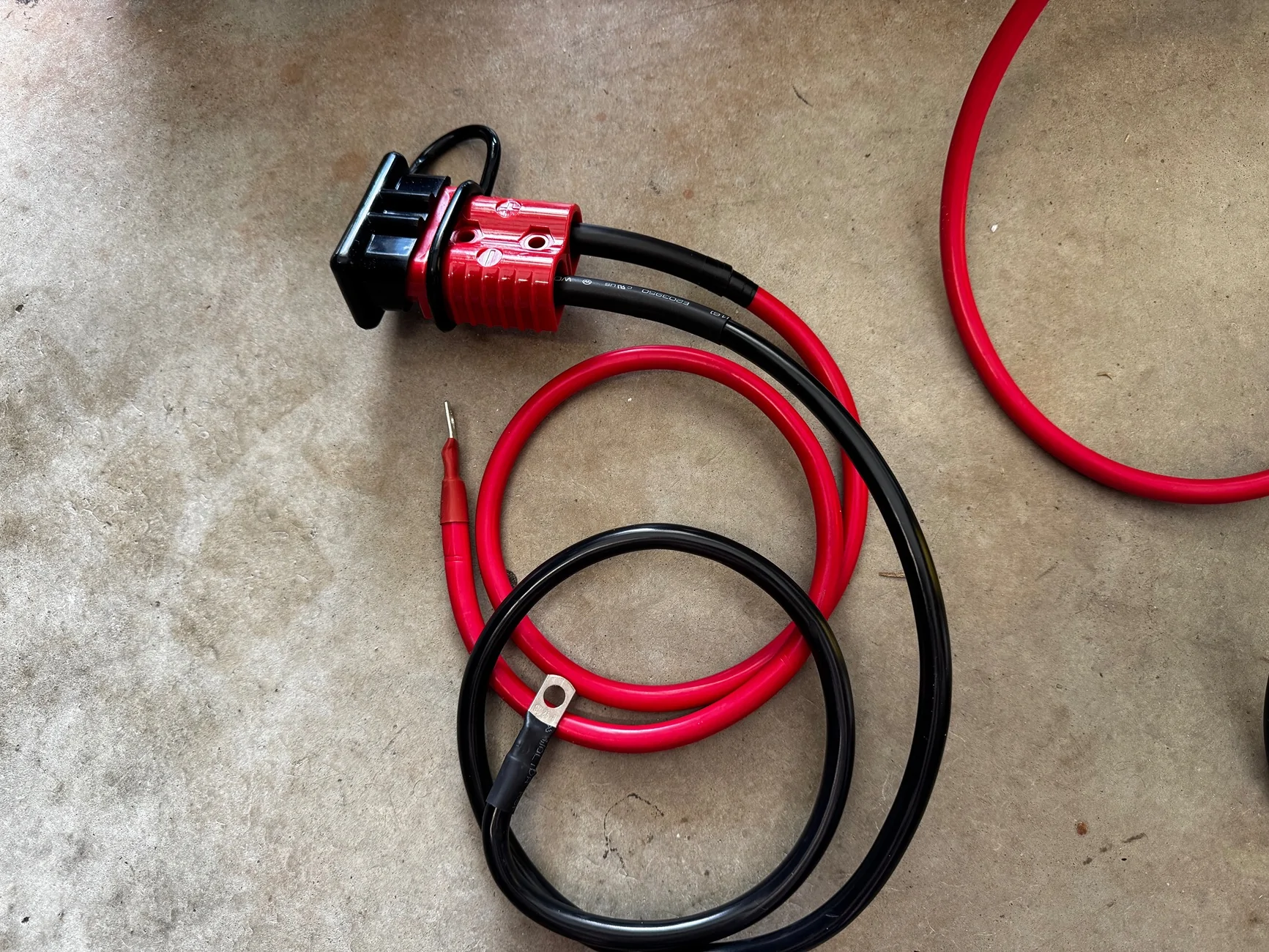

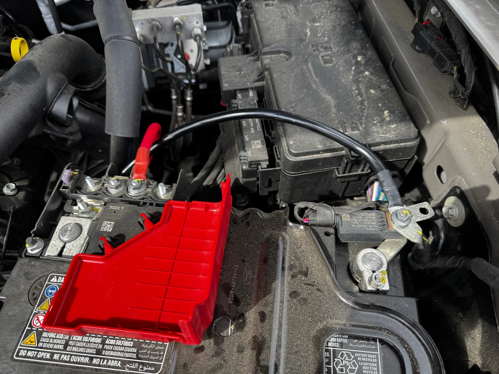

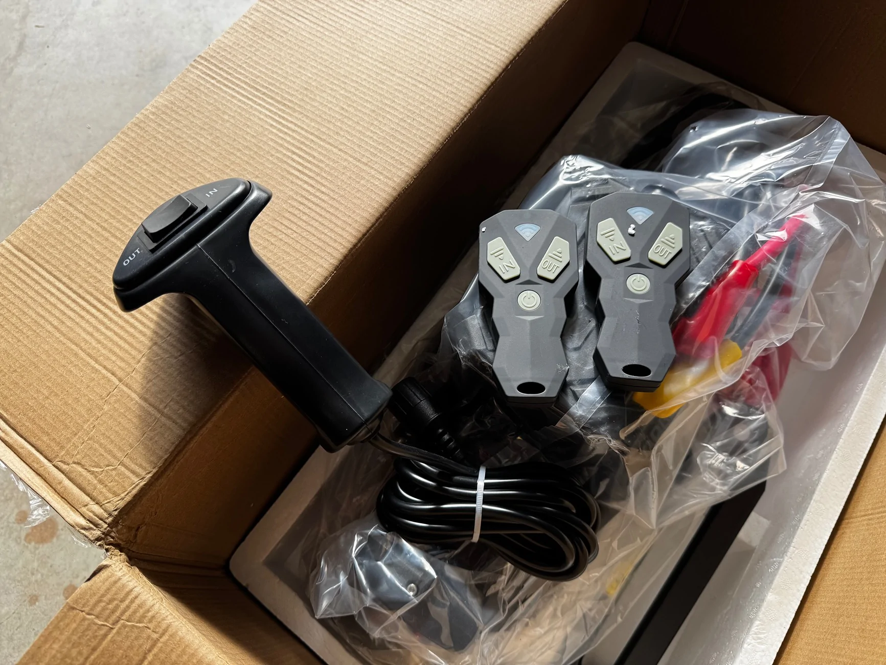

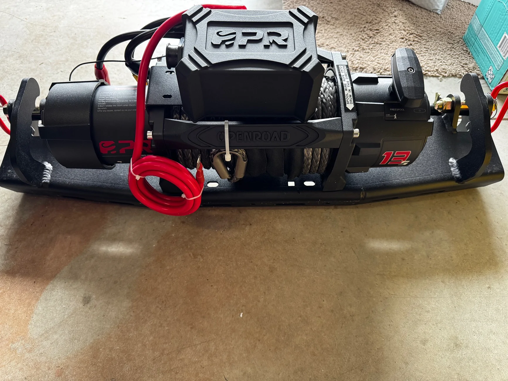

Got it all mounted up and wired today, you have to split the positive and negative cables to use the quick connect kit. You could also buy more cable if you want it longer, I found that a cheap wallet multitool worked well for stripping the wire. Pulled the line out and re-spooled it, tested the wireless and wired remotes, everything worked well. Hopefully I‘ll get out soon to test it.

That's not bad.....not bad at all. Toss it on when you go wheeling, take it off when you are putting around town, or doing very fast desert things.
Win Win!

That was my thought as well, always had a winch permanently pointed on my Jeeps, but there just isn’t a clean enough (for me) option, I really love the way my Bronco looks and having a winch on all the time takes away from it.
