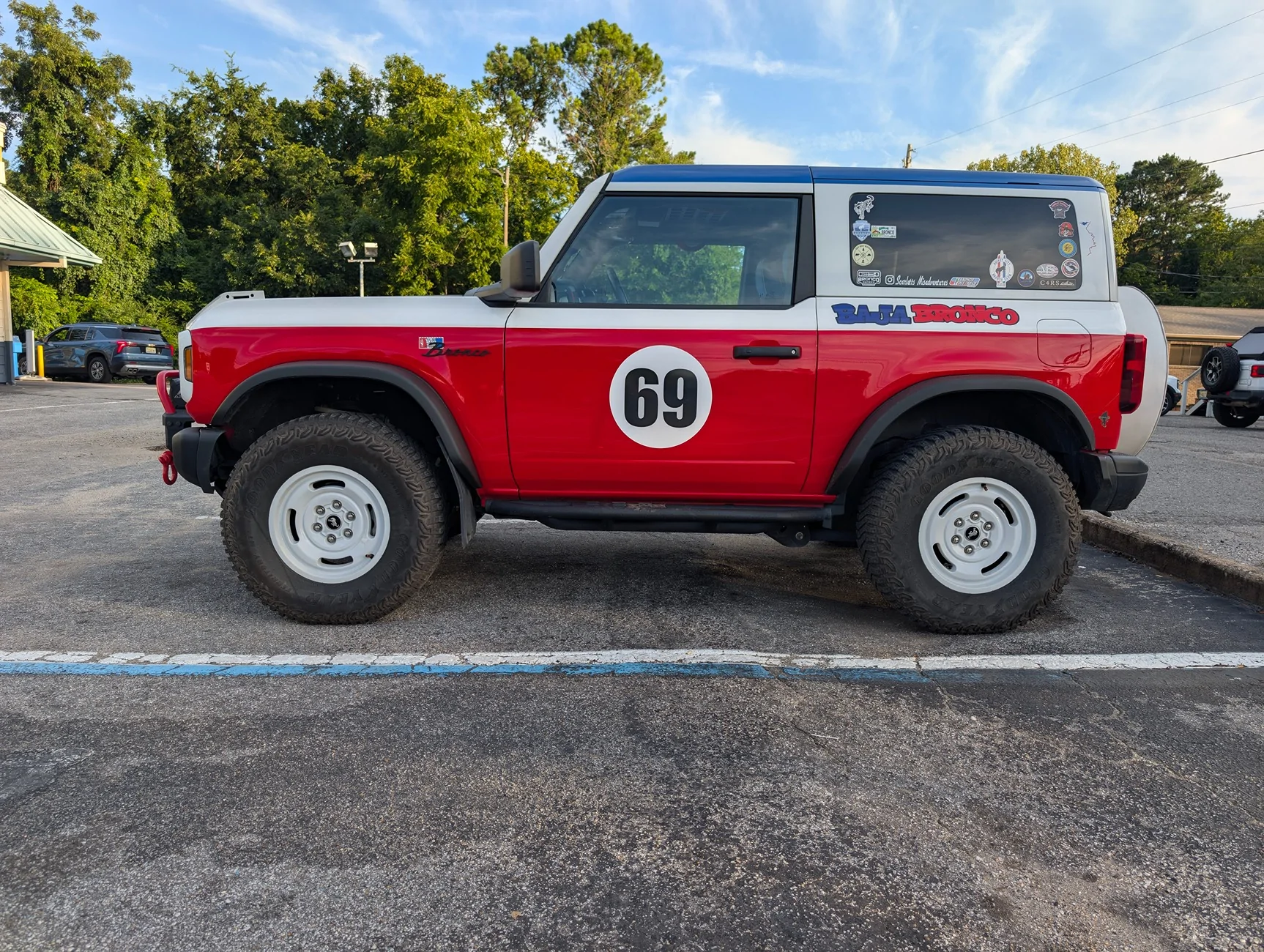

Stock suspension
Ford Bronco front winch mount and suspension levelling PXL_20241005_192511536

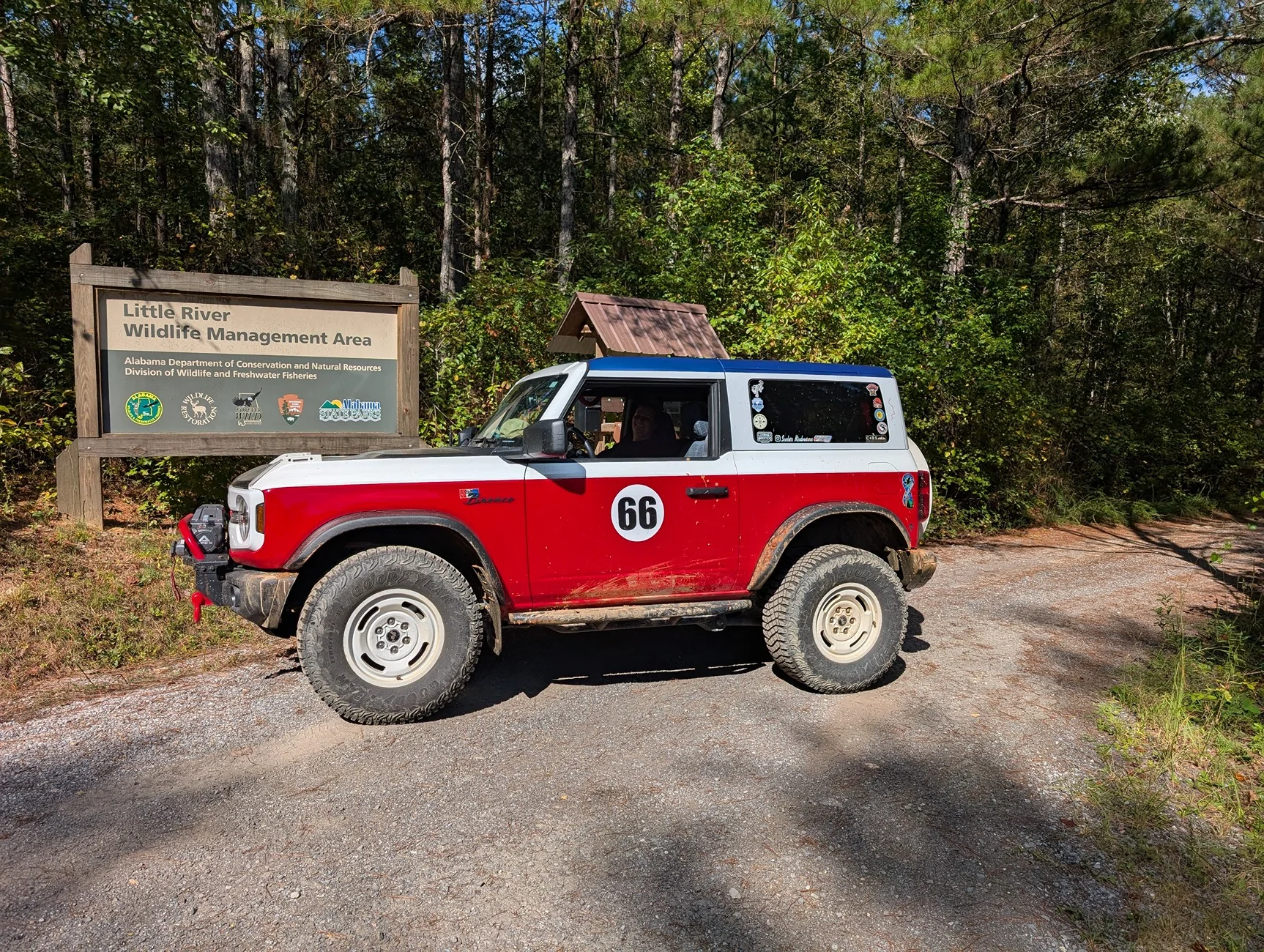

Wildtrak coilovers
Ford Bronco front winch mount and suspension levelling PXL_20250826_230728767
