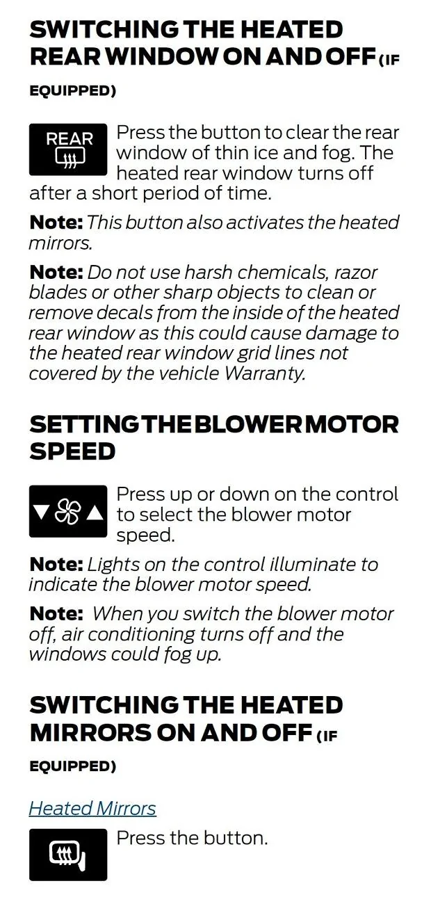

Did a search and came up with this thread, and am bumping it. 2023 OBX with soft top, with hard top prep. All I have is a single rear defrost button, and a PDF owner's manual that clearly was not edited well. I initially read only the very bottom part when I looked for "heated mirrors". A closer look got me to also read the top. Ya gotta laugh.
Ford Bronco Manual Wrong? Heated Mirrors Screenshot 2024-08-26 at 5.24.18 PM
