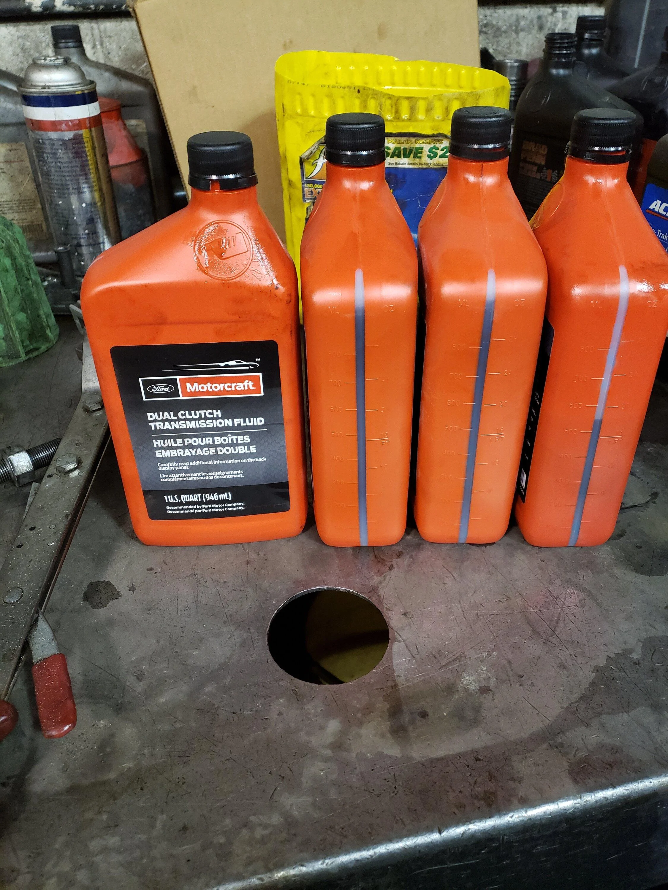

Not terrible, but you will need some form of pump to get the new fluid in (something like boat mechanics use for filling lower units would work). The drain is right on the bottom, the fill hole is toward the rear of the case on the passenger side, and the rear shift lever is slightly in the way. I found that raising the rear of the vehicle got me a 3qt fill. Book fill is 2.5 qt. My additional fluid quieted the noise, but only slightly...I can still hear it under the right conditions

Thanks, figured it was pretty straight forward. What brand fluid did you put back in?

I used the OE Motorcraft DCF, and recommend that anybody else doing this do the same. wouldn't want anybody denied a warranty claim because they experimented w/random fluids

I used the OE Motorcraft DCF, and recommend that anybody else doing this do the same. wouldn't want anybody denied a warranty claim because the experimented w/random fluids
I ain't a scared going with a different brand so long as meets/exceeds the Motorcraft specs. Looking at Redline's full synthetic DCT fluid. They actually list Ford/Getrag compatibilty on their website.
