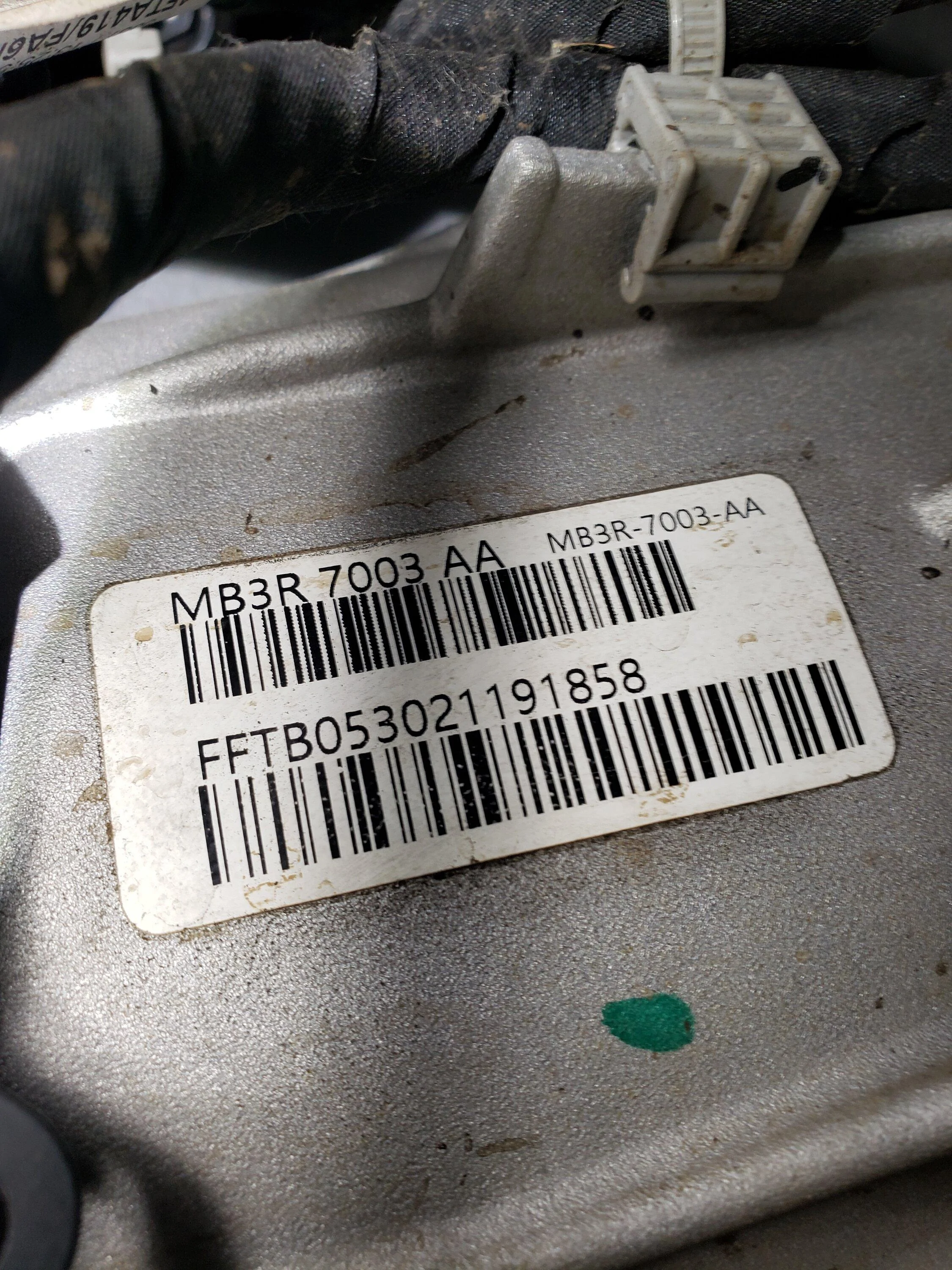

So who's willing to compile all this data and see if there's hot zones, a la the 2.7 valves?
I think the difference here is as far as we can tell, the majority of 7MT owners hear the issue. I’d be surprised if there’s a couple week range of increased probability like the 2.7L valves had. But even so, do transmissions have Julian dates we can easily access?
Bmadda
Jul 18, 2020
2,902
6,830
Wisconsin USA
1990 Bronco eddie bauer
LH side of case near bellhousing, build date is #3
Ford Bronco Manual Transmission Noise Poll trans tag
EDIT: the book says LH side of case, but the tag is actually on the RH side

LH side of case near bellhousing, julian date is #3
will take a peek and see what my date is
curious if this is a smallish batch issue or widespread

Passenger side near the shift cables
Ford Bronco Manual Transmission Noise Poll F9DDFD75-A4FA-4694-80B9-5E328E3F7D6A

@Classic28 is correct, PASSENGER side near bellhousing...thats what I get for reading the book instead of looking at the vehicle. Here's mine
Your sticker and transmission being dirtier then mine tells me I need to get off the pavement. Haha
