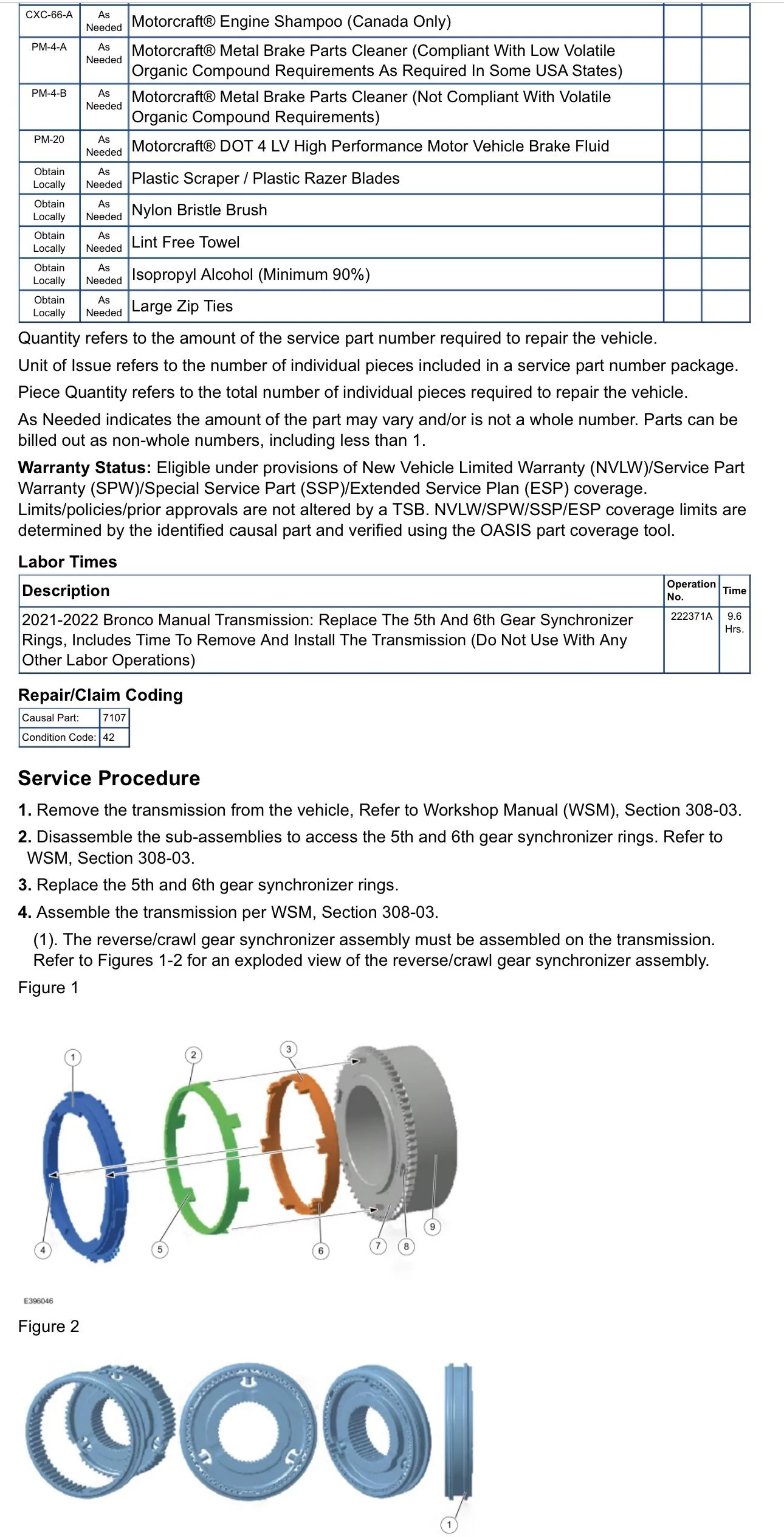

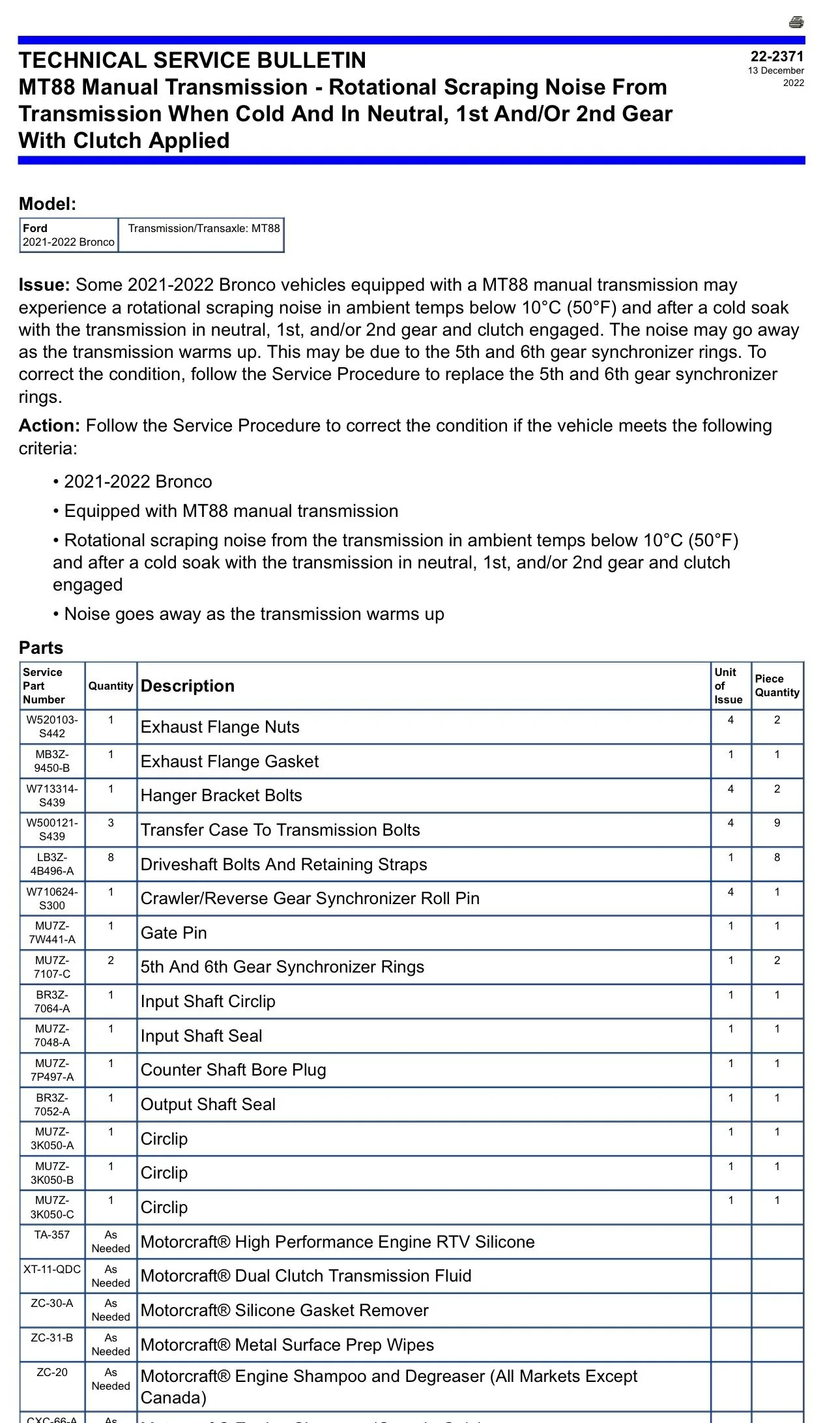

Owners, Read the TSB. According to Ford our noise is prominent at Neutral, 1 and 2 while Cold. Exactly as you describe.
I know some of y’all are as good of a mechanic as the Ford techs. But I laughed that the Service Procedure was only 4 steps and the first step is - ‘Remove transmission from vehicle’.
You might as well tell me to ‘Remove brain from skull’ or ‘Remove warhead from nuclear device’.
