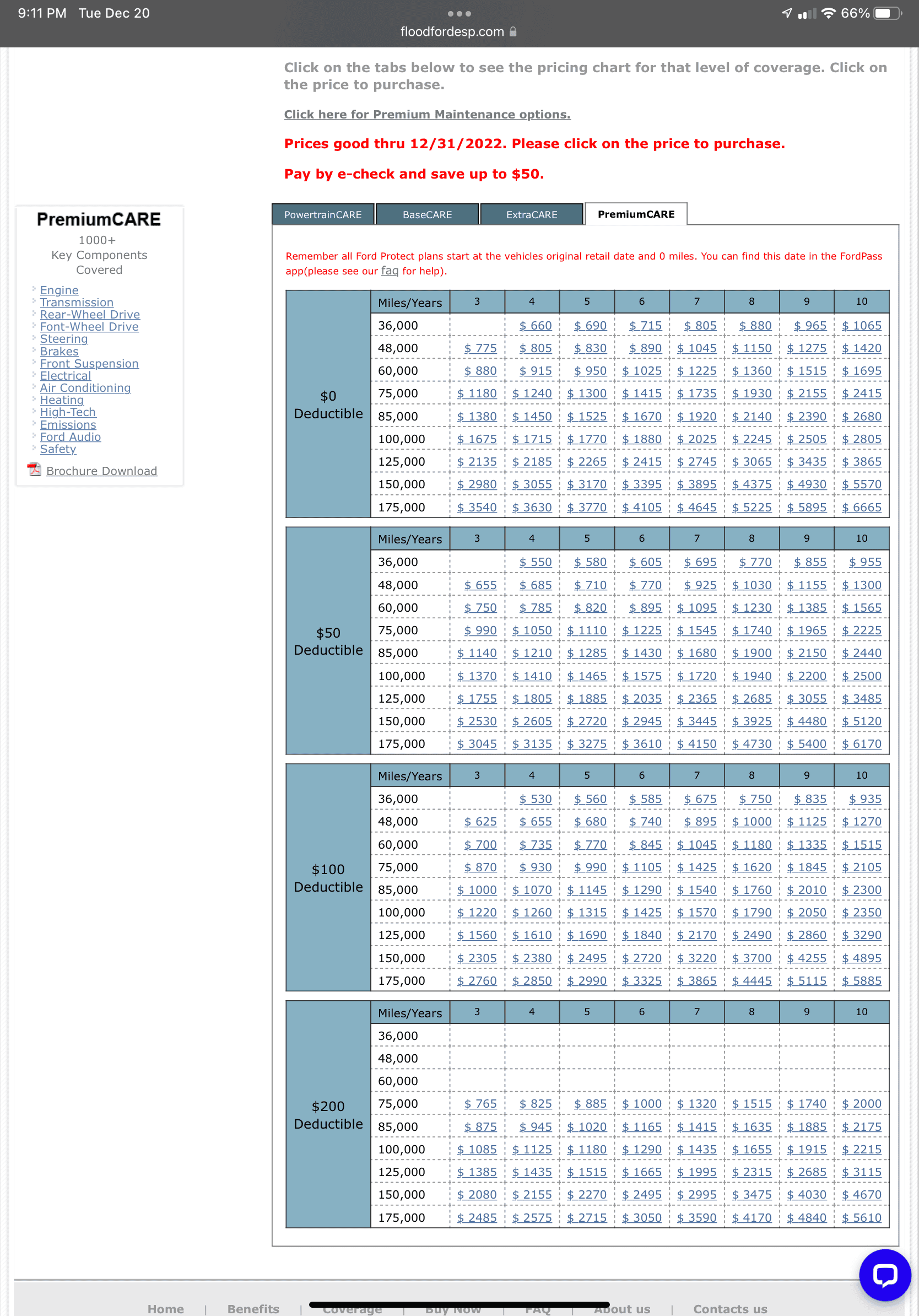

I paid $1950 for a 8 year 100K $50 deductible Ford ESP plan with LED and key coverage. They go out to 10 years now and mileages up to 175K, but you pay more accordingly. I may call and ask them if I can convert mine to the 10 year 100K plan as the Bronco isn’t my daily driver. Grainger is likely cheaper than Flood by $50 or so, but Flood Ford’s website is quicker for a quote.
https://www.floodfordesp.com/
