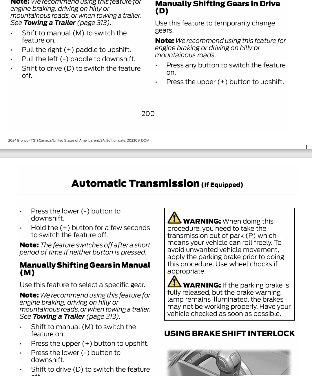

Good to know...all good replies here...also see pg 200 in the e-manual...
