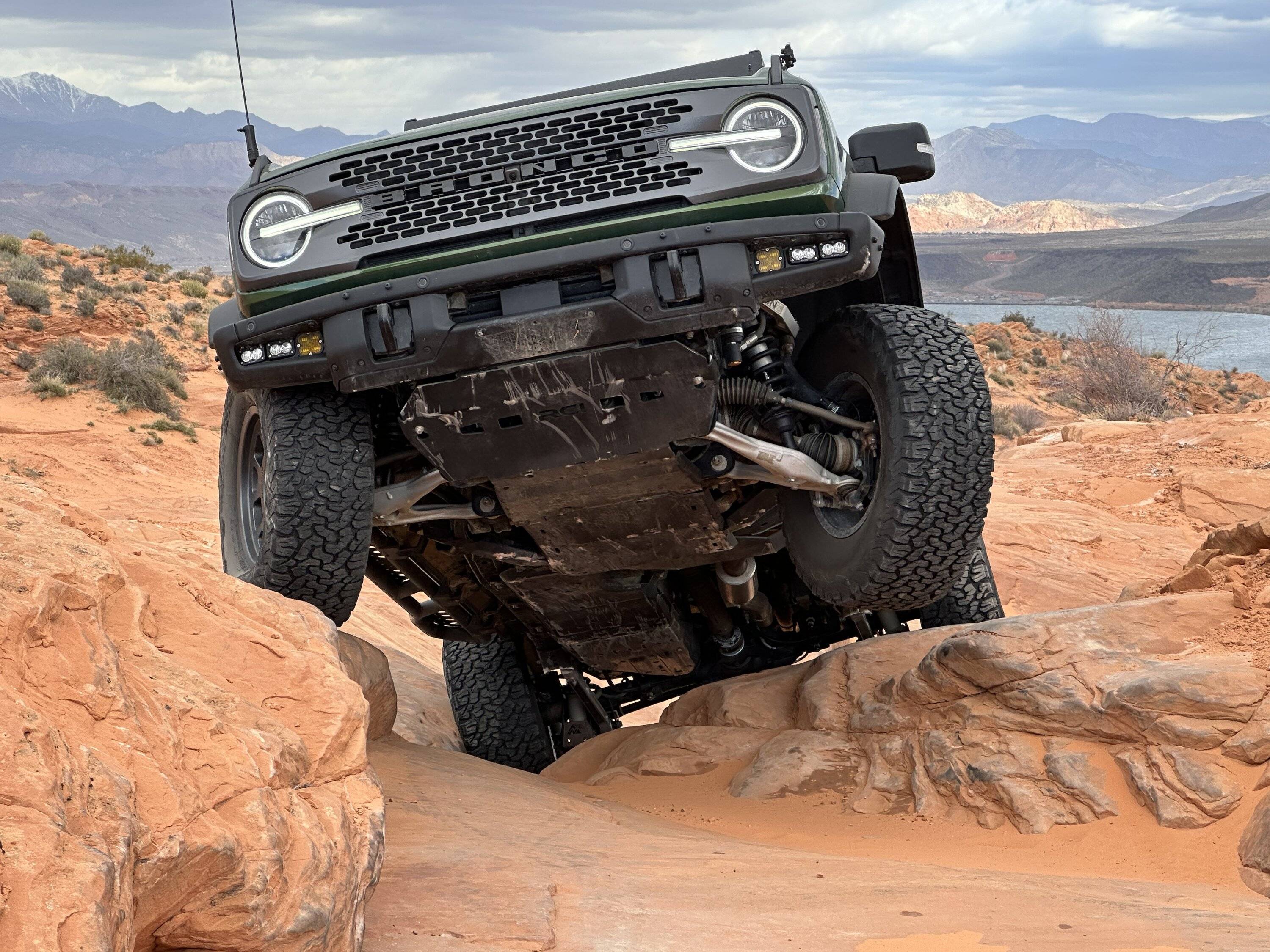

Ok so I have a killer Bronco already with an Icon Stage 8 suspension running 37s steering rack upgrades, tie rods etc and I run hard offroad rock crawling trails from CA, UT and fast desert in Baja. The Stage 8 has been amazing especially in Baja but I cant help thinking I can get more and by more I mean more travel, wider and ability to go faster in the desert and eat whoops.
so I’m considering a long travel kit say on the level of APG (not a pro-runner budget 🤣), Baja kits etc… but looking at all options and suggestions and if I can use any existing suspension to minimize cost is a bonus. Not interested in portals…
On the other hand I'm not sure the cost justifies the incremental improvements from where I'm already at. 🤷🏼‍♂️
Appreciate your suggestions. Thanks
