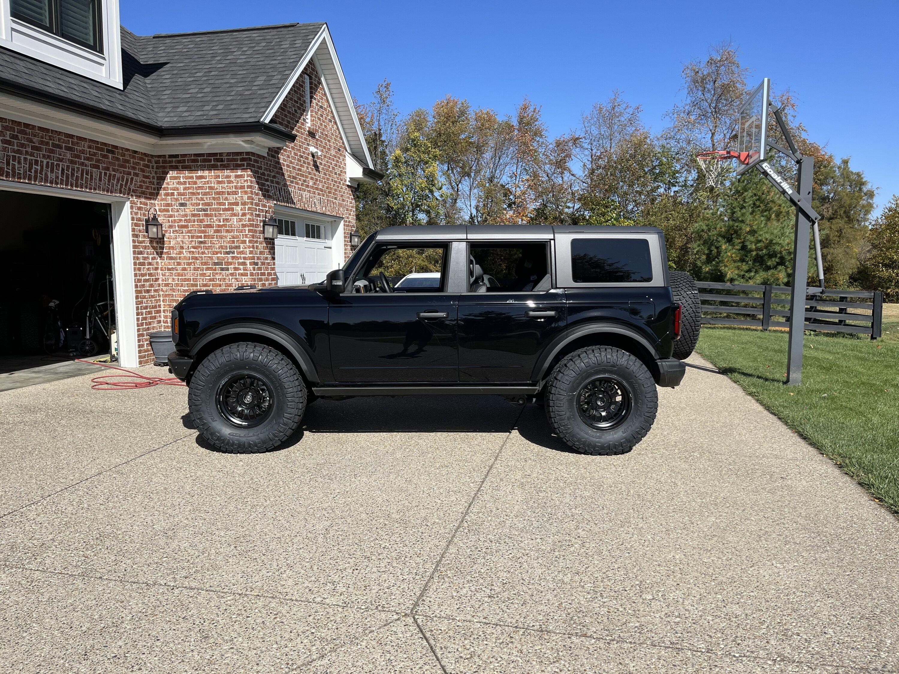

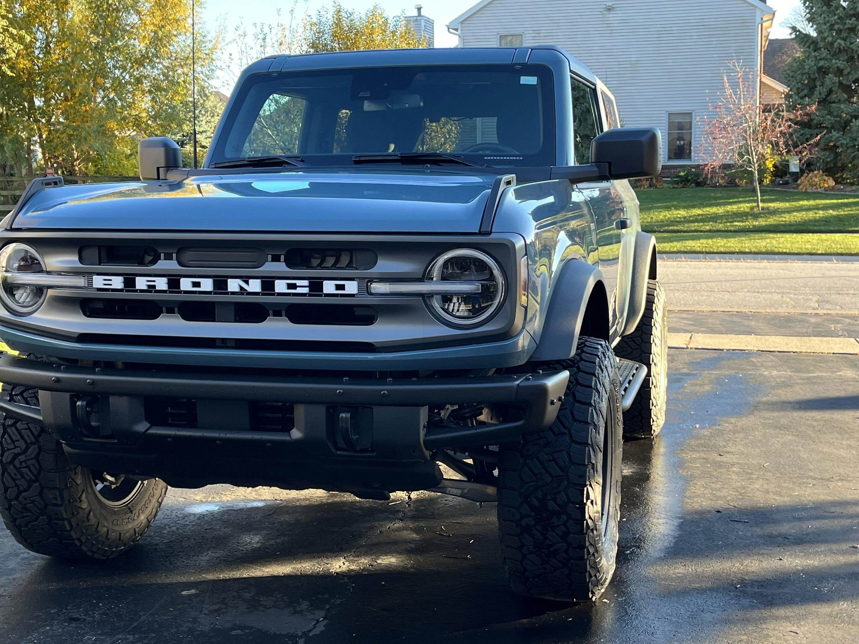

I went with :05/70r17 33.9x12.4 Nitto Recon Grapplers like 65lbs WTH 17x9 plus 12 Blak Rhino wheels like 27 lbs

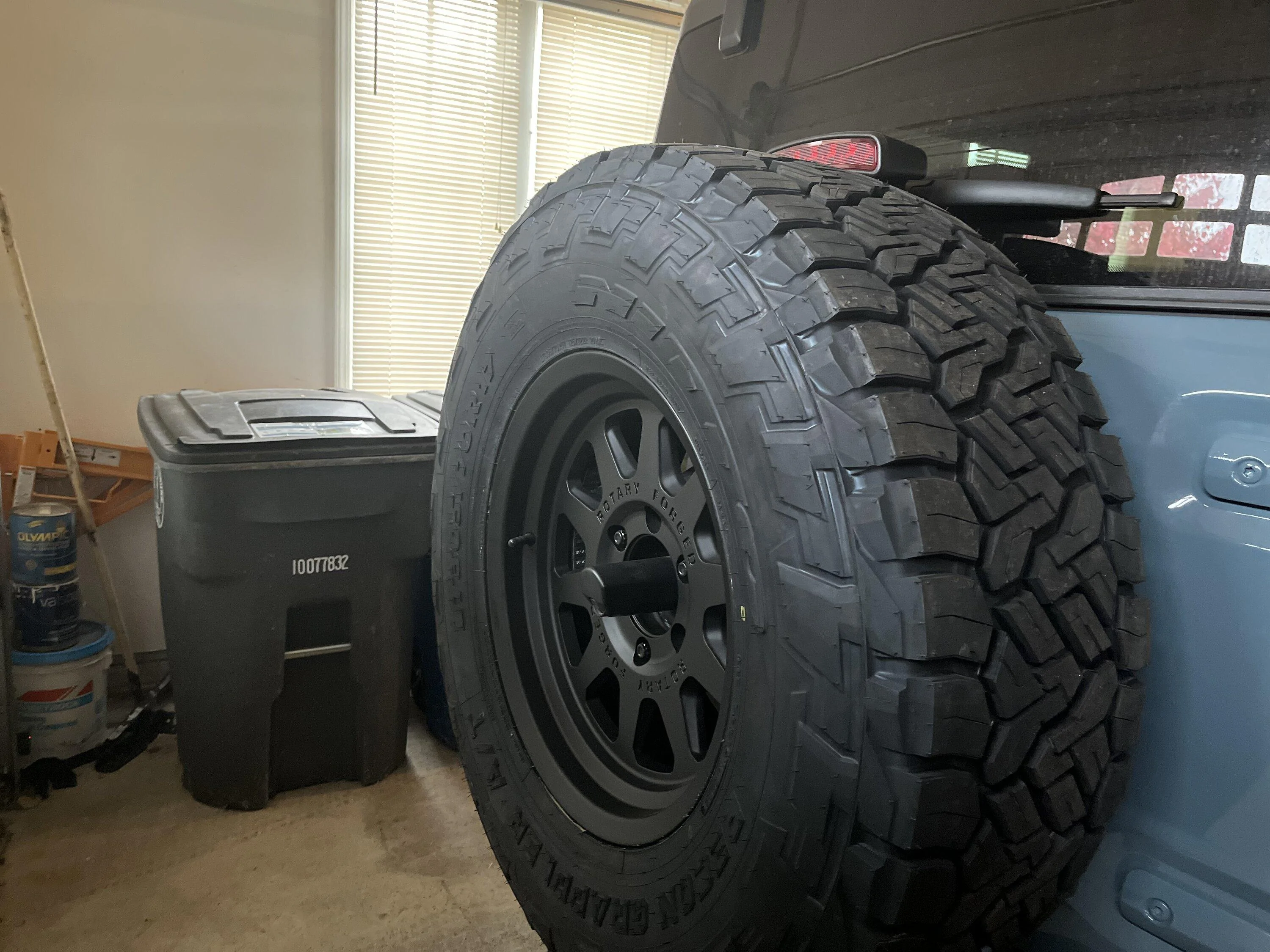

I focused heavily on weight and that’s why i roll these Titan7’s. I only gained 15lbs per wheel going to real 37’s. Could have been more like 30lbs if I stayed factory or went with heavy wheels. Factory set up was 92lbs, now at 107. Photo pre-lift.
What offset are those? Can you get us some poke pics?

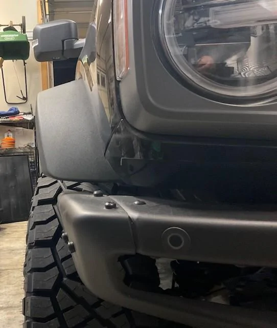

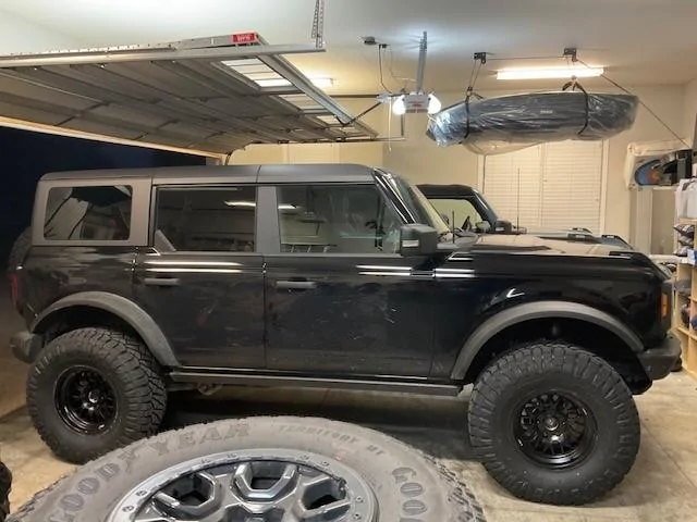

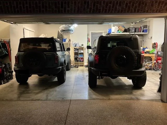

I'll get some more poke picks today, but -8 seems to be about right on the end of the fender flare. I have to realign the rear end as the trackbar adjustment seems off. Again, -8 (so not positive, but close) 17" Titan7's. 37's. Icon lift with A-arms and a new track bar. Had to cut the front-rear crash bar off to fit. The second Bronco is a regular SAS for size reference.

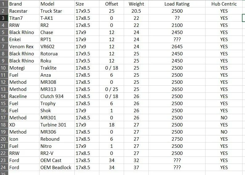

Here are some possible options. This is from the FRF Raptor forum. Not all of these are available in the Bronco lug pattern.
