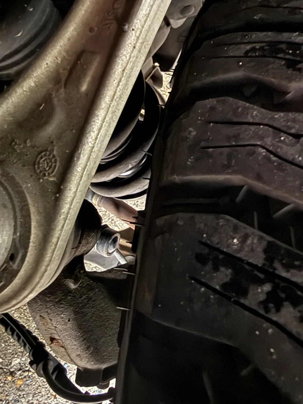

You can try and report back, but I feel like you might contact the UCA with +55. You might also want to really do a good flex/turn test and see if you contact the wheel well liner with that amount of life. I'm guessing you're non-SAS, so it's possible you'll be real close at 1.5" and not sure how much clearance you need for those times you hit hard.
I will take a look and see how much wiggle room I have with the UCA's with the 285/70's. If it looks like I don't have much margin then it's 285/75's or 35mm offset wheels. I'm not worried about the wheel well line as I'm right around Sasquatch suspension height right now and can "easily" bump the suspension up by changing the circlips on the 5100's. ("Easily" in spend four to six hours doing so and then getting the alignment checked :ROFLMAO: ).

With the 280/70-17 MT's it looks like I have about 3/4" of clearance to the UCA at full lock. These have a section width of 11.6" The Falken Wildpeak RT's have a section width of 11.5" in 285/75 and 11.7" in 35 x 11.5 so I think either should clear with wiggle room. Thinking is not knowing 🙂. Camber goes more positive as the wheel travels upward, but only about 70% of that inward motion is inwards towards the clearance point. Measured rims are different, etc.
