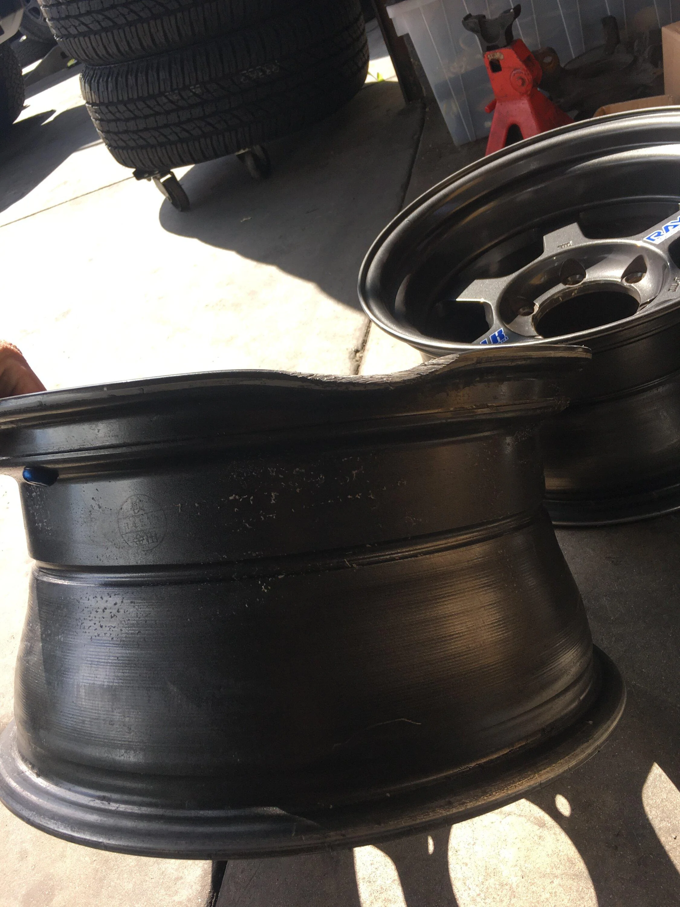

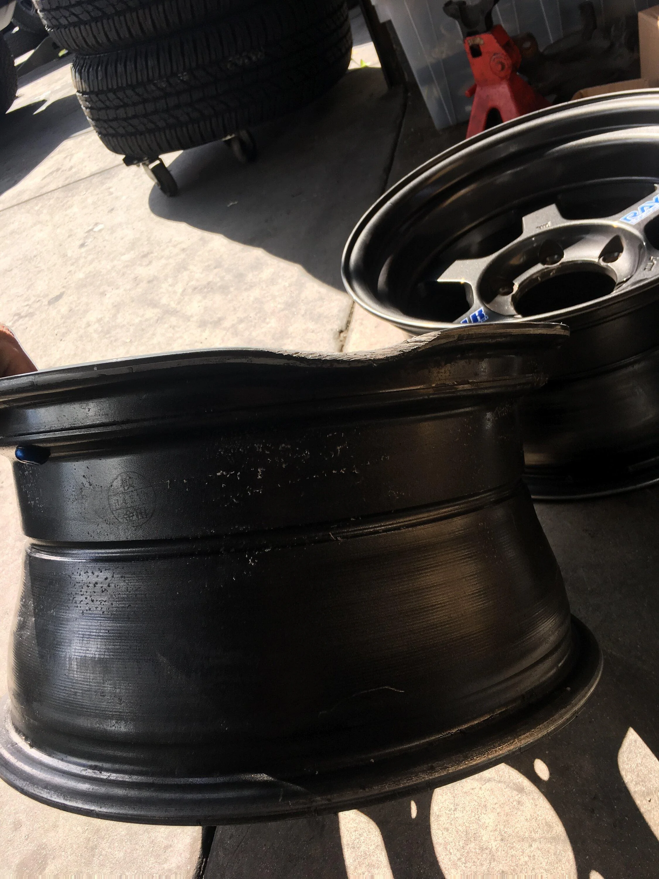

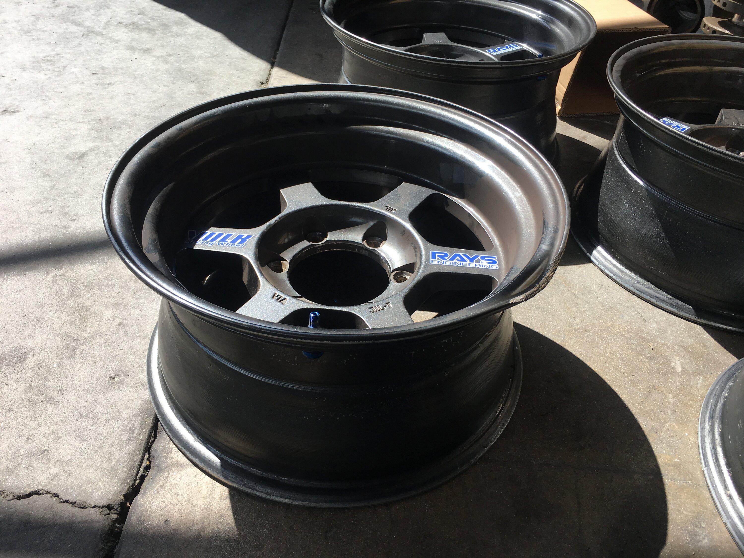

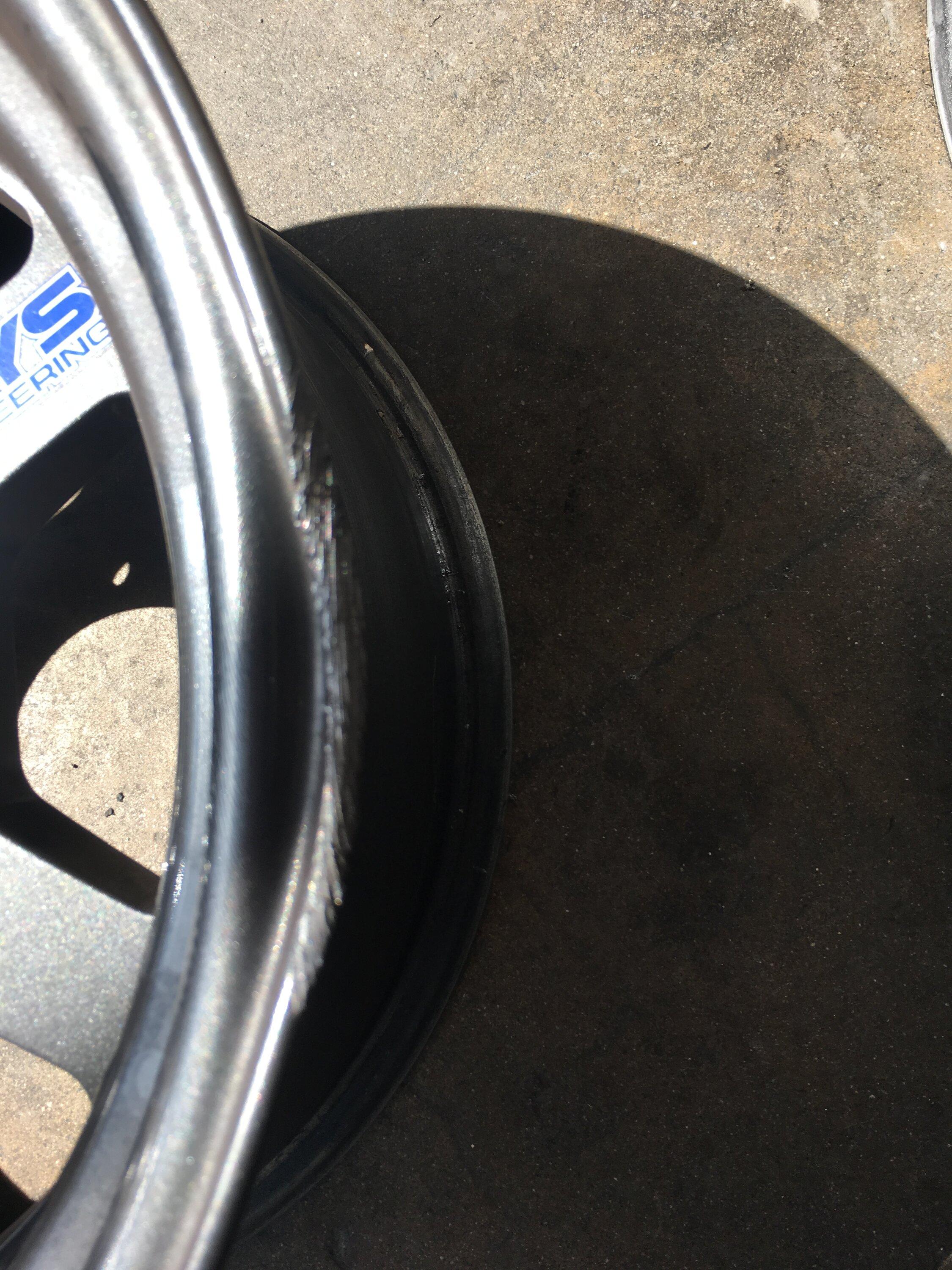

You mean like this? That was 40 mph into a curb jumping it and almost hitting a wall thanks to some punk kid on a cell phone. Let’s see your cast methods stand up to that impact. It still held air after the impact and I continued to drive home after with it like that. Even the finish didn’t chip off. So you get what you pay for with a forged wheel.

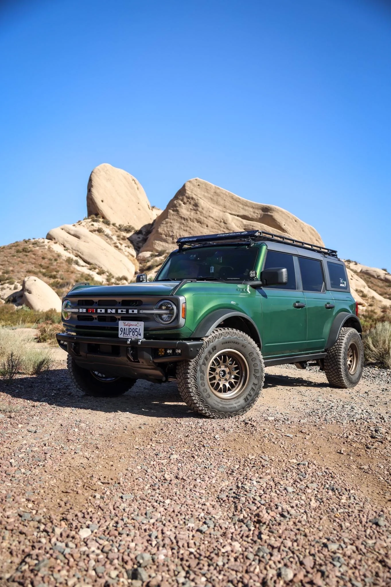

I focused heavily on weight and that’s why i roll these Titan7’s. I only gained 15lbs per wheel going to real 37’s. Could have been more like 30lbs if I stayed factory or went with heavy wheels. Factory set up was 92lbs, now at 107. Photo pre-lift.
